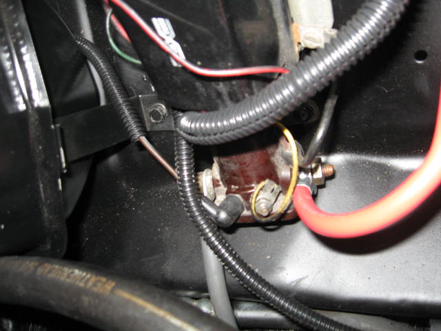

Guys;I am A little stumped here,I get 12.75volts at the + side of the coil and the same at the - side,(key on),power at the points(test light),12.75volts coming out of the coil wire to the distributor,but I lose the voltage out of the coil wire at the distributor when I “crank” the engine.the solenoid wire yellow is hooked to “I” the nueteral switch wire is hooked to “S” is that correct? Bad coil? I know it needs higher voltage during the cranking as the starter draws more,but does not after the start and gets lower voltage due to the resistor,the resistor is bypassed during cranking,I think after it starts it only needs around 8 volts,am I wrong?Just wondering if the solenoid is hooked up right,or if it is bad.Everything worked ok before the engine rebuild,and I have not had anything beyond the firewall apart(ignition wires /switch etc.)Does the engine need it’s own ground? All the grounds look ok.In short I know it is getting power to the points / battery to solenoid,key switch to coil,negative side to points and at points (no breaks in the wires)but I am loosing something when I crank it,any thoughts? Mark M

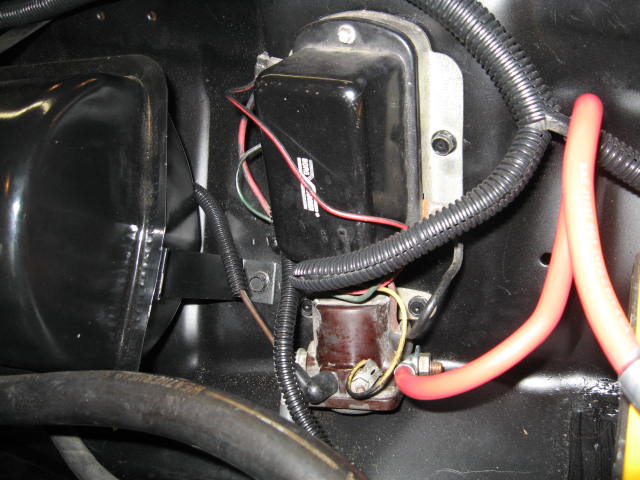

Guy’s I’ll correct myself,(negative) side of coil (the wire that goes to the points) I connect A volt meter turn the key to on and get over 12v,as I slowly keep turning to crank position I lose the power to “0”.Then I disconnected the nueteral switch wire,put A meter on it and at the same point I lost over 12v at the negative side at the coil I got over 12v from the wire that connects to the nueteral switch.The car does not crank over when the nueteral switch wire is disconnected.I have an additional ground cable I put from the frame to the block(ground and cleaned the connection and have good metal to metal).Is the nueteral switch bad? How does it work with only 1 wire (hot when cranking) going to it,the solenoid might be bad? I also have A good ground body to frame.
P.S.The wire in the picture with the rubber boot at the left side terminal is the one going to the nueteral switch,the yellow bare one on the right goes to the key switch
Mark, You are wired correctly from what you have written. The negative side of the coil reads zero if the points are closed and full supply voltage when points open. The coil fires when the points open, with a good capacitor, Coil charges with points closed. You can fire the coil yourself as a test, when the negative side of the coil has full supply voltage, just momentarly ‘Just a fraction of a second’ ground it and the coil will fire when you remove the ground.. Be carefull it can lite you up and a fire as well! Coils do go bad, usually damage, but very rarely. P.S. I am a front yard mechanic, being my back yard is car storage garage.
