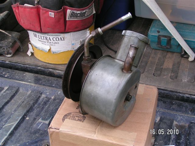

I could not tell where it leaks from…hopefully it is only a seal issue. The bottom of it looks like it has been brazed in a spot.
Roger - Most likely the only seal that will have to be replaced is the large O ring that seals the oil reservoir can to the pump which is easy to do yourself and save some money. Keep us posted.

It did seem to me that it was leaking around the large flange.
I will post a photo of it later today. :confused:

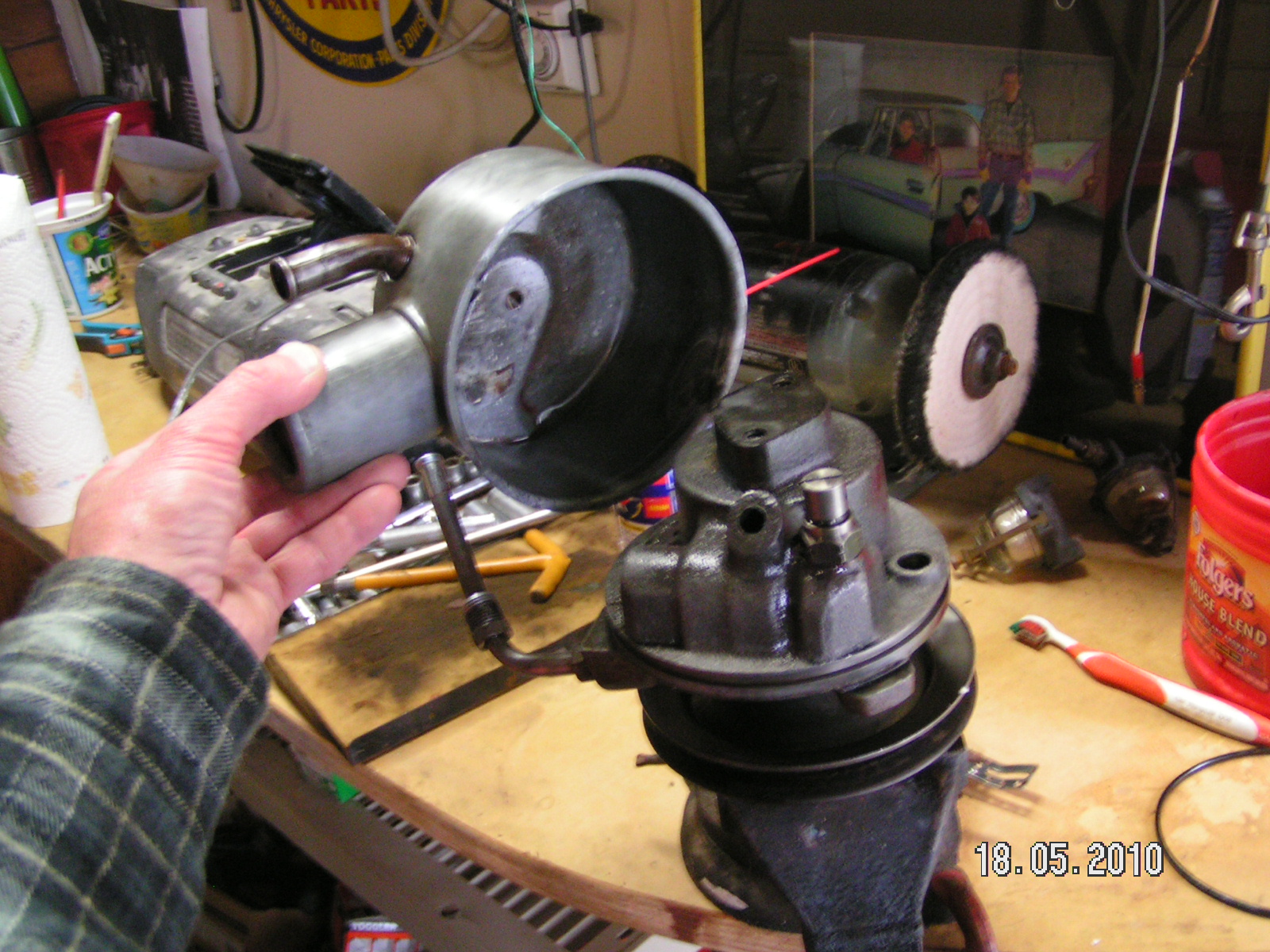

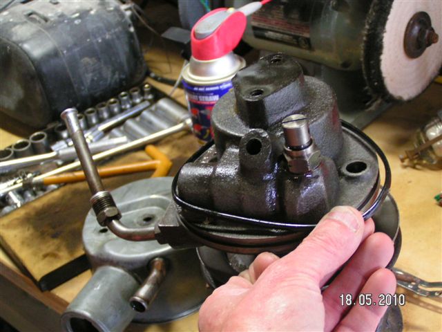

It looks like the can (“reservoir”) comes off the back, exposing a large “O” ring which is probably the culprit. I will post whatever I learn as I go.
Hi Roger - Yes, you have to take the bolt off the backside and then use a plastic or rubber head hammer and tap the can around the edge where it goes on pump. It should move easily, then you can replace the O ring seal.

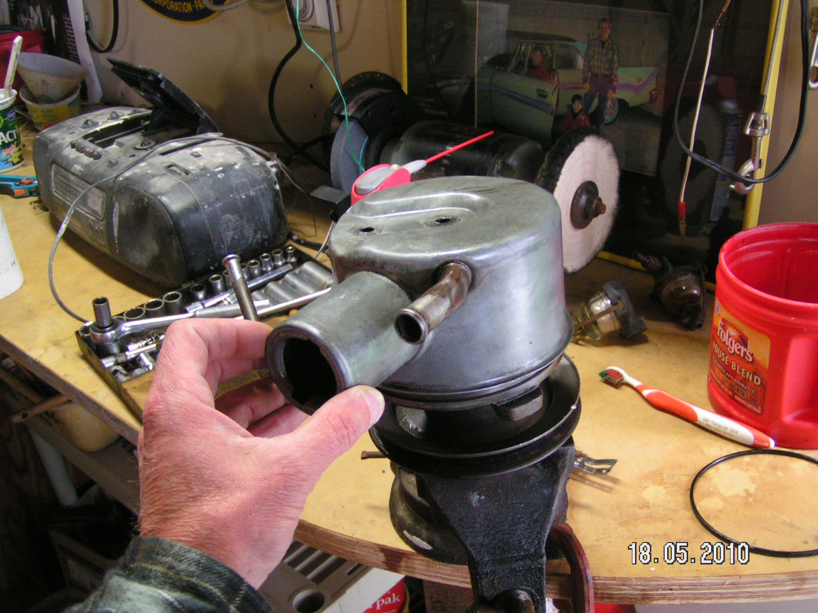

Last night I put the pump in a vise, as per directions, removed the bolt and, using a screwdriver and a lot of patience, worked that cover off. It took maybe twenty minutes of going around and around, carefully prying, finally with one big pry, the cover came off. The big “O” ring looks okay to me, but when the new one arrives, hopfully its’ installation will solve the leak problem.
(More pix from Roger…)
Of course I forgot to make note of the orientation of the “can” (reservoir) before I removed it…there are no tabs or markers to follow. I will use my photos for reference, or maybe refer to the shop manual.
Reading more in the Shop Manual, it directs me to align the reservoir cover so that " teh indentation on back will mate with angular boss on suction end cap".
I don’t know what the heck that means, but reading further, all I need to do is align the bolt holes on the back…isince t’s the only way it will bolt together.
