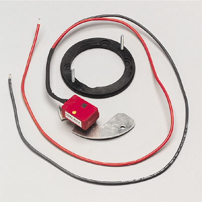

Thanks for all the replies so far on this issue guys, i have dried the drizzling water thing down the carb, nothing came out the tailpipe and no improvement was noted,i have been told by guys i know around here that it likely is a problem with my distributor, i am thinking of trying petronix to see if that solves the problem, im still thinking that it could be a vacuum advance problem because the car starts fine, runs smooth as silk until it reaches 55-60 miles an hour, then the pinging begins :confused:
