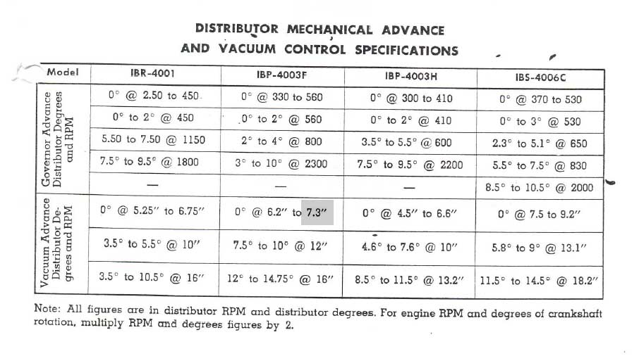

Stefan and I have been corresponding about vacuum advance too – and he has a question from the book that I can’t answer. Can you? I’ve attached a chart of specifications, and I highlighted one entry as an example:
zero degrees @ 6.2" to 7.3"
I presume the measurement is in inches. Inches of what?! Please help us solve the mystery…
Thanks
P.S. don’t forget to click on the pic to see it full size
On page 327 of the 58 Plymouth Shop Manual, there is a small highlighted box which reads as follows:
Important
Before testing, be sure diaphram will hold vacuum.
Connect to vacuum pump on tester and set to give between 10 and 20 inches of vacuum.
Shut off pump. If gauge reading fails, it indicates leak in vacuum chamber and must be corrected.
On page 330 of same book, there is a chart on vacuum control specs.
The lower chart states “…inches of mercury..” I recall using such equipment back in high school in the '70’s. It ressembled a blood pressure meter…basically a glass column filled with mercury.
Since the average person doesnt have one at home, I suggested taking the distributor to a reputable rebuilding service. All those vintage Ferraris had distributors…!
by the way, sorry for being slow to reply..the computer wasnt working and i tried to fix it 5X. I had to wait for my wife to return from her business trip. She fixed it in 5 minutes.
Well Roger, that’s quite an information. I’ll complete my book with this information. Anyhow I guess it’s cheaper to buy a new one. Besides I’ve sent an e-mail to your private address. If you don’t receive it, please let me know here.
