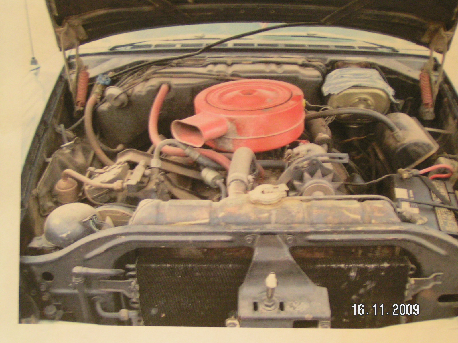

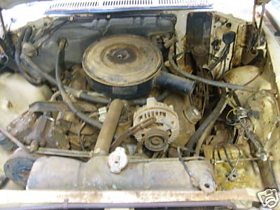

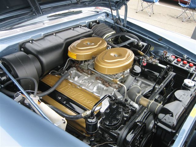

Here is a picture I took off the computer last year. The set up of compressor looks just like yours, John. This is a 59 Plymouth, but I don’t recall which engine it was, or if they specified.
(Sorry, I cant figure out how to scan and then post a pic) :blush:
here is a picture of a picture…
:confused:
This appears to be a 318. I will keep looking for 361’s with a/c

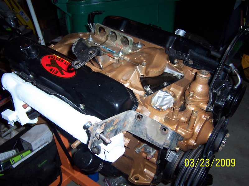

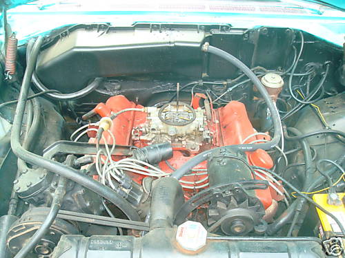

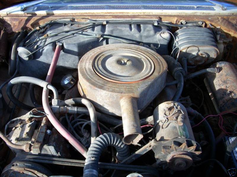

Here is a picure of my 1960 413 after rebuilding and putting all the brackets back on. I had not painted the AC brackets at this time. but you can see that the AC would be kicked over ot the passenger side of the motor and the Generator/Alternator location is above the Power Steering pump location. I ahve not put on the dual belt tension idler yet either.
My 69 charger (440 ci) and 70 cuda (340 ci) have the AC (RV2) compressor located in the middle by the water pump area as most people would put it.
I can only surmise that maybe it was a dealer add on location, That would have meant more brackets to put it in the outer area and move more components around, but this may have happened. Or maybe a mid year produciton change. Though since my more is a 60 casting and 60 model year, would this had happened in 1960 instead of 59? It took a lot of sawzall work to cut off my exhaust maniforld end to allow the AC mouting way out to the passenger side.
What does everyone think? Both methods are acceptable I guess? Though I am not building a concurs correct car. I want it to be acceptable to the casual Mopar observer…But what is casual anymore…

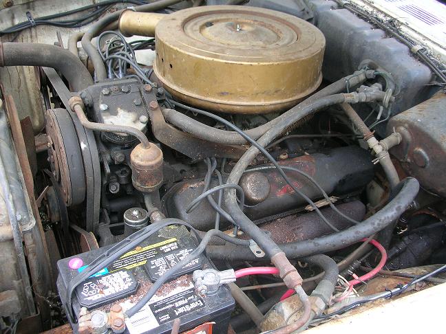

I am finding out there is may different ways to mount an AC compressor. One of the pictures shows the Air Cleaner with a shaved facing on it. I thought for an AC compressor, but in this case it is for a long barrel generator mounted above the Power steering pump.
My 60 413 Chrysler motor with AC all the way on the passenger side
