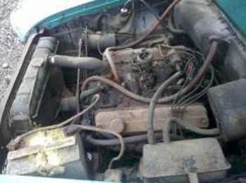

I was hoping I could get some help with starting my '59 Suburban. It has been setting for about 18 months without being started. I installed a battery,added Marvel Mystery Oil & tried to start it. The dash lights come on when I turn the ignition, but there is no click or anything from the starter. I jumped a wire from the positive battery post to the starter side of the solenoid. It started to turn over. So I replaced the starter solenoid & still the same thing… nothing.

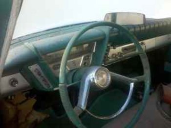

Yeah Roger, living in the country, I unfortunately know the damage field mice can do. These wires look ok, except the yellow wire at the back of the switch looks like it may be partially broken. Do you guys have an easy way of removing the ignition switch, so I can repair a wire ? There is no room to reach it from behind. Thanks.
If you can unscrew the outer chrome bezel ring that holds the ingition switch to the dash frame, you can then pull it (ignition cylinder) back away from the rear of the dash frame a little to see what wire needs to be spliced/repaired.
The wiring length of the original harness does not give you to much wiggle room to do this. If the dash is installed in the car then this will require some upside down time on your back.
Make sure the battery is disconnected too! There are 4 terminals with multiple wires going to each post, so it is very busy back there…Try not to dislodge to many of the other wires since they would be brittle too!
