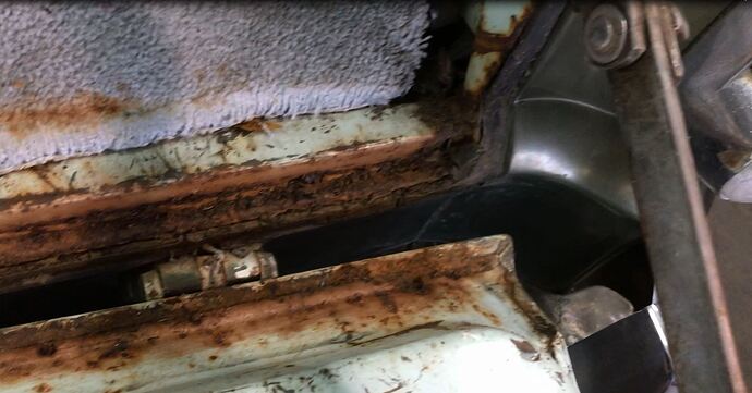

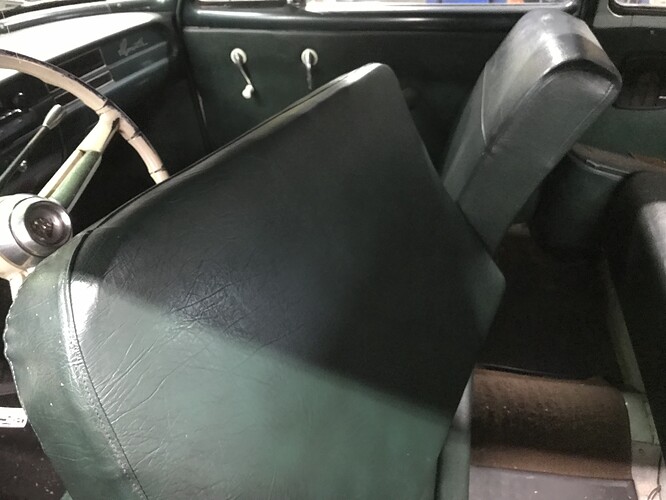

All the rubber grommets around the windows are in excellent condition, but the tailgate seals need replacing, as well as door whiskers. There’s a “sag” issue with the driver’s door, and some rust issues in the passenger rocker and the tailgate. But nothing that can’t be addressed over time. And the heavy duty vinyl upholstery is in awesome condition! Now to get the brakes fixed, and to get her running again (probably, I need to drop the tank, flush and coat). Another elephant to nibble on.
The tailgate looks worse than it actually is. There’s no rust-through - some power brushing, ospho, and rustproofing will set her straight

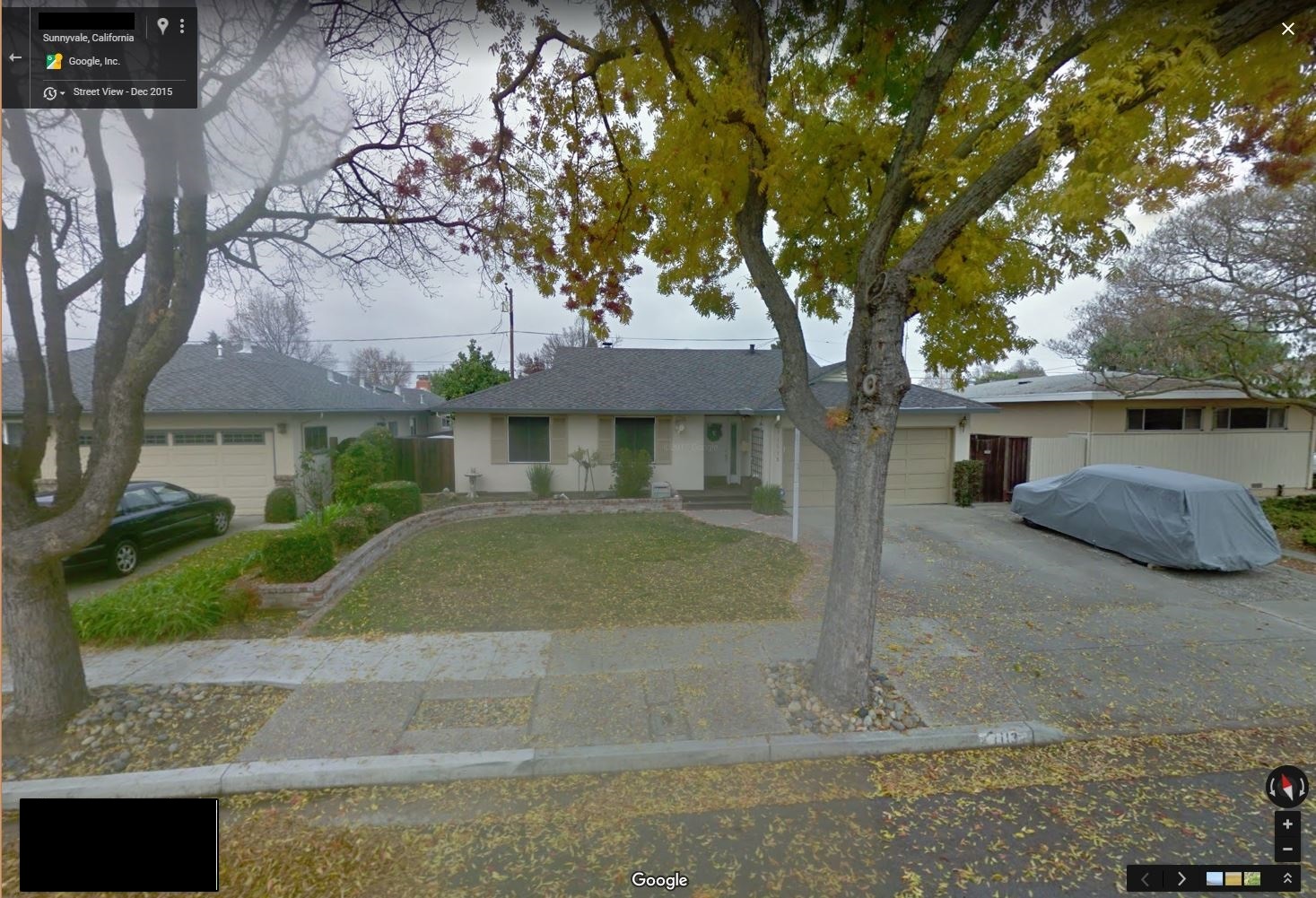

From the CA “Ownership Certificate” (title), I tracked down the previous owner to the seller. I found an email for him - here’s our exchange:
I also went to Google Maps with his address - and there’s Martha!

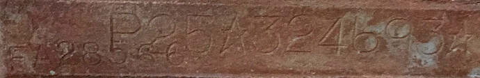

I had a bit of a scare with Martha, as John Fowlie, Ray Ward and a couple of other folks know. I compared the VIN on the A pillar to the VIN on the title, and they didn’t match! Same number of digits - the first two, middle two and last two match, but another digit was transposed, and one differed. Oh no! I went back to the seller, but he’s gone incommunicado… John mentioned that Ray knew of a way to get a “lost” title through the state of Vermont, and Ray provided a couple of YouTube links. I was prepared to go that route, and then I had an e-conversation with Christopher Housecat Neapolitan, who once owned a '53 Plymouth.
He told me that Chrysler titled cars from the factory with the block number!!
VIN on A pillar
block number
So Martha’s street legal. Now, to figure out which number PA wants to use. As Chris pointed out, people swap blocks all the time - I’m lucky that Martha has the original block.
And speaking of which, she’s firing up now. Drexel Auto told me there’s sludge in the tank, so I have to drop it and get it reconditioned. They blew out the line and cleaned the filter, and the pump is fine - but the carburetor accelerator pump is shot, so I’ve ordered them a rebuild kit. But she’s running! She rolls now, too - the emergency brake was locked. They’ve got a new band, and a cable is on its way to replace the kinked one. And don’t you know, after a nearly three week vacation to California and back, the rest of my brake parts are scheduled to come home today. The drums on the car seem to be OK. With any luck, Martha will be parked in my driveway by the end of next week!
Oh - and that star symbol between the P25 (the model number for '54 Plymouths) and the remaining digits? According to Jim Benjaminson from the Plymouth Owner’s club, that means it’s a 230 and not a 218. Raw Plymouth power, doncha know!
P.S. - there’s an overstamp on the block in a smaller font, “FA28566”. Jim didn’t know what it was, he speculated that it might be a state number of some sort. Anyone have any ideas?

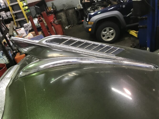

I scored this hood ornament from a guy on the Plymouth Owners Club who had it in a box of Dodge parts, and didn’t know what it was for… Fifty bucks, it’s near perfect.
