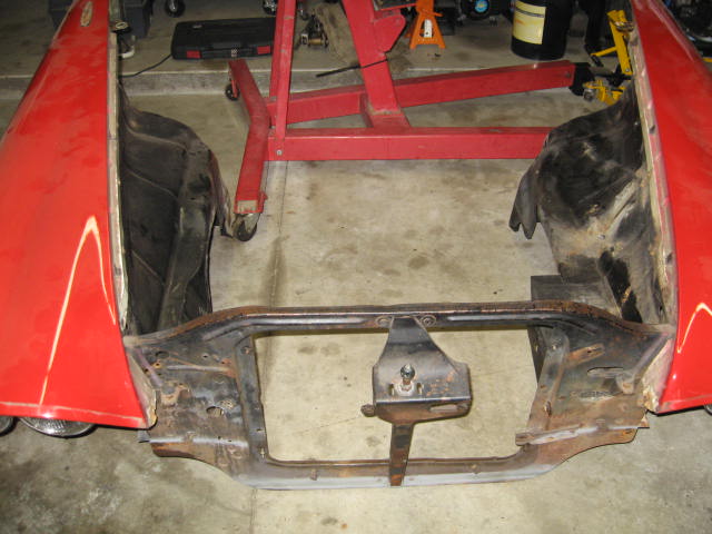

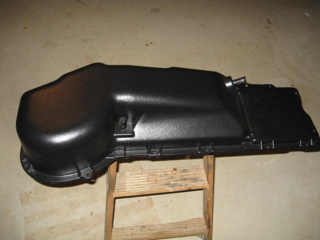

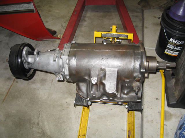

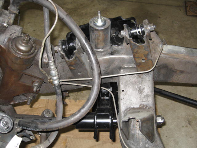

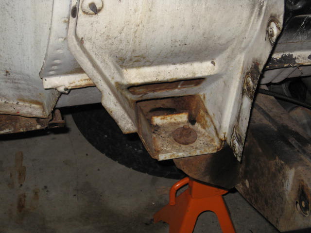

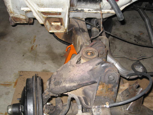

Just an update of what I have been up to,or underneath of,I decided to freshen up the fury.Got the tranny back,it had A complete rebuild including the torque converter.I have decided to leave it “natural”,and not paint it.Some of the assembley stamps and yellow paint marks are kind of cool.The 318 is almost done,it will be .030.over,my guy is doing the heads as I speak,hope to get it back in A couple of weeks. I am now doing the suspension,bushings,ball joints,etc.etc.The drivers side turned out good,I just started the pass. side. I took off the front clip and was surprised there is no rust,all hardware came off nicely.Am going to paint the engine area,and dress alot of the wiring.I have seen alot of the pics of some of the others projects and am amazed at the before and after results,you guys are “PLYMOUTH GODS”. The rest of the car may be done next year,I didnt want to bite off too much,just want to finnish what I started.Will stay in touch,it will keep me busy in Erie this winter!!! Mark

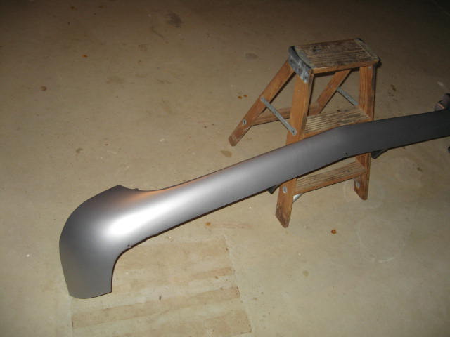

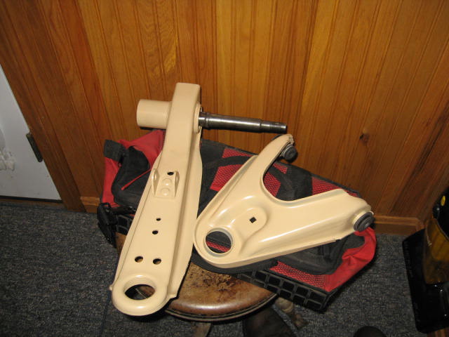

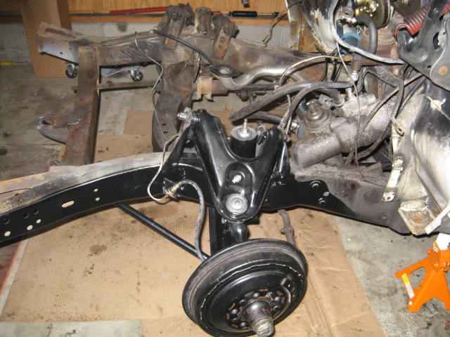

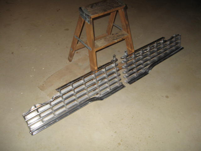

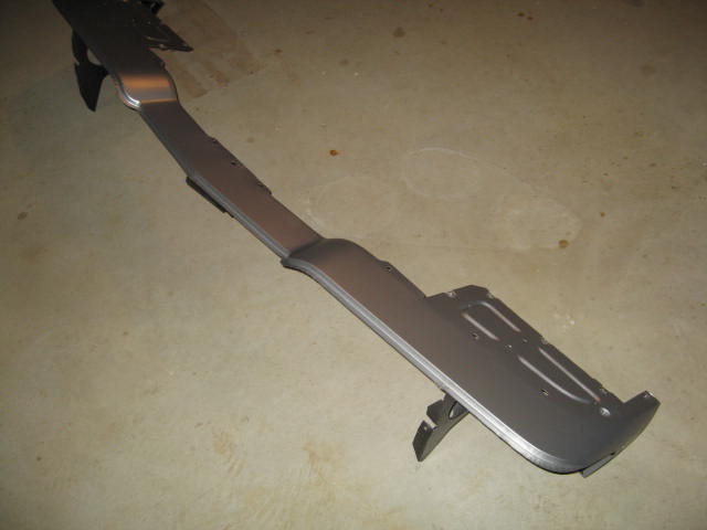

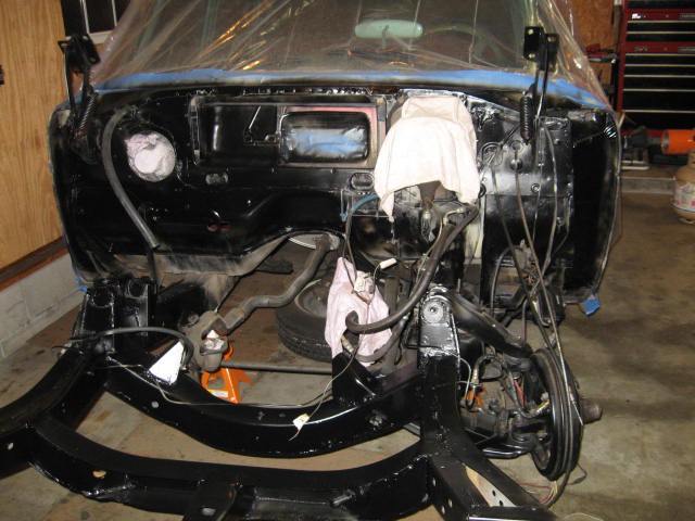

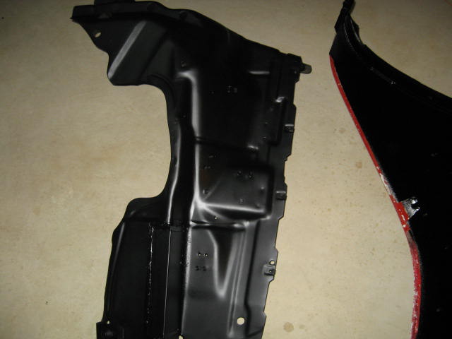

Got A little more done this weekend,got the stone guard and valance back.Spot welded the 2 brackets on the valance(bent and broke),painted argent,black on the inside.Buffed the grill(turned out bright and shiney,the pic does it no justice).Started to paint the engine bay,got the bushings pressed in for the other side/new ball joints.I had A big hole IN the heater core housing,the previus owner/owners had cut A large hole by the blower motor to acsess it,it had duct tape over it and looked like it was ther for 30yrs.Critters had A nest next to the vent door.everything has turned out very very nice,I should get the motor back fairly soon,the holidays slowed it but i’m not in A hurry for it anyway.The control arms are primed,I am going to paint them black next week and assemble them.When the motor comes back it is getting bolted to the tranny and going straight in,should be way easier than when it came out. Mark M
Damn Mark - Your work makes mine look second rate.
I am not worthy… I am not worthy… I am not worthy… Great Work!!!

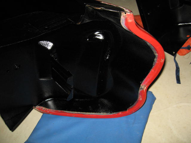

The car is in my garage,but the parts have gone to A young fellow (friend of my nephew) he works at A body shop during the week,and is allowed to to side jobs at the shop on week ends.He is about 26 or 27 and has gone through body shop schooling.He is very knowledgeable,fussy,and cheap!! I talked to him about doing the whole car at A later date,and he is very interested.I just gave him the inner fenders and the core support,probably hear back next weekend or two.It is good to see someone as motivated as he is,I give extra,I told him he don’t charge enough,he said $400.00 and i’m telling you all those parts were rough!! He enjoys that work and is very talented.I think he could easily have A future restoring antique cars,next time I see him i’m going to put A bug in his ear!!!
Looks great, Nice job on those parts!!

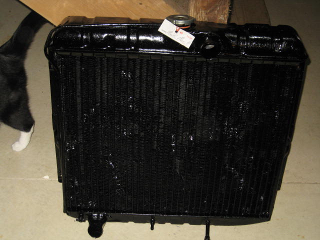

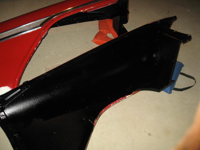

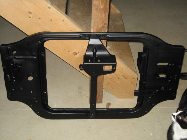

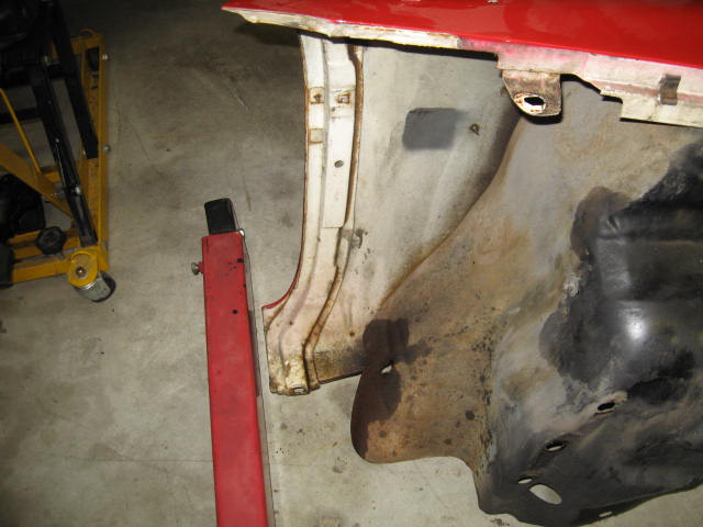

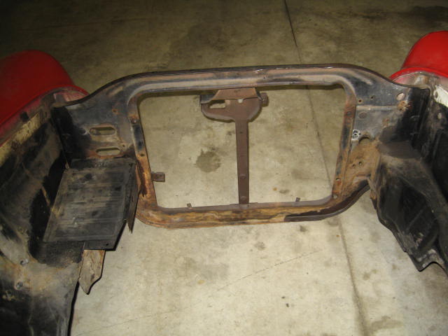

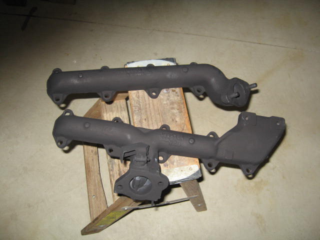

Not much happening,still waiting for the motor,I did get the front clip done.Core support,inner fenders,satin black.Also painted the outer skins,and had the battery box area repaired,it had some corrosion,must of had a battery leak at some point.Got the radiator flushed and checked for leaks(none),and primed and painted the exhaust manifolds with VHT high temp paint,took them to work and “cooked” them in the oven.Everything looks like new,all the hardware comes off easily because of the lack of rust.I am going to clean/replace all hardware.The inner tire area was done satin black but with A light “splatter” effect,turned out nice!! Got my core support rubber the other day,probably do the distributor next. Mark M

Roger; Some things are going to be my own idea,it is hard to stay with the factory,I have seen some differences depending what factory they where built,your right about the ivory.My biggest challenge is going to be the interior(probably next winter) the car exterior is going to be flame red/white,but I am not nuts about the factory interior color choices.The original interior is red/gray with gray headliner and gray window trim,I was thinking red/white inlay tuck and roll,light headliner(bone),black or red dash.Anyway that is down the road and i’ll look around and come up with something hopefully by then.Seems like the interior choices back then were very nuetral.All the pieces in the pics were shot or glass beaded they cleaned up wonderful. Thanks Mark M
