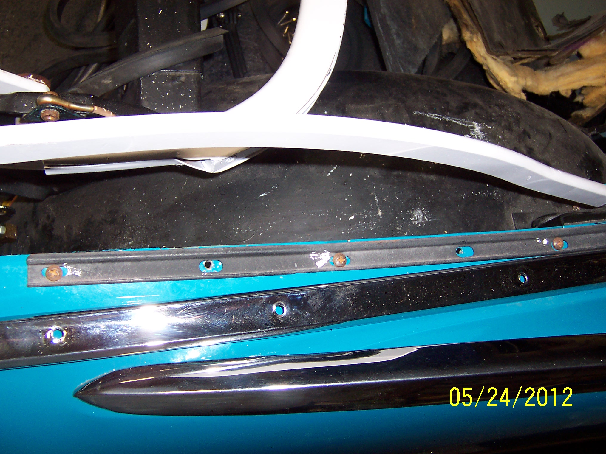

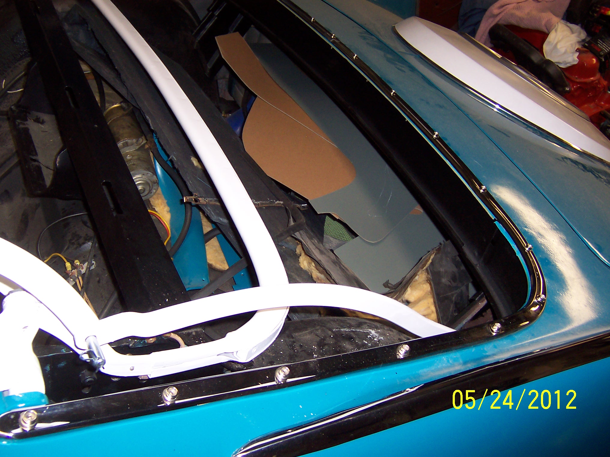

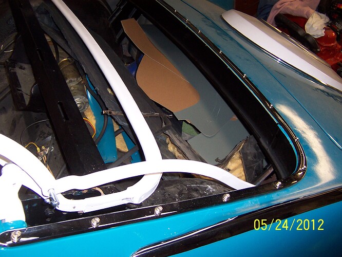

I will take a picture of mine to show what I am talking about. To figure out which elongated holes in the metal strip were to used for the metal strip to the body, I overlaid the stainless trim and saw which holes would be used but the boot strap and which holes can be used by the metal strips, I put a white out mark next to the holes that I could use with the metal strip. The other holes would be the pass thru for the SS boot snaps. I then could secure the metal strip to the body knowing that I did not use any of the holes that I would need for the SS boot trim.
Here is some pics of the metal strip on my convert. You can see my white out on the holes that only to be used for the metal strip. All others are for the boot snap screws thru the SS trim
Thanks for the photos, John.
Those will help a lot of us when it comes to reassembly.
