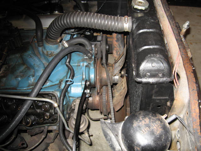

Does it look correct? It’s near the generator. Mark M.

Mark - I can’t see the bracket at all in your pictures, remember on the AC car both horns are mounted on one bracket inside the radiator mount on the passenger side, please send better pictures. Are you willing to trade, if so, I will need your address. Mine is Richard Koch, 4951 S. Kay St., Palm Beach Gardens, Fl. 33418.
DICK; Ill get back to you later with better details,pics. Mark M
