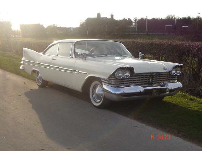

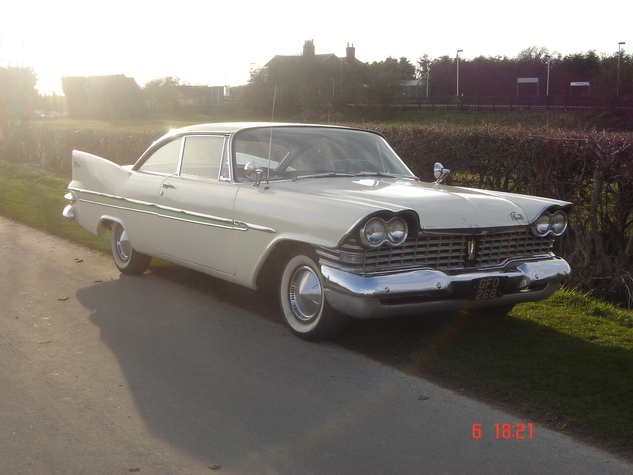

So, we’ve seen your Belvy on eBay – do you intend to keep it, then?

How areyou guys n the states? I am in the uk, i reckon theres only 3 or 4 about 4 2door ht in the uk cool eh?
Dan i am going to keep the old girl and fit a 440 in time, ilike the style not too keen on the polys performance though that said it really is great on fuel :sunglasses:
