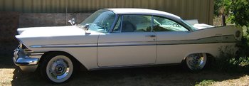

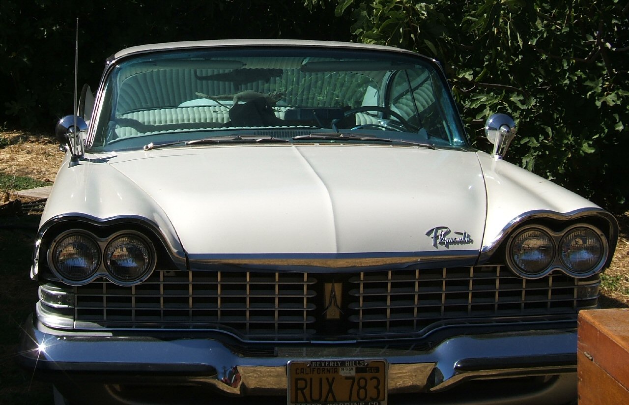

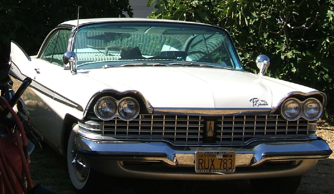

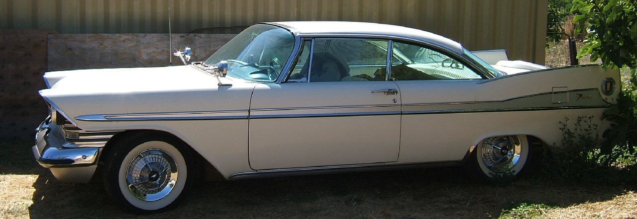

Attached a picture I took this afternoon…
WOW! I somehow missed your car back when you joined. You are still a student? You had a Sport Fury convertible at age 24, as a student?! I’d love to see more pictures of your car…is it in the Showcase section of this site? ( I will look now!)
