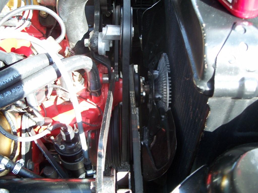

I am sending a picture of Frank Lamps 59 SF fan setup via the mailing list. I can’t figure out how to send attachment via the forum. He’s the new guy in the showcase. Maybe he can answer some questions
Here’s the picture for the people who are not on the mailing list.
that “finned” device ressembles a unit I removed from a '64 300 whatever it is…maybe I should try it out (if I can find it, if I still have it)
It would be worth a try if it would silence the fan noise. Does anyone know if I installed a 4 bladed fan on my 361 I would cause it to overheat? I have seen plenty of 4 blade fans on ebay.
Roger that “finned thing” is called a fan clutch, they operate either thermally or hydraucily. My question is how do you get that much clearance between the pully and radiator.
I saw a couple of those devices on ebay. I don’t think I have the clearance between the engine and the radiator to install one of those. I think they would solve the problem. How could you tell which one is right for a 59 plymouth?
I think either one would probably work OK, but I would opt for the Hydraulic one rather than having my engine get overly hot before the fan kicks in. But then again there may be some kind of adjustment. Probably an old timer at the local NAPA store has the answer???
