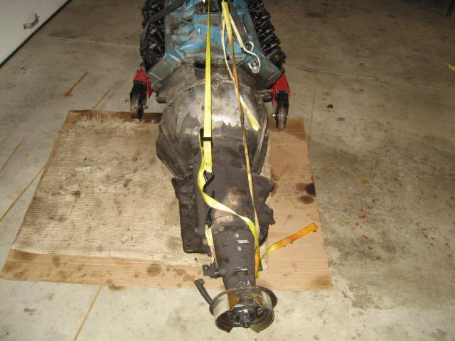

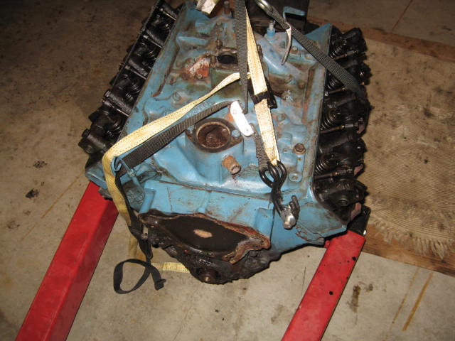

Roger; I’m going to paint the bellhousing with the engine,the torque converter will be on as will the housing.That is the way it;s going back in,the tranny will be waiting for it.The rebuild is a long way off,I have a very good builder[does alot of race engines] but mine is a stock build,was told it could be 2 or 3 months off.But that is ok,it is not going anywhere anyway,it will give me time to do the front end and various other issues.It keeps me busy over the long,long,long winter.I’m sending the tranny out next week but will get that back much sooner.Interior/paint etc might be a few years down the road,make it a driver first. THANKS MARK

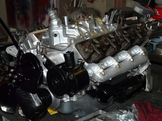

Thought I’d share this with the forum. My cry for help in a previous posting was referred to. This is as far as I’ve got. For info I’ve cleaned the transmission and bell housing and leaving them with the metal finish - no paint. My engine (318) started out blue, I’m pleased with the result so far. Valve covers not yet fitted but are the same silver as the sump. Guy

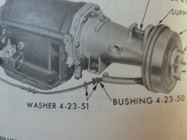

Wow!! Looks great!!! I can see what mine will look like.Is the oil pan and valve covers the silver argent? I have alot of the engine area cleaned up and am going to paint that as well [black] after I re-do the suspension and steering components.I was also going to leave the tranny as is,got it all cleaned up and is getting rebuilt,has the usual,bad bands,clutches,shaft o rings[petrified].Thanks for the pic!!! p.s. I am still confused about a possible missing part that I think goes into the e-brake cable entrance, I was cleaning it up and a small tubular piece of rubber came out. THANKS MARK
