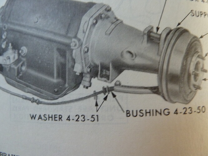

Hello; I would like to know if I’am missing A cable adjustment part,the shop manual shows A bushing at the cable entance to the tubular guide.It calls it part# 1406 964,but that is as much as I know. The cable shield has a nut and a lock nut[secondary],problem is the threaded sheild moves freely when inside the tubular guide even whith the entrance bolt/nut drawn together.I have pics to show the e-brake assembley.The cable seems way too long and is adjusted all the way to the end,and I have about Afoot of pull at the e-brake handle and the brake won’t hold.I have installed new shoes,adjusted the shoes to just kiss the drum.Also does anyone know where I can get an adjustment cover that goes on the back side of the e-brake backing plate[held with 2 screws].Thanks Mark P.S.I pulled the motor and tranny for a rebuild.

I went to storage and got my Book out. Here is a (blurry) photograph.
