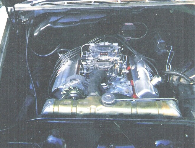

The original oval air cleaners are bringing in BIG BUCKS now. Here’s a picture of what I’m using and they fit my budget MUCH better (about 30 bucks). Ron
Okay, guess I don’t have a picture showing the air cleaners yet. Will post later. Ron
