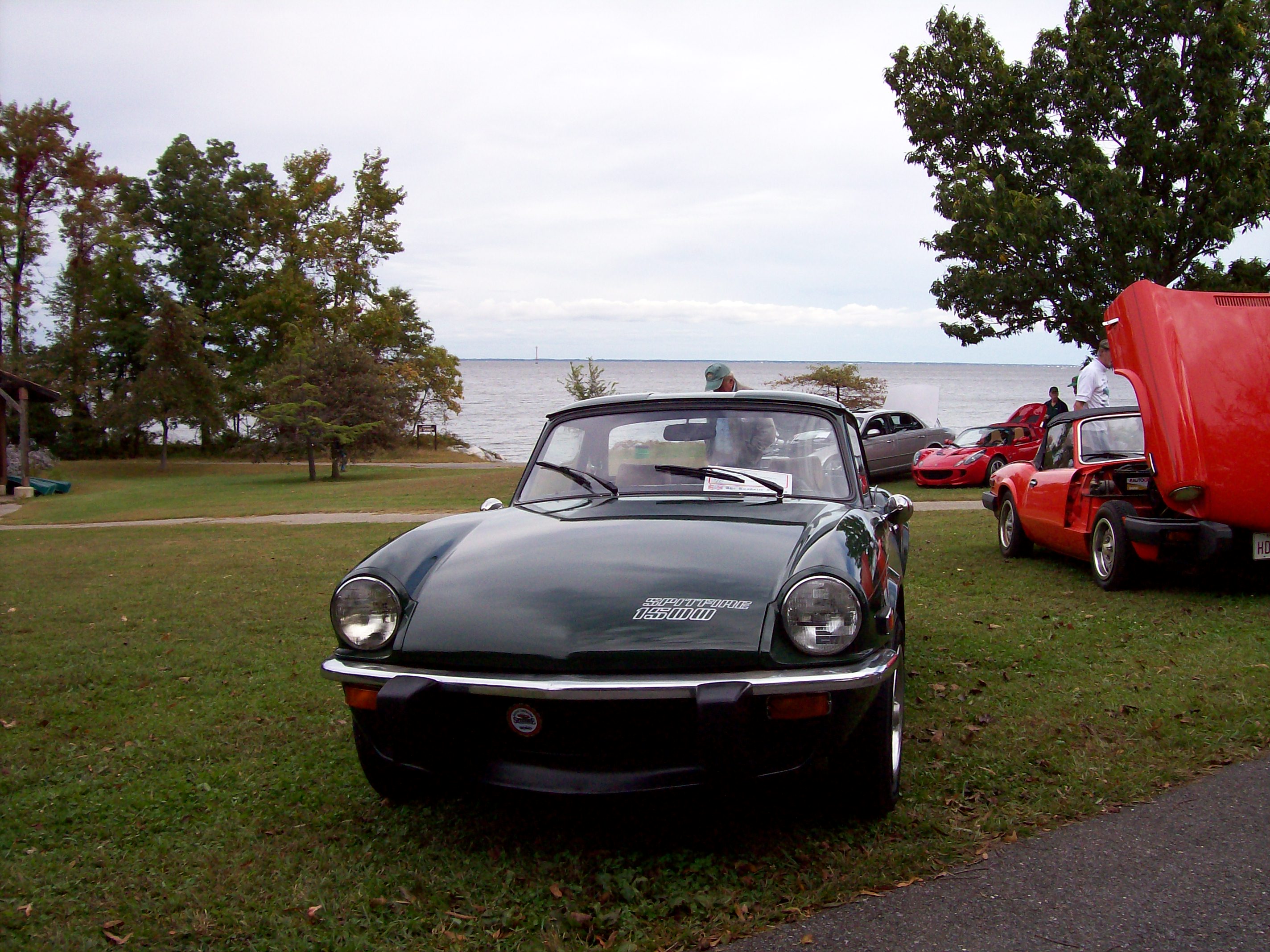

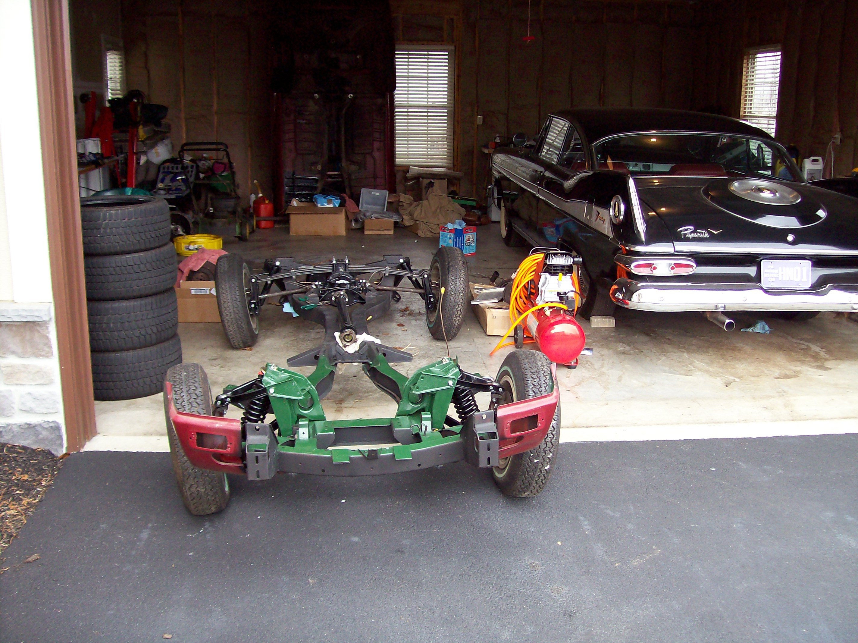

Yep, I took a 1978 Triumph Spitfire apart , it took me 2.5 yrs to get it together, including painting it my self. This car was very easy to do, the electrical system was a little challenging, but it works and it runs great, little leaky with the fluids. I looked over that shop manual every chance I had to and looked at parts books to see the exploded views which gave me the better idea of how it went together. Here is a picture of the finished product.
Finished
begining
