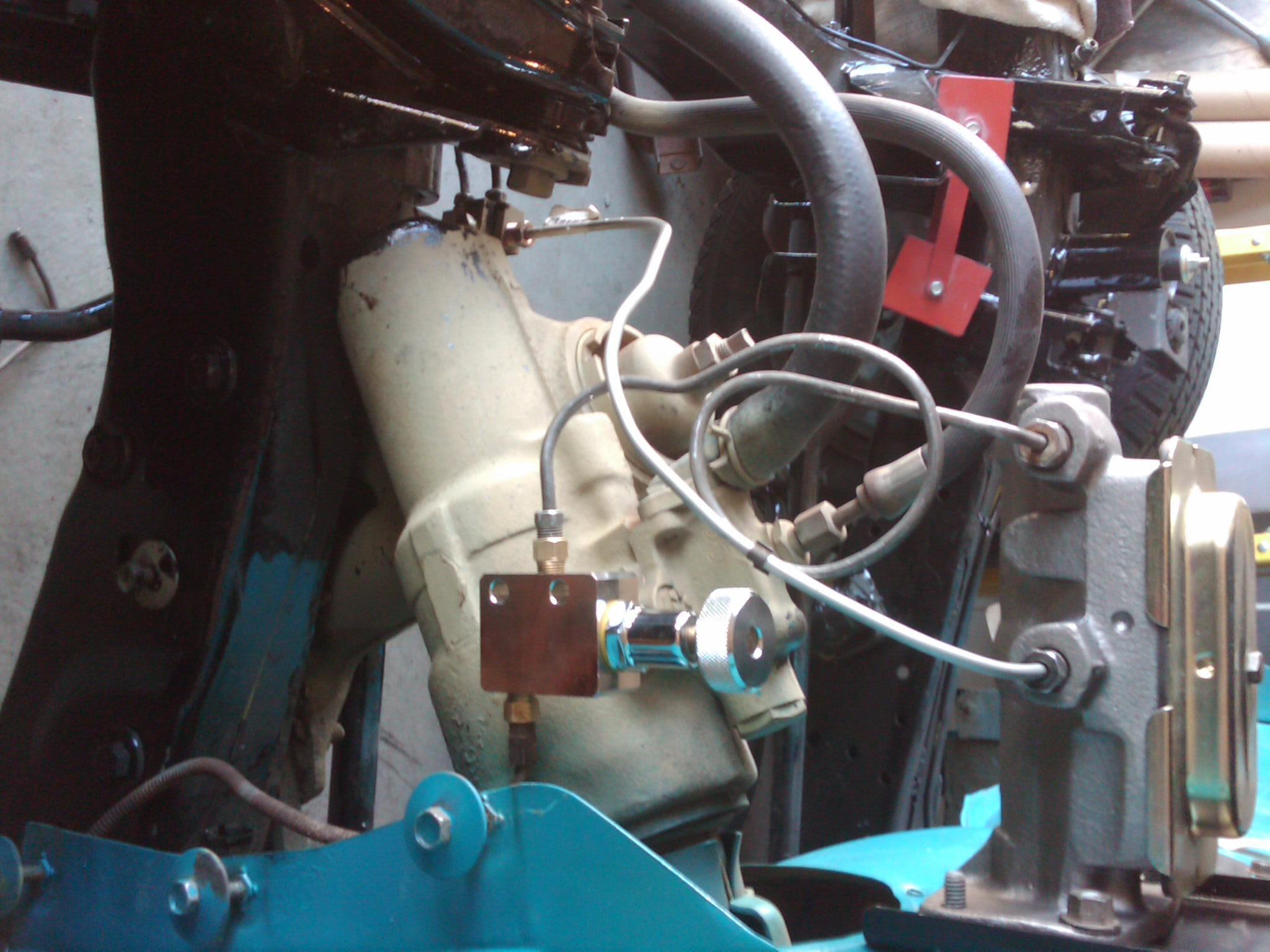

Dick,I used a manual proportioning device on my convert for the rear brakes with disc up front. Used the original Brake T but put a plug in the one orifice I did not need. Sorry the picture is sideways.. [Fixed it! Ed.]
Still have to dial in the Braking ratio after a few hard brakings to see if the front or the rears lock up first.
