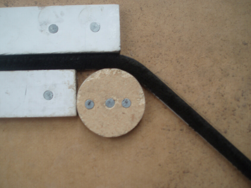

The trick is to make sure the surfaces align as much as possible – the belt weatherstripping can have some bends in it, so you want to lay it on a flat surface and work it until it lies flat. Same for when you stand it vertically – else, it will deviate in height along its length after glued on.

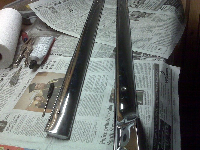

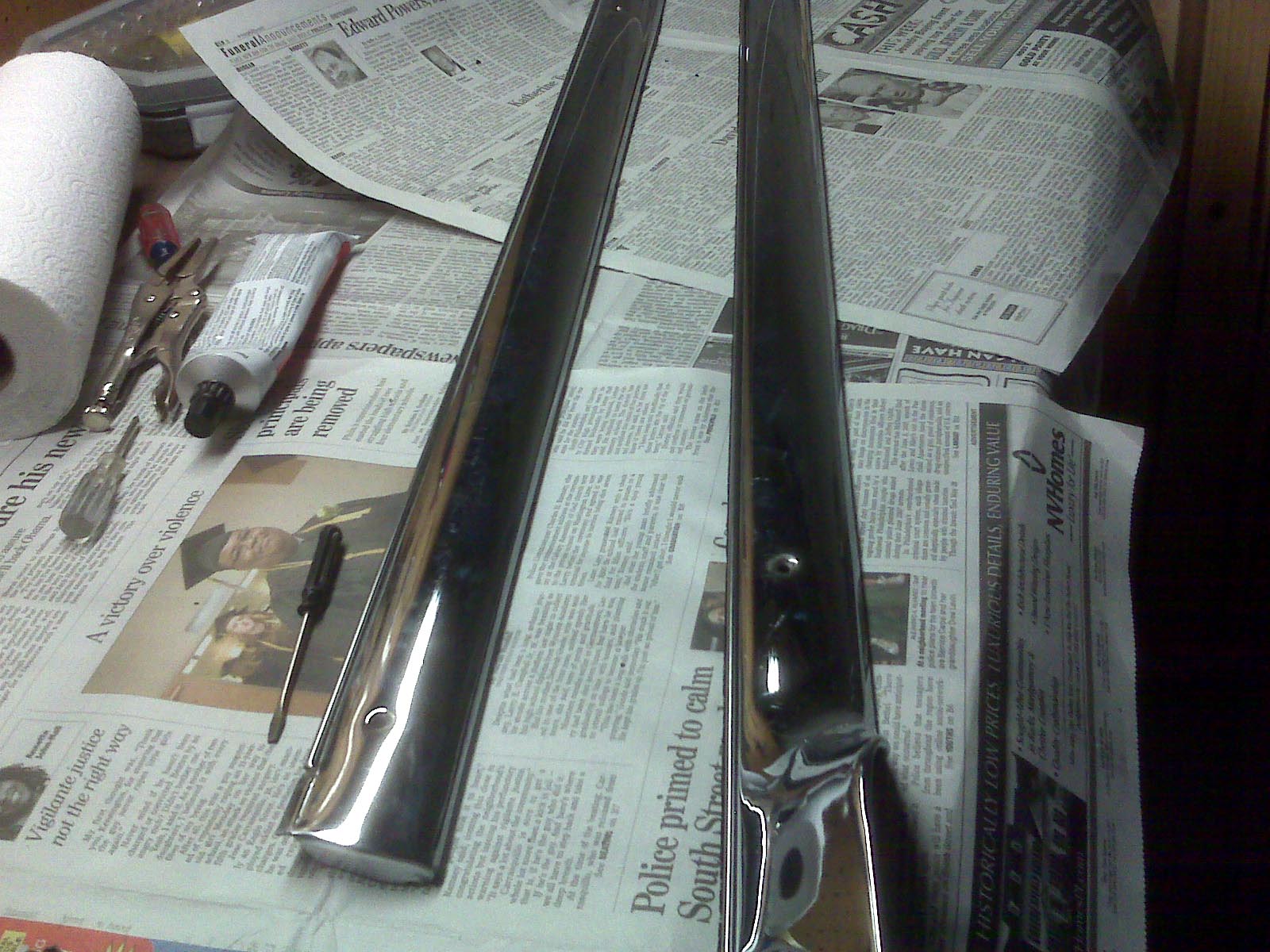

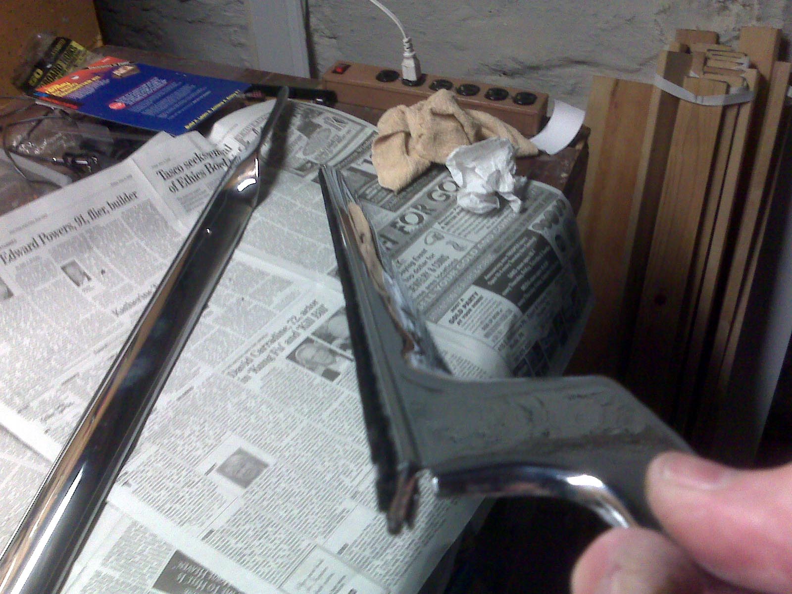

Sorry about the picture quality – cheesy BlackBerry builtin camera
Before I put the inner chrome moldings in the back on, it occurred to me I should replace the outer belt weatherstripping – there will be more room for the glass to flop around, and make room for dropping the strip into the channel before snapping it in.

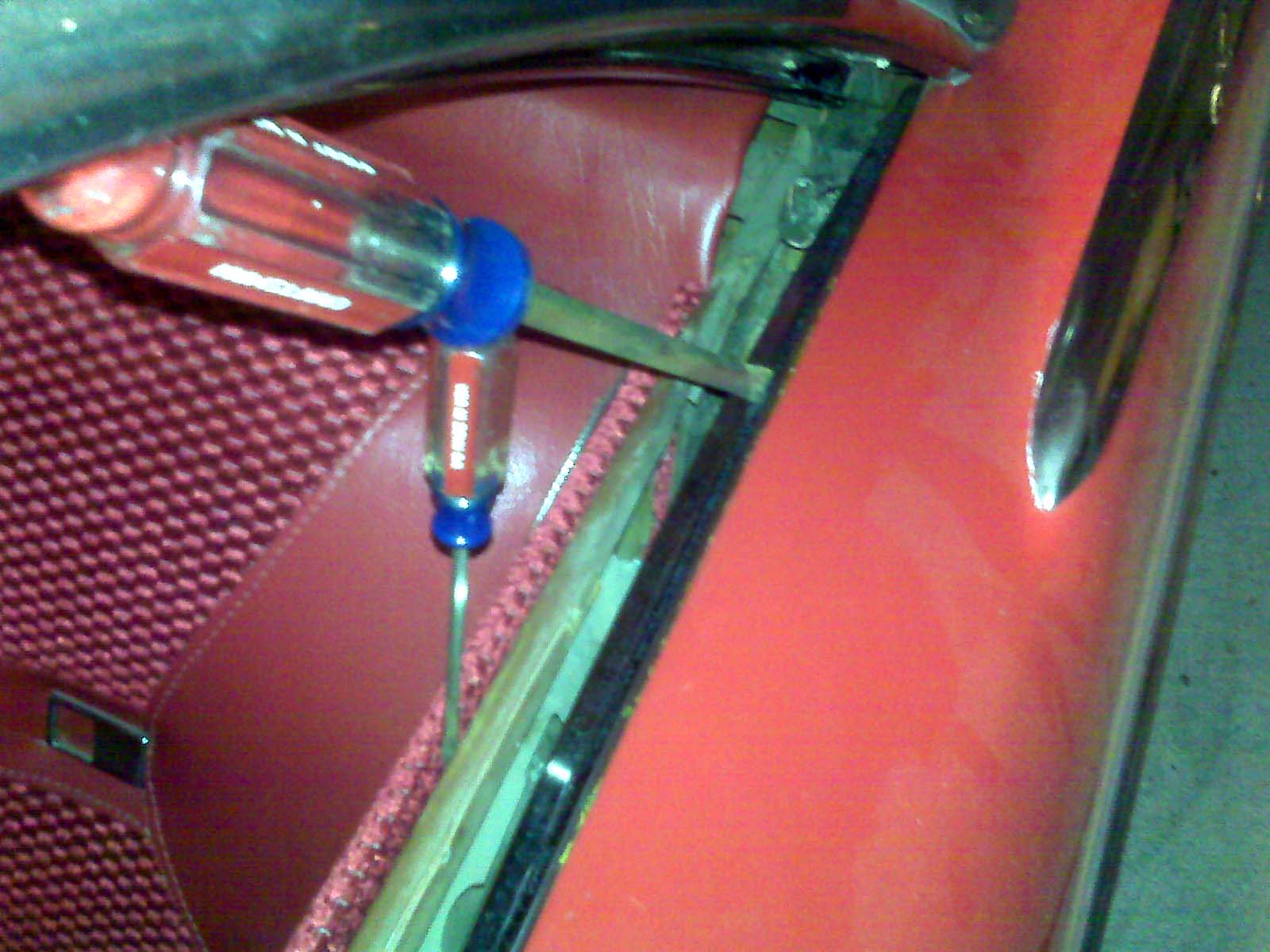

Well, “snap” is what I got towards the front of the strip; towards the back, it was less of a done deal. The belt did not hug the channel as it should (on both sides). It wasn’t going to drop – the clips do that much – but it’s got a less than finished look. Should I risk popping the front out (and perhaps weaken the strip)?
I know what I’ll do! The patented Curt Lambdin (®) weatherstrip technique!
I globbed some onto a piece of cardboard, then dabbed it on the weatherstrip pried away from the channel, using a small screwdriver. The neat thing is you can control how much you get on, by pulling the blob along – it stretches and thins out. I got minimal extrusion, and now I’ve wedged some screwdrivers between the weatherstrip and the window to keep the pressure on. It seems to be working…
This stuff is great. And it makes a great dessert topping, too! :laughing:
P.S. yes, Matthew, the car really is that dusty… needs a bath!

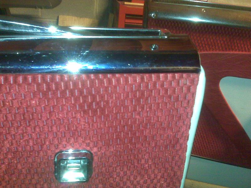

Well, that worked like a champ. And while I was at it, I fixed a nagging problem with the back seat panel – I never could get it to stay under the chrome molding. It kept coming out, and then the backing board would get bent by someone getting into the car; it’s even cracked (although, invisibly behind the material). It seems the guy who first did the interior, had the welt too long – and there were so many folds in the welt fabric, and the panel fabric itself, that the chrome molding didn’t have a chance to eclipse all of it. So I peeled back the cover, snipped the welt, took a nip and tuck here…
Voila! Nice and neat.

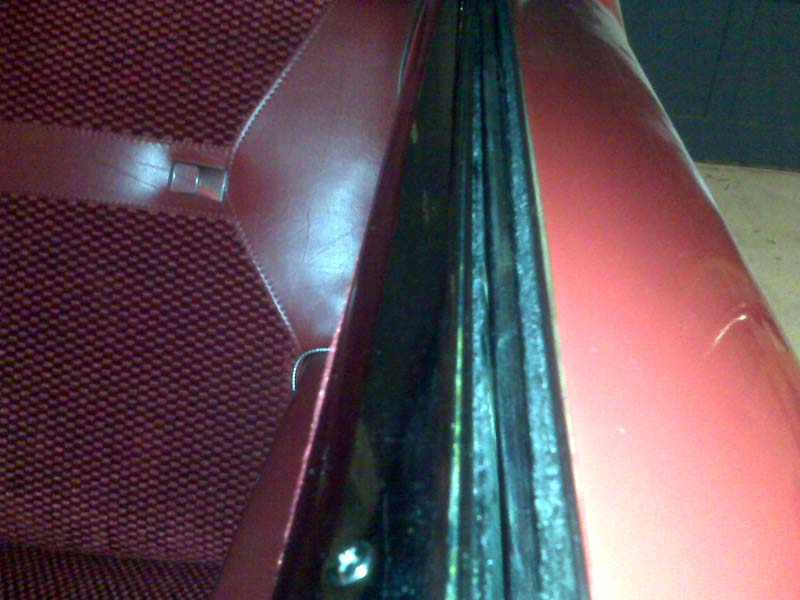

Sorry 'bout the pix quality – the Blackberry fits nice in my pocket. Here’s a shot of the glass coming up through the whiskers – nice and snug!

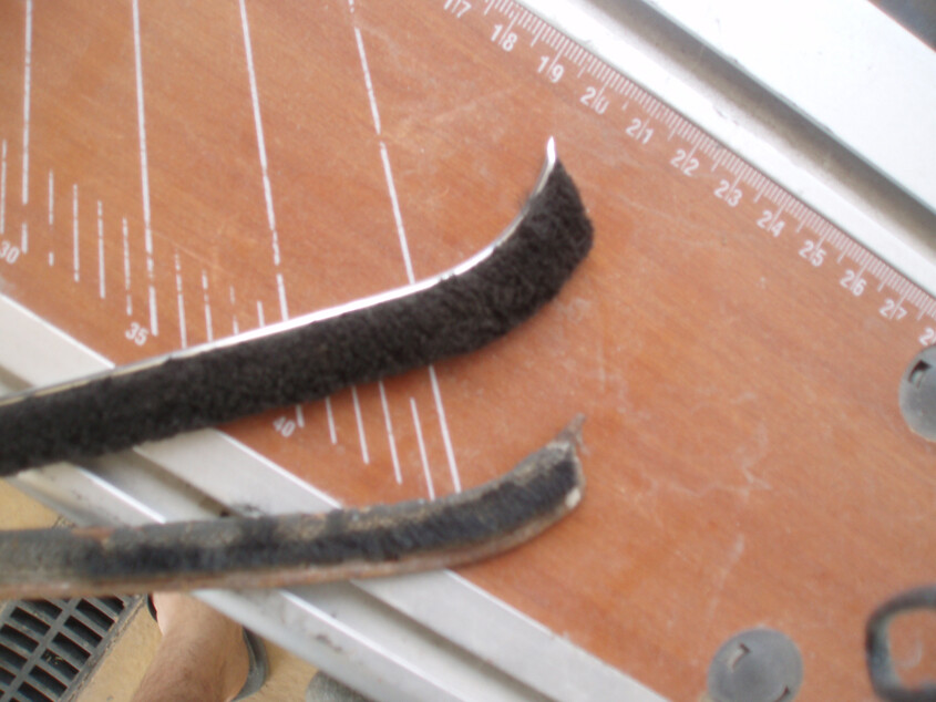

I used Pop rivets for what we call in Australia “window felts”.
These have the chrome edge stripping and black furry felts that contacts the glass.
These are off the 57’s Sedan and attach to the window frame. Coupes would obviously be different.
the rivets are not seen as the furry part was slightly cut away so the head of the rivet would sink into the metal
backing and not scrape the glass. after they wear painted black they are impossable to find.
I had to use a long 1/8" drill bit to clear the inner door frame edge but it will work. I used a normal rivet gun and it fit no problem.
