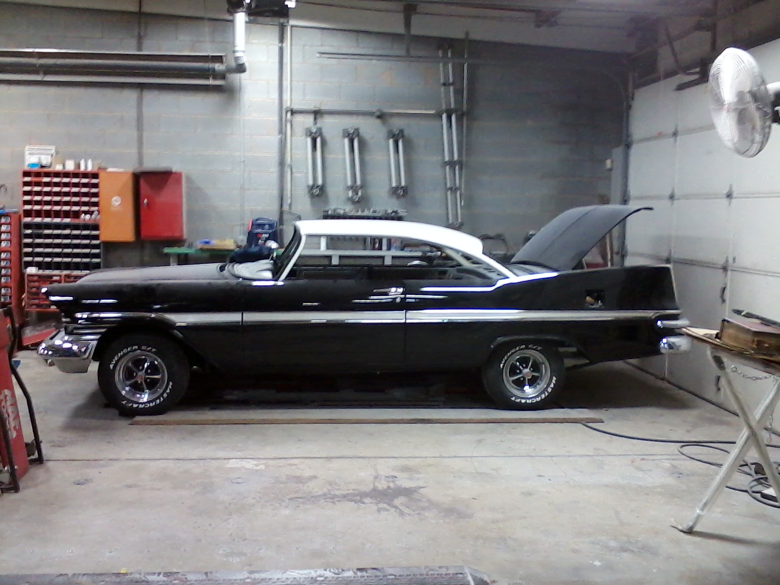

I’m in the process of getting my 59 Fury back on the road. I swapped the 318 and cast iron Torqueflite for a 68 383 and '63 vintage 727. I’ve switched over to a '65 Mopar alternator and correct regulator, along with adding A/C. I want to keep my generator warning lamp if possible.I did a search on this site and others, but can[t find any reference as to how to wire the circuit and keep the warning light. If someone has done this type of Mopar generator to alternator swap on a 59 Mopar, I could use some help with a wiring diagram. Thanks for your help. Dennis (Here’s the Fury as of Feb. 17, 2015.)

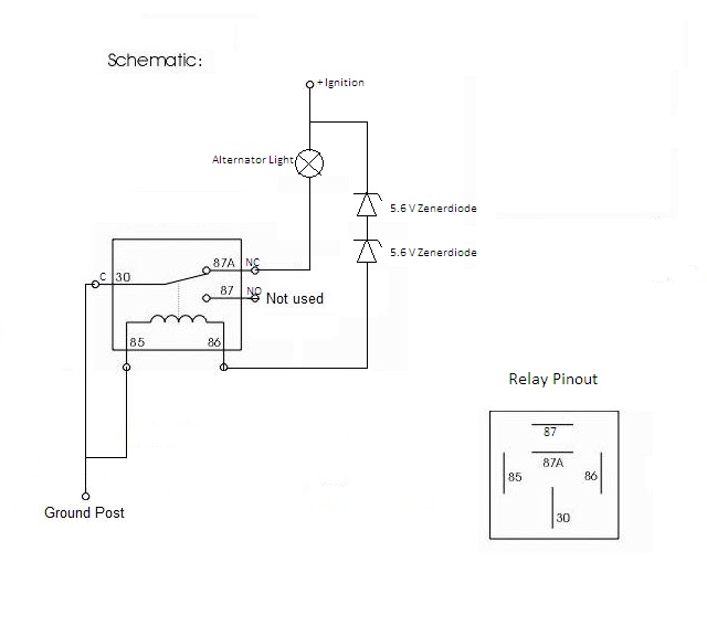

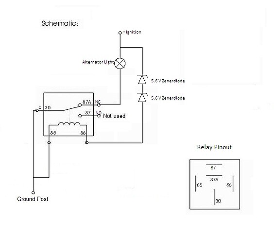

This is great! Is it possible that you might post a sketch of the wiring diagram that shows how you did all of this? Thanks!! Dennis
Hi Dennis.
-I’ve tried to make a sketch for you…-please see attached picture..
-Instead of the “trial&error” procedure, you could also take the specific relay, and test the cutin/cutout voltages, by using a adjustable power supply…
-this way it is also easier to bend the “NC” (87A) terminal, so a “hysteresis” (difference between the cutin and the cutout voltages) is obtained…
-It might sound a little confusing, but the bottom line is, that we want a relay that cuts in at around 14V, and cuts out again at around 12 V…-which gives us a hysteresis of around 2 V…, so bend the NC terminal (if needed..) untill a difference in cut in and cut out is around 2 V.
Once this is done, then read the voltage at cut in…e.g. : 4 V
-We want the relay to cut in at 14 V, so by simple math we have to “subtract” 10 V…-so a 10 V Zener should be used for this relay…
-Good luck :slight_smile:
Regards, Stig Hansen,Denmark
