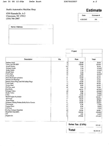

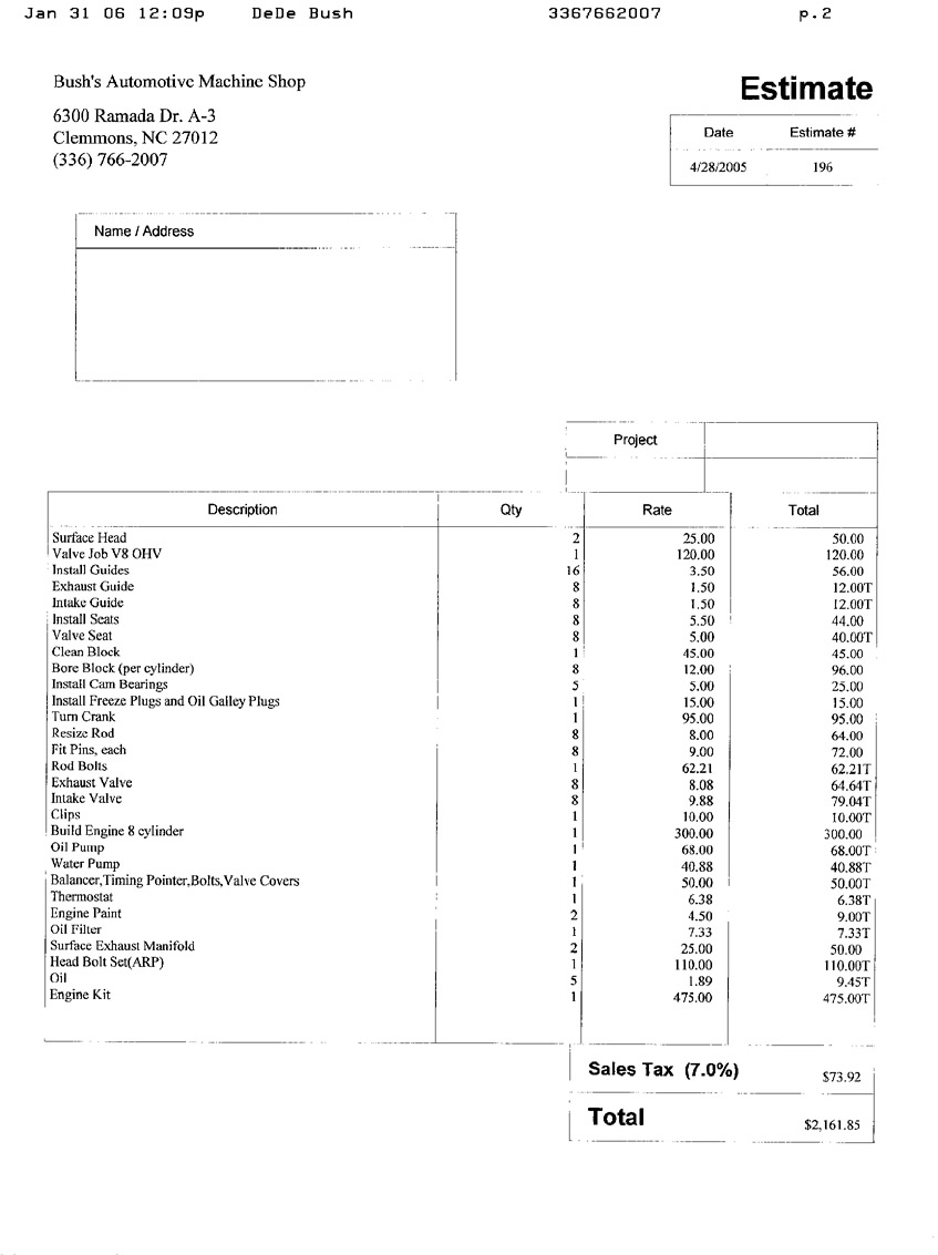

Well, I followed Roger’s advice and asked for an invoice – it’s attached. (Click on it to read it.) Pretty comprehensive rebuild, it looks to me. Answers to some of the questions Ed Eckerson suggested I ask:
rear main seal - neoprene
overbore - .030"
cam/crank - .010"/.010" (it’s the factory cam, solid lifters)
stock oil pump
According to Kevin Bush (the owner of the machine shop), the guy who had him rebuild the motor reneged on the deal, and now he just wants to get it out of his shop. It’s never been started.
So, what do folks think? Should I go for it?
never heard of “resizing the rod” :confused: . but the prices he listed look fair. i would definately go for it! i don’t think u could build one urself for under $1,000. if u bid, i hope u win it!–jeremy
Sounds good Dan, also the price is fair, as Roger mentioned. Yet the engine has never been started and you have no garanty that it will. I guess it´s up to you again. :confused:
