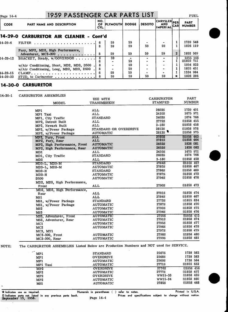

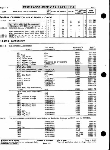

Tom Fox sent Ed Eckerson a scan of a page from his parts book, and Ed sent me a photocopy. I checked my parts book, which I purchased from Myles Walker (the one who restored Tom Gerrard’s SF, with 2x4 carbs) – lo and behold, I have the same page! Perhaps, Forward Look Frank – this is the same page that Myles showed you to prove his case.
What this page shows is that, as of 9/15/58, 2 air cleaners were an option on some '59 models – and that there were forward and rear carburetors. Were these ever installed at the factory, or were they ever only parts available for dealers? At any rate, does this settle the question – that 2x4’s were an option on '59 Plymouths?
To my mind, all this proves is the parts were made available which fit the 59 Plymouth. This information does not state, nor prove that '59 Plymouths came out of the factory with 2x4s. Hence, 2x4 Plymouths should not be called factory-equipped.

I have a 361 in my 1959 SP convert and it only has one 4 barrel carb on it. The engine has never been rebuilt that I know of. I also have the 1959 Plymouth service manual suppliment and it has a picture of a Golden Commando in it, and it shows only one carb
Part no. AFB-2856S (B).
But I do believe that 2 carbs were an option 59 on the 361, and from what can tell from the manual the Part no. would of been AFB-2812S (A) That is the Superpack option on the 318 in 1959. I would assume the 361 carb would have been to big to make dual and probably went to the 318 superpack carbs.

Goald thinks 2x4s were available for 361 and thinks the 2812S were the carbs used. The parts book tells us that 2812S was the superpak carb for 318. I cannot lay my hands on my parts book, but seems to me 361 used a different 4bbl carb. As for 2x4 on 361’s, it has been discussed previously, and my opinion on the matter should be clear!
ahah, I found my 59 Supplement…it lists the Carter 2856S as the 4bbl carb for the 361.
