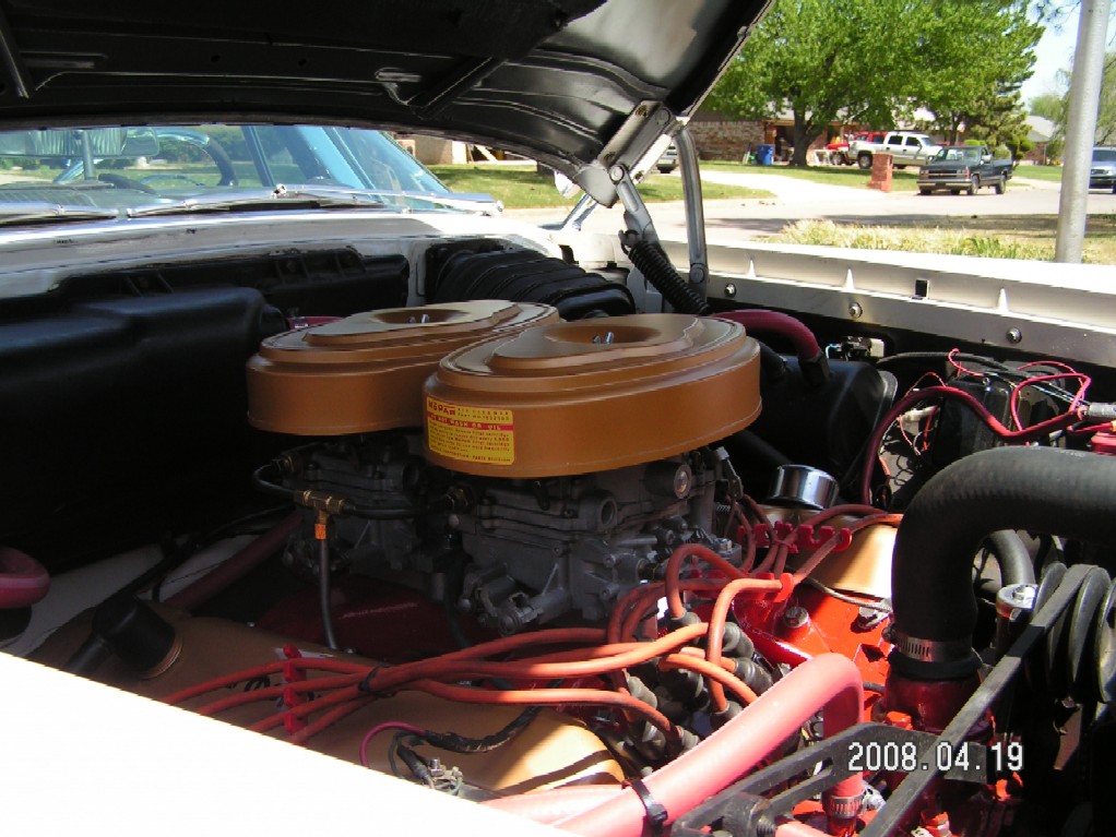

I have factory mopar dual quads on my 59 Fury. I will send you a pic or two of it. I will throw in the latest pic of my 59 also.
Chuck

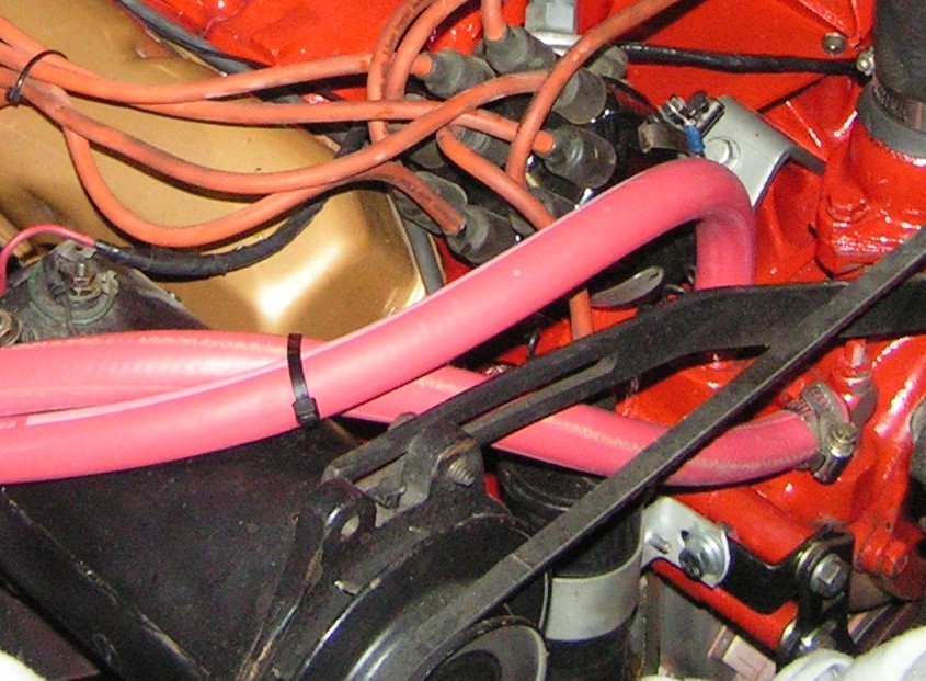

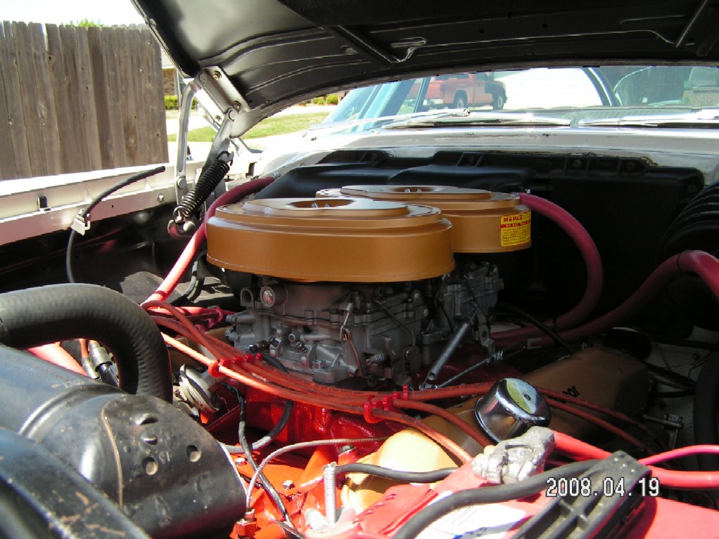

Stefan,
I sent a few pictures to your email.
Picture of coil
Here is a picture of the linkage side.
linkage side
Other side
Pic of the whole thing.
I received the pictures - thanks a lot!!!
That’s exactly what I needed.
You have a beautiful car by the way.
Stefan
