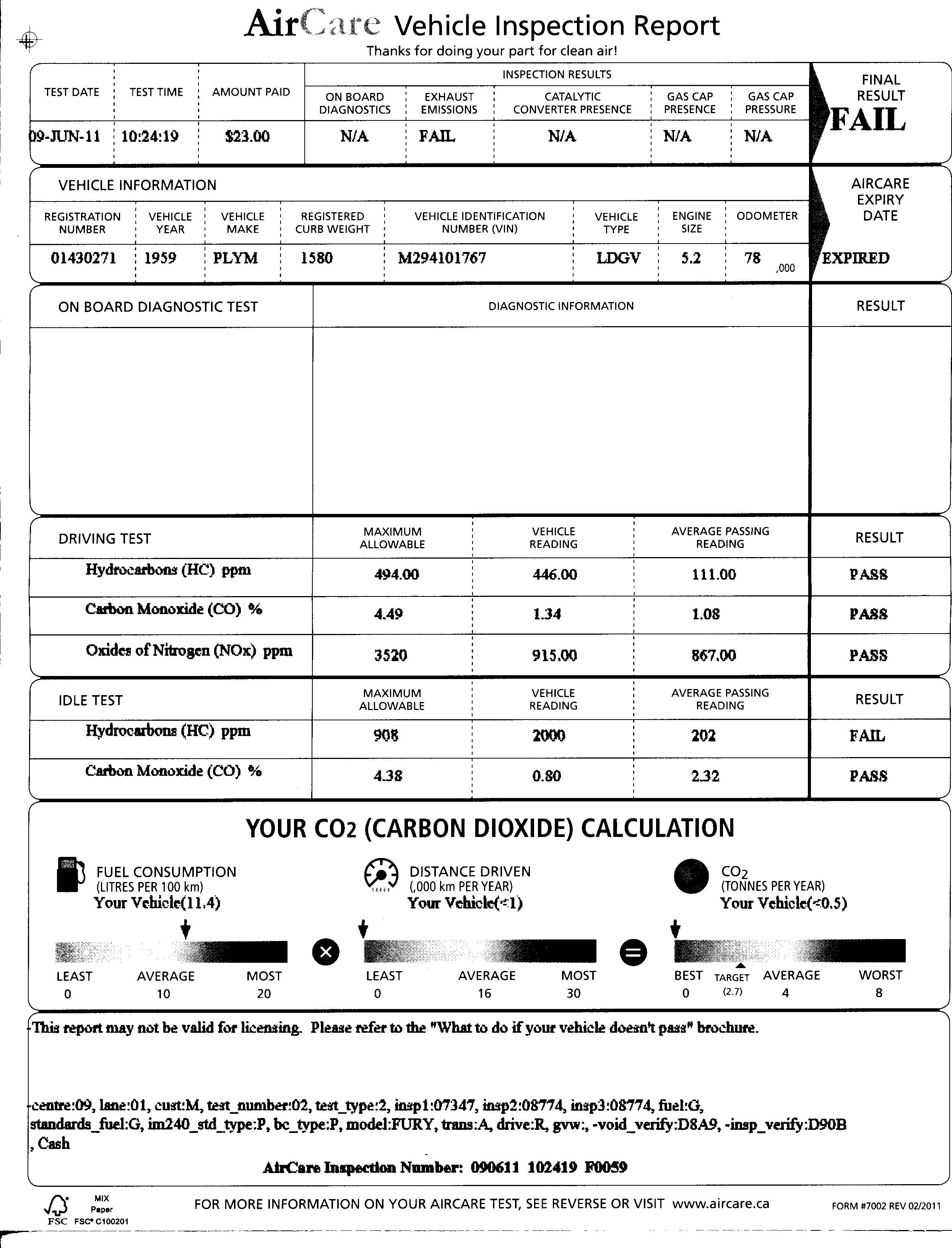

here is the smog report i received on the fury.as you can see,all passed except the hc @ idle,passed hc on driving test,thoughts?
smog test report.
Too lean, Engine fully warmed up, air filter in place. Check the timing, vacuum advance line disconected and pluged. then rehook vacuum advance.and Hook up a tachometer and adjust Idle mixture needles equally to best idle ‘highest RPM reading’ and then turn them back in 1/8 turn. Too much advance timing can cause high HC readings.
Ricky nailed it-
Too lean, either mixture adjustment or vacuum leak, or your initial timing is too far advanced.
