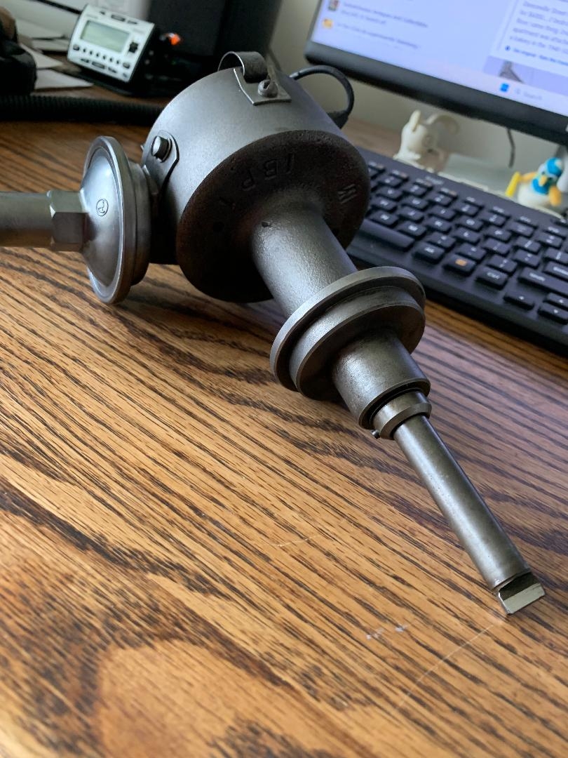

On my 59 Dodge Poly 313, I have the distributer out and I cleaned it up and will replace the points/condenser etc., but noticed there wasn't anything resembling a seal or o ring where it goes in the engine. I'm thinking a round paper gasket of some kind should be there... Strangely, no oil leak or weep at all in that area. I did consult the Canadian shop manual for the car and it doesn't show anything, paper or steel. I'll give it a smear of sealant.
Distributor is back in and the car runs so much better with new points, condenser and 4 plugs (the rest were backordered.) In the process, I mislaid the metal vac pipe from the carb to the advance so I started it up anyways to see how she runs. At idle, with a warm engine, The carb is still producing substantial vacuum. Shouldn't the carb only supply vacuum to the distributer on acceleration. Idle is set at around 750 rpm.

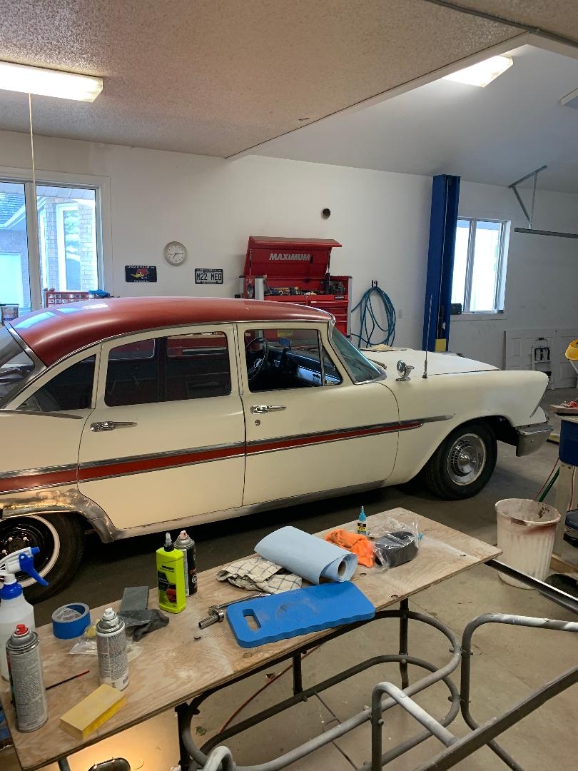

Finished the right side. only the hood to go and the body is done. (except for the rt. rear wheel well.)
I'm convinced the red hood springs power the car. the engine is a prop;)
Seats are still 2-3 weeks away! Hood is up next and fender skirts due this week!

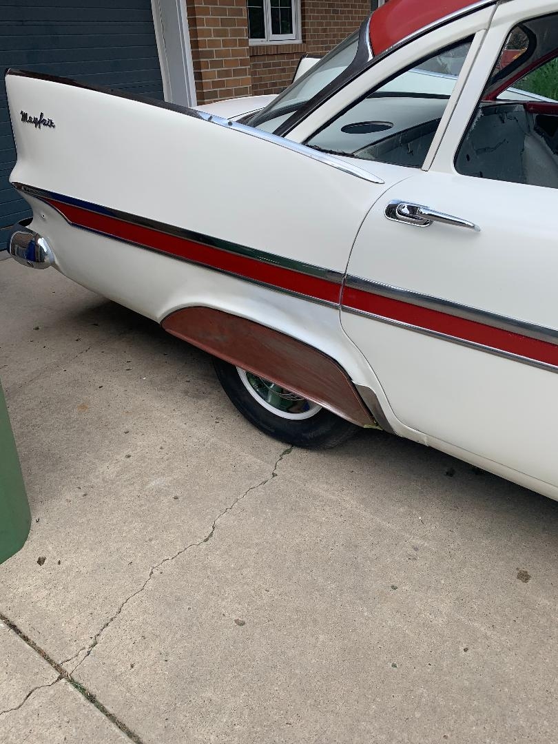

...and the skirts are in! Considering that I re did my pass rear wheel well using a piece of cardboard for the shape from the other side, I'm happy how close I got. The NEW rear skirts fit better than I thought they would and will help me fine tune the shape.

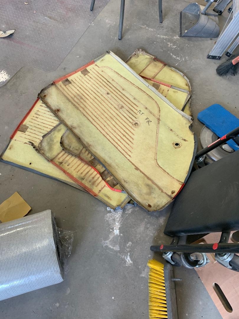

Drains were plugged in two of the doors causing them to overflow water into the car. Removed all four panels, stripped the chrome and clips and carefully peeled off the padded vinyl. The vinyl is discolored and has damage at the bottom, but I'm sure I can rehab it. once I washed the crud out of the doors, I was surprised how intact they were!
Washed out the doors and rustproofed them, lubricated the window winders and lock/door handle mechanisms and installed vapor barriers. My good buddy Leif, (using the old ones as templates), replicated the 4 door cards in 1/8 ply right down to every clip slot and chrome trim mounting! Waiting for the marine paint to dry and then the vinyl covers will be reinstalled and repairs to the thrashed areas can commence. The small leaking quarter glass is back in and at least that leak is fixed.

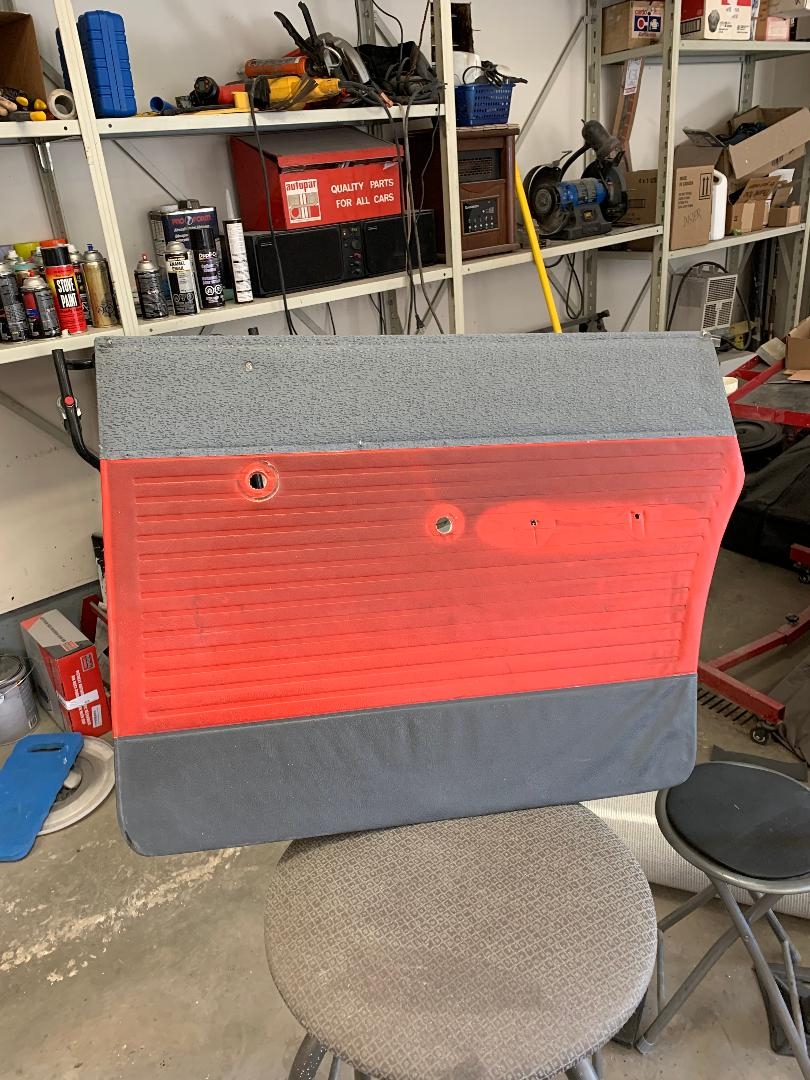

Plodge Mayfair Door panels refurb almost done. Have done leather restos on old Benz's, but never tackled vinyl. Vibed the clips in my wife's jewelry cleaner and repainted the clips. Treated the vinyl like bodywork ,but used JB Quik instead of bondo. Found good matching paints and dulled it back down with a matt clear final coat. Because the panels were home made, all in under $150. So far, still under my budget. Pass front to do once I find more clips. 10 at the bottom of the panels were rusted away. Seats expected to be done in 1 1/2 weeks!!
