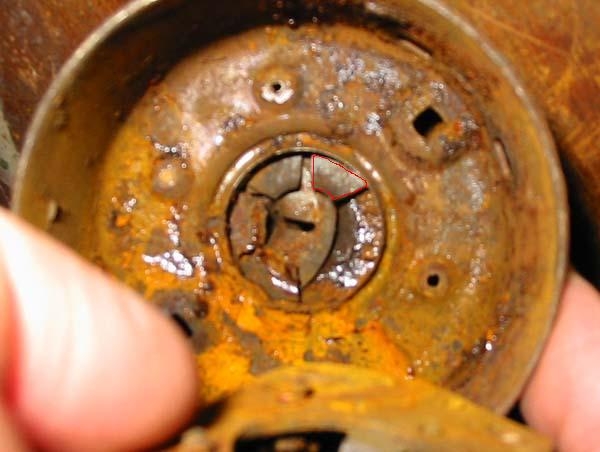

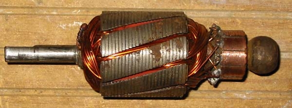

Tom's suggestion was a good one. I drilled a small hole in the recess that holds the bushing, and dripped in some rust cutter, a couple of times. Then I took a punch, braced the housing, and tapped the armature out...
Voila! Out it came.
With the bushing still attached... :cry:
Then I peered inside the can -- and what to my wondering eye should appear... :shock:
Tom was right; there's no retainer for the shaft. But, there is for the bushing -- and with the bushing frozen to the shaft, the retainer took the hit.
You can see where I outlined one of the 6 tabs in red, that comprise the retainer for the bushing. In the center is the fragment of retainer containing 2 tabs. Now, here's what I propose to do, tell me what you think:
1) Clamp the bronze bushing between wood blocks in a vise, and after liberal doses of penetrating oil -- again -- attempt to tap out the shaft. (You'll note that the commutators cleaned up nicely.)
2) Remove the fragment from the can, clean it all up, place the bushing in the center, and pot the bushing in the recess with high-temp RTV.
I'm thinking that will keep the bushing in place, and handle the heat well. (There are circuit breakers in these motors, BTW.) What do you think about this idea?

excellent pictures and description of a rusty motor.
First you gotta get the bushing/bearing off the shaft. The woodblock clamp seems like a good idea. Be patient w/ the rustcutter!!
As for setting the B/B back in the unit with RTV, I have little exp with RTV other than BlueRTV, which I don't recall getting hard...maye the flexiblility will work to yur advantage. I wouldnt worry about heat...how many times do you need to crank up your windows?

Hi Dan, I believe the retainer is there for assembly purposes, so it doesn't fall out, If you get the bushing off the shaft and free to turn, I would assemble the motor and not worry about the retainer. Once it's together, the bushing can't go anywhere. Sealing it with something may not allow it to self align. No retainment will make it easy to take apart again, in case it doesn't run the first time.......
Tom

Seems like there was a socket that the bushing would sit in, on motors I have had apart, and the retainer just held the bushing in the socket. Could be your motor is a little different. Hard to tell from your photo. If you don't have the socket, then maybe you would need to use some form of material to build a socket to hold the bushing in the center.
Tom
Posts: 5171
I am sure now that you are right, Tom. I've removed the retainer fragments, and it's clear that there's a well for the bushing to sit in; when assembled, there's no reason for it to shift. And now, I have a convenient hole for routine oiling :P
