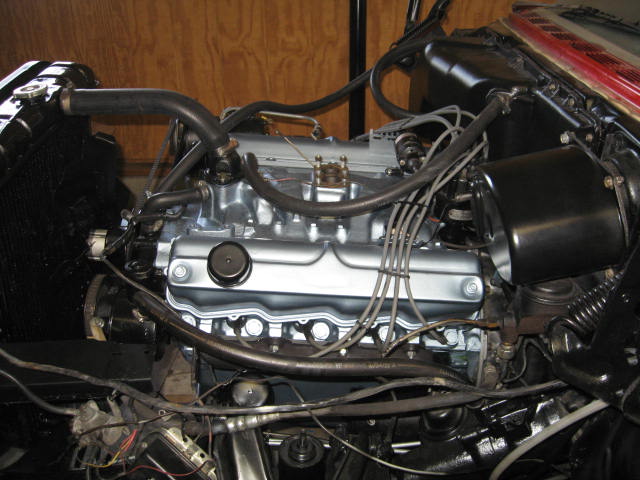

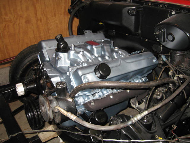

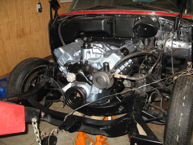

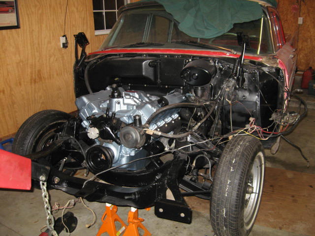

Guys; I got the motor and tranny in over the week end,things have been going together very well,the motor mounts and tranny cross member and tranny mount have all been torqued,as well as the bell housing bolts.It took A little A little time to figure the water pump bolts(different lengths) Ihad to refer to my pics and found the power steering bracket bolts to it,good thing I took lots of pictures before I took it down.I also placed the hardware in zip lock bags with A note describing what and where it is from,that helps alot!! Next weekend should be the starter,exhaust pipes,brackets etc. bye for now Mark M

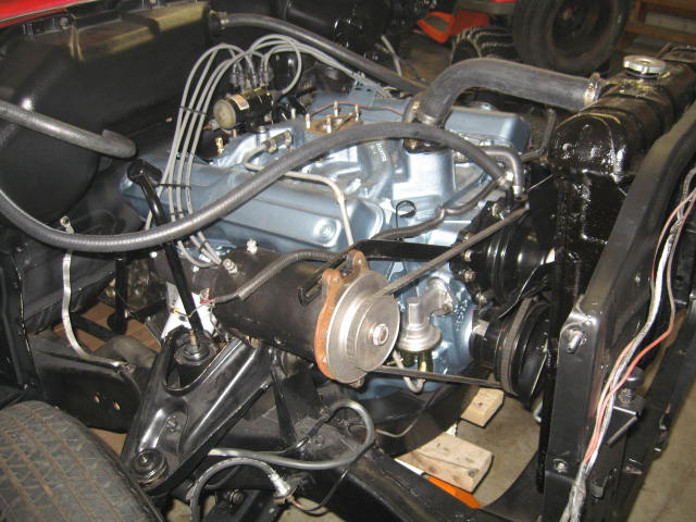

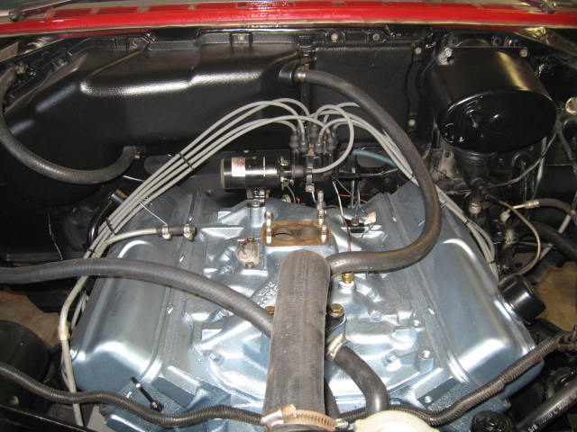

Guys;I got some more done this weekend,took A break last weekend.I got the carb sent out for A rebuild,still need to hook up th tranny cable(any trick to how it goes back in ?)neuteral safety switch wire,fuel line,probably put the driver side inner fender on before I fire it up to place the voltage regulater,selenoid,wires,etc.All filled with fluids,the distributor was A fun time with the oil pump alighnment to the distributor gear,to the number one(front driver side)and felt for compression stroke(finger in hole)and made sure the piston was at the top with a plastic rod to monitor for top dead center,then checked the timing marks and it was right on the money!! I made stamp marks on the distributor/block for reference and went back perfect,alot of previous pictures also helped before the tear down.If I got the carb back and spent an after noon I could fire it up,but I am kind of waiting for the weather to warm some more,would be nice.I also installed an auto meter mechanical oil pressure gauge and am also running the idiot light,I put A T fitting in the block.I put plugs in today,autolite ar85,i'll give them A go, .035 gap and am running points(old school)I just hear alot of pros and cons(mostly cons) about electronic ignition,and I am staying with points,that is all I run in my tractor(1955 Ferguson) never skips A beat,run hour after hour and just an occasional touch up/re set.Don't know if I will get to it this weekend,I'm A birthday boy on thursday the 21st (55) the wife say's i'm getting spanked,I can't wait!!!! Buy for now Mark M

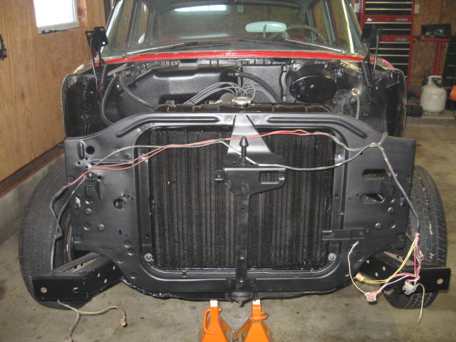

Make sure you route the passenger side park, horn and headlights wiring behind the vertical Hood support, if you forget then just unbolt the support and tuck behind..

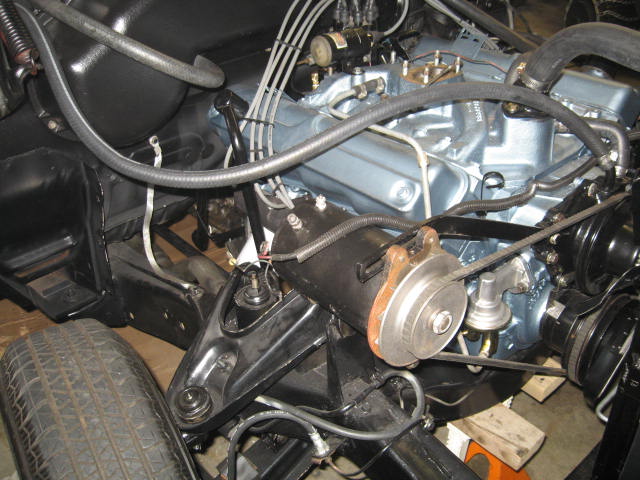

Hey Mark,
Is that a GENERNATOR (ALTERNATOR in a GENERATOR Body) you have fitted there.?
It dosnt quite look like a stock Generator.
Mark Merritt
Posts: 553
Re: Marks winter of "59"
Post by Mark Merritt »
John; I will double check my pics for the wire routing,i'm sure your right, thanks for bringing it up,Jason that is A stock generator,the face at the impeller has A little surface rust from the clean-up/rebuild,maybe that is why what looks different. I need to touch it up,thanks, Mark M

Looks almost like teh factory assembly line...so clean and purty!
