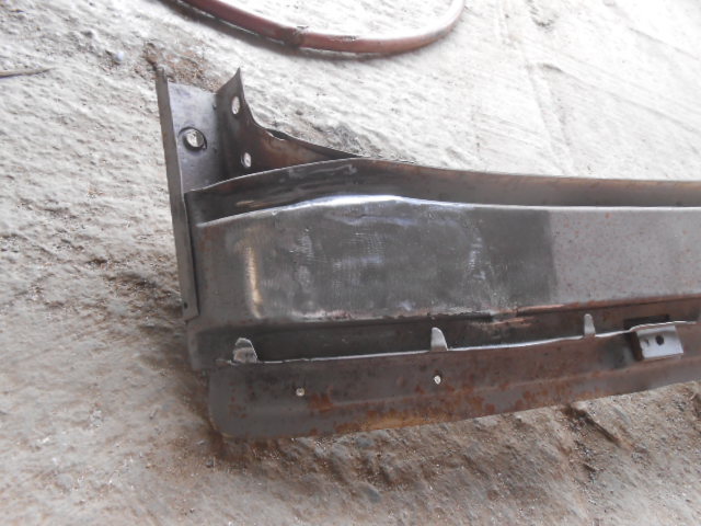

The header bow after blasting revealed multiple pinholes, so I cut the weak metal out, fabricated a patch panel, carefully welded it in and metal-finished it.

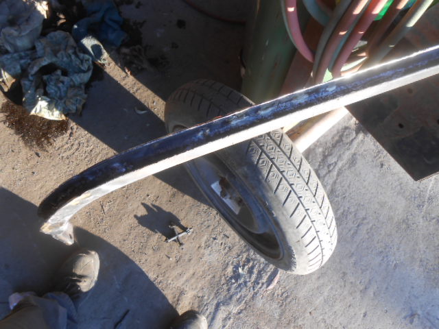

The rearward bow was a bugger, I never could find a replacement, so weak sections had to be cut out and replaced, thin metal was brazed back together to regain rigidity.
Heavy primer was then shot on both pieces, then sanded off with 600 grit paper. This will fill the remaining pits in the metal for a better finish.
