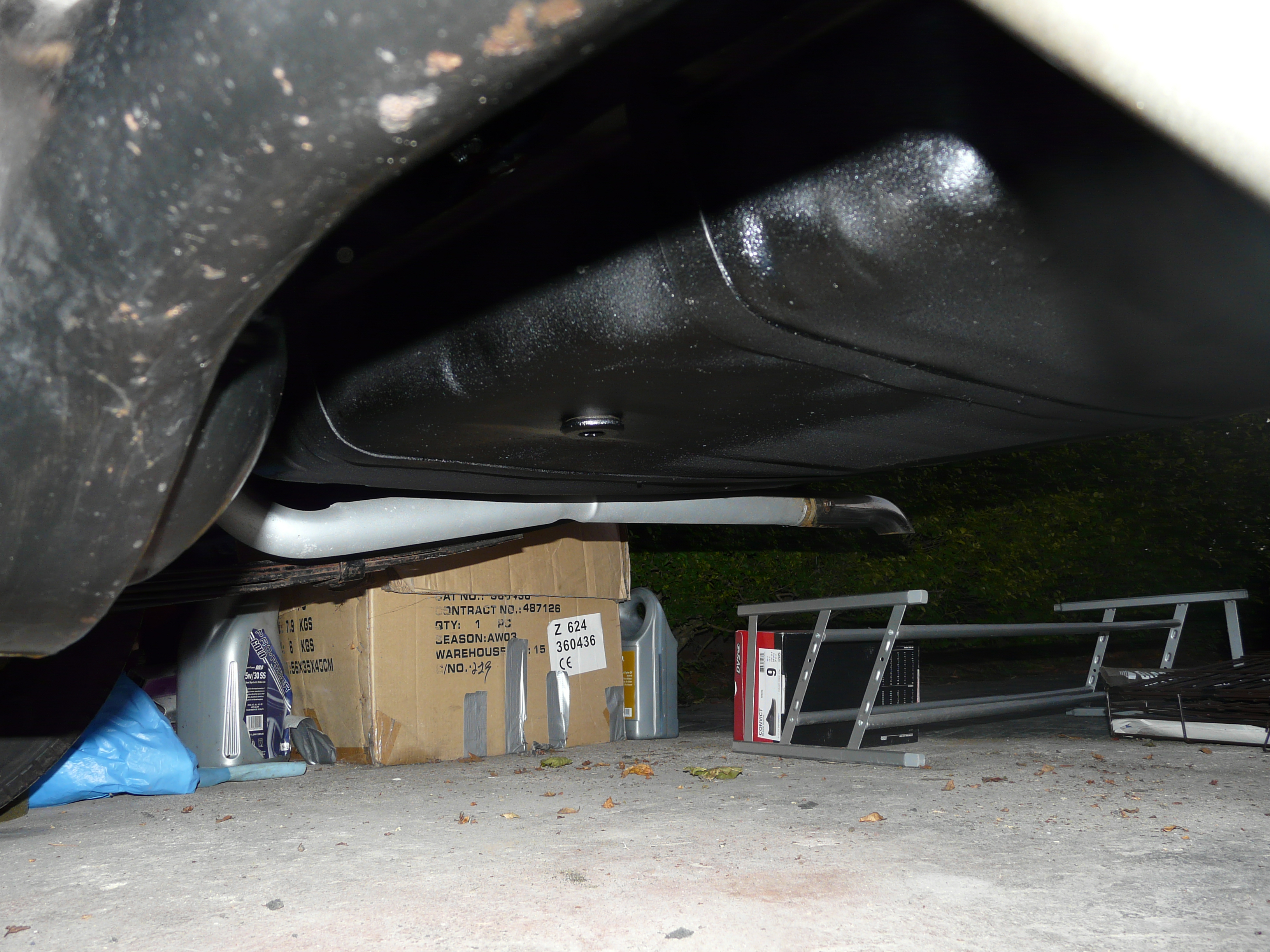

Dennis Photo's as promised. They aren't great and excuse the background material. Tank was galvanised but we decided to paint it with underseal to protect against the UK weather. Also added a pad to the top of the tank to stop any vibration.

Thanks for the extra effort in supplying these photos! The tank looks "natural" and the installation looks professional. I'm going to go ahead and order one, along with a new set of straps. I think I'll put a coat of zinc chromate on it as a primer, then spray it with a coat of "stainless steel" color. What did you use for your protective mat that goes between the tank and the trunk floor? Thanks again for the photos! Dennis

The pad is of the type used for sound deadening ( inside door skins etc ) They appear to be made of a bitumen type material and adhesive on one side. They are heated a little when fitting so they adopt the contours of whatever you are sticking them to. I seem to remember there was something similar when we removed the old tank ( not sure if that was originally fitted or a later addition). Hope this helps . Guy
