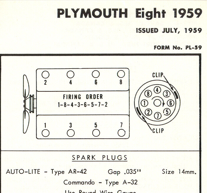

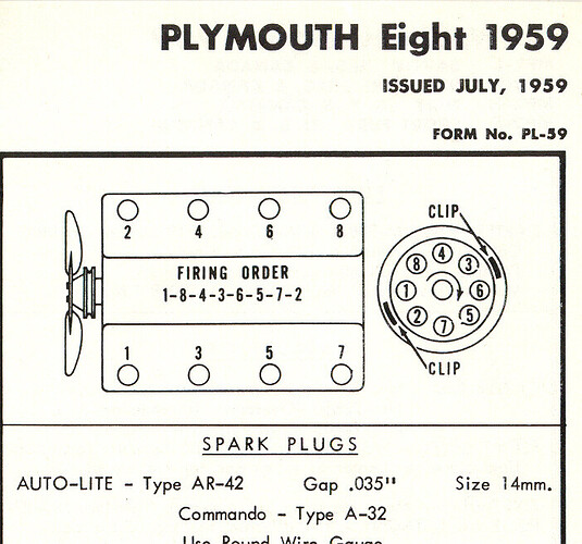

Ok, back to left vs right. I dug out my cardboard reference of wiring placement which I made when I detailed my engine. I had all wires laying on bench so wanted to make sure I put them back in correct order in which I removed them. (#1 wire going to #1@ distributor, etc) According to my chart - sitting in drivers seat - left bank (drivers side) of engine (front to rear) is 1 3 5 7 and right bank (pass side) front to rear is 2 4 6 8. I have an old “Motor” Manual and they describe it as - Cylinder numbering (font to rear): left bank 1-3-5-7 and right bank 2-4-6-8. This cylinder numbering, by the way, applies to the 361 engine also. I too see that the Ply Manual states “from front of engine” . Kinda confusing. After all this typing I just found a picture. Will try and send it.
That diagram’s a keeper – thanks, John.
