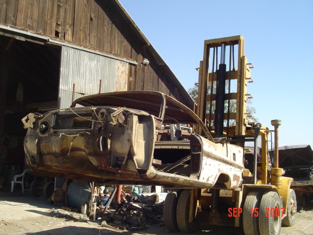

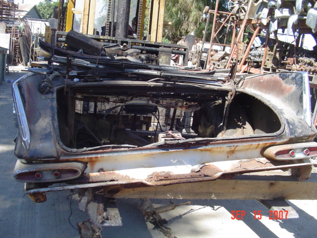

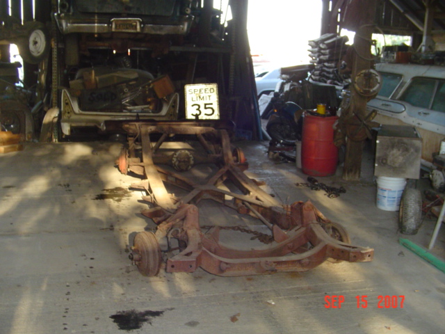

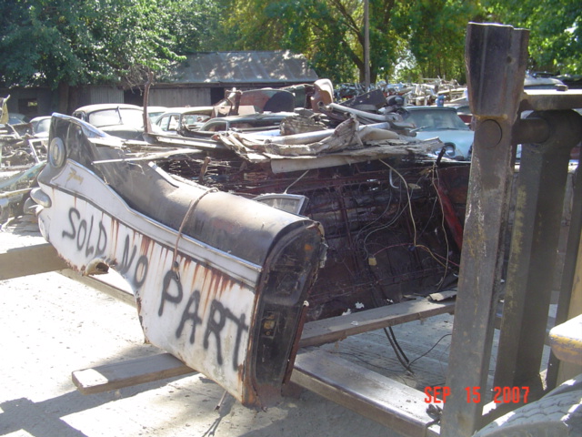

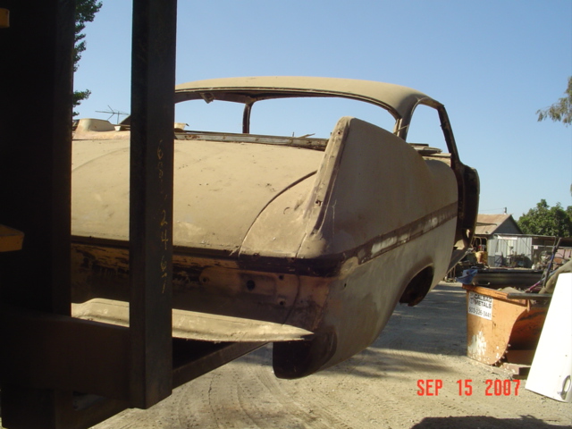

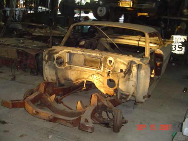

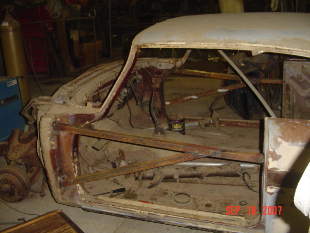

This weekend, I actually took some time to get the rusty convertible out, and set the solid hardtop body on it’s chassis. Here are some pics- Front half of the convertible

Big M, I thought I had it tough when I began my project..your stuff looks horrible…but I senze you know whta you are doing..

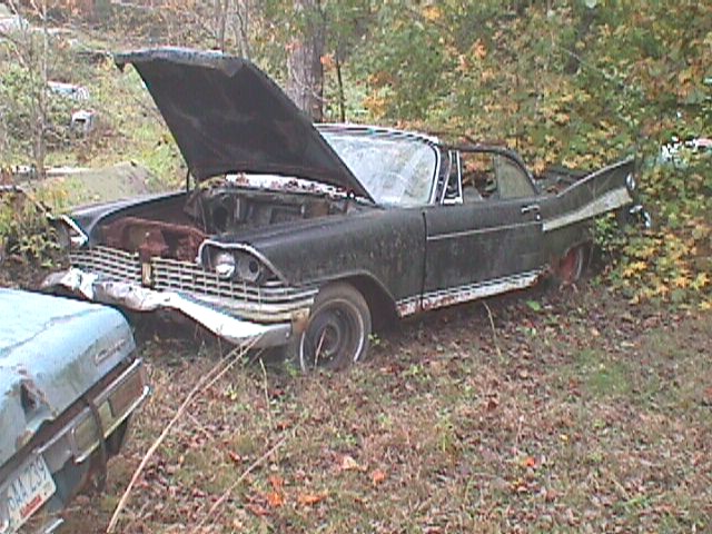

but I will attach a picture of the beast
Brad, I sent him several e-mails regarding that car, but never got a response. Maybe it has been sold already.
Beginning to look like I will be making the header bow, unless something turns up. —John
i thought i had it bad, wow!
ur gonna be spending some late nights in the barn. what ever happened to ur 59 fury project? --j
Jeremy, the '59 Fury is being mated to what is left of the convertible. —John

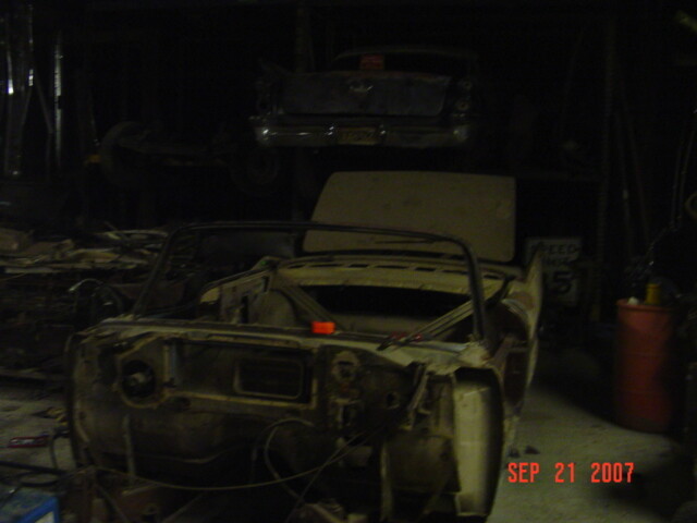

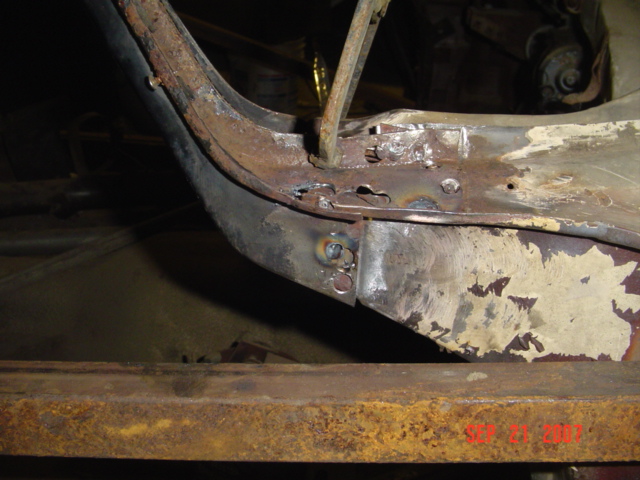

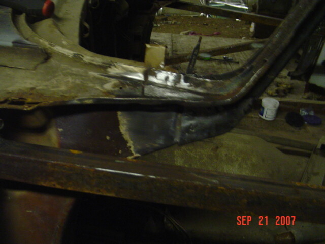

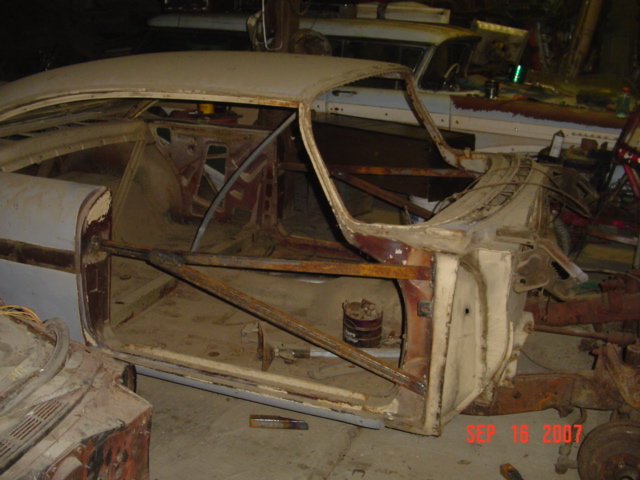

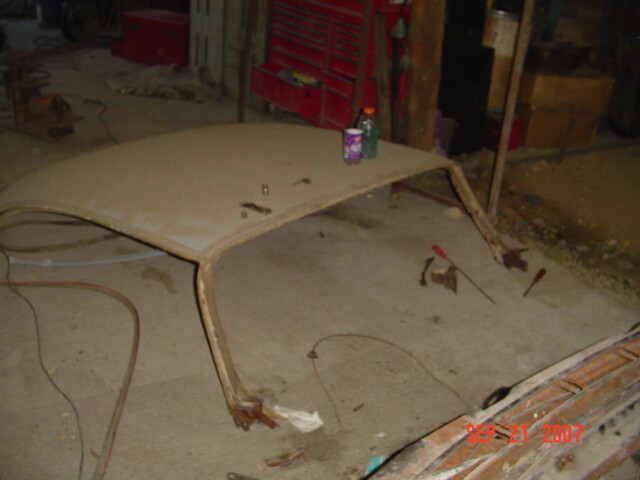

Here are a couple more ‘in progress’ pics of my project. Removing the hardtop, and installing the convertible windshield frame. —John
Windshield frame installed, just needing to finish the seam with lead, which will be done during the bodywork phase. Sorry for the crappy pictures, it is a bit dark in the barn. —John

John, I admire your energy level and metalworking abilities!
I dont know if it was my bodyman’s fault or what, but I have always had an alignment problem where the drivers vent frame meets the “A” pillar.
My bodyman had a different approach to the windshield..I dont think he swapped out the entire “surround”, but I have photos of him trying to adjust the “tilt” of it. My advice is of little value, but perhaps you can dryfit the doors and vent frames to see how the line up.
