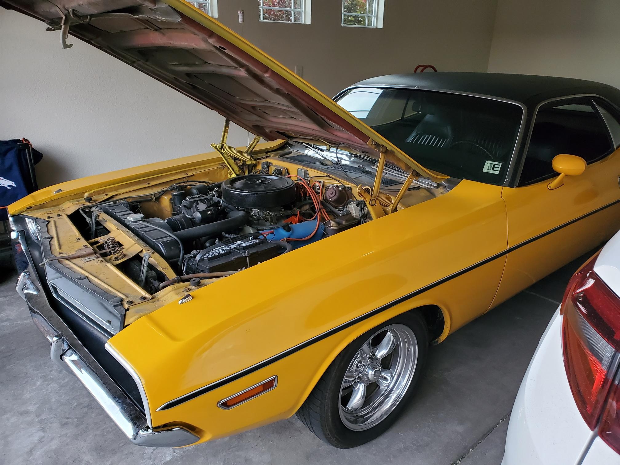

Posting pictures of an engine I modified, for my son's ride. It is an LA series engine, 318 that is stroked to 390 CID. Our son is a big Denver Broncos fan.

I'm guessing the Broncos comment has something to do with the engine color, Rick?

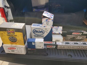

This was the original engine for Kevin's Challenger. The over bore is .030 or 3.94 and the new stroke is 4.0 original is 3.31.
Mopar performance or Direct Connection crankshaft was utilized.
Icon forged pistons with relocated pin boss for increased stroke.
Eagle 6.123 H beam rods, standard length, performance mod.
Comp Cams mild performance torque enhancement cam kit, including double roller timing chain.
factory original adjustable rocker gear, raised .060.
2,02 intake valves and 1.065 exhaust for better breathing, mild port mods.

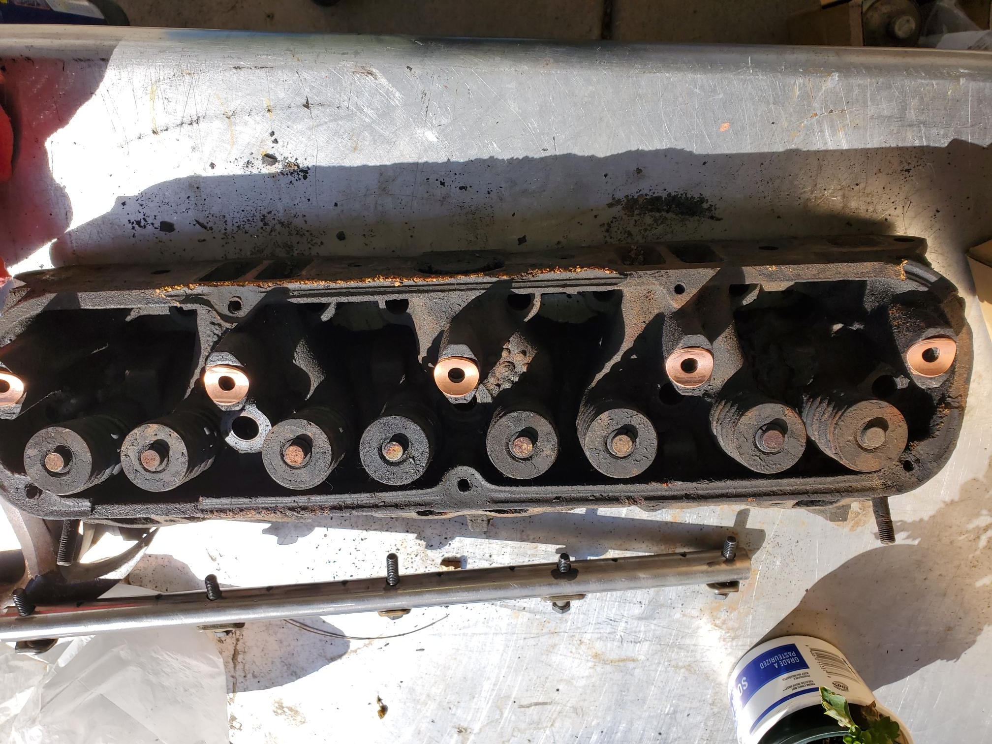

Picture of old heads and copper washers being modified to correct rocker arm geometry.
