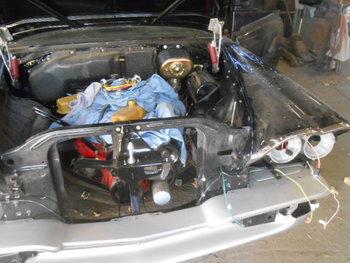

I routed the front wiring harness, and installed the rebuilt brake booster, new master cylinder, and vacuum tank.
In rust we trust!

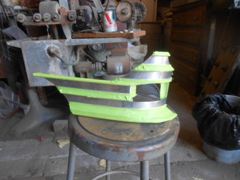

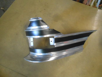

I got the majority of my aluminum trim back from the plater, everything looked good, except for the trunklid 'toilet seat' insert, which is pretty well destroyed. There's a chance they misunderstood what I was wanting, I have a couple spares, but may find someone else to do it depending on what I am told.

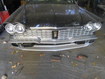

I masked and painted the parking light bezels, and reassembled them to the lower grill strips and grills with all redone original hardware. Then I fitted the assemblies into the front filler panel, and bolted them in. Next, I acid dipped the park light sockets briefly to remove corrosion, then painted them silver for better reflection. Next, NOS lenses were installed.
In rust we trust!

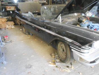

More side trim fitted and installed. Time consuming considering I had to refurbish quite a few of the clips and modify a few to line the trim pieces up better.
In rust we trust!

Matthew Keij
Posts: 1407
Re: Getting a start on the convertible project
Post by Matthew Keij »
Are the front trim pieces on the correct position?
Looks like they hit the eyebrown trim and should be moved a bit towards to the rear

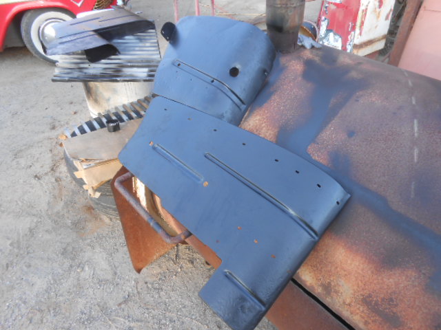

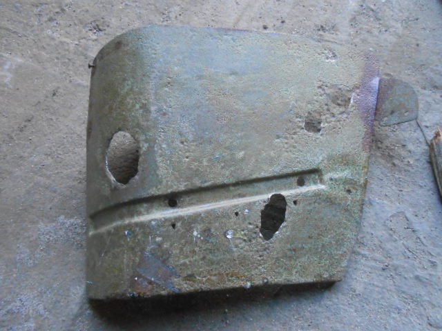

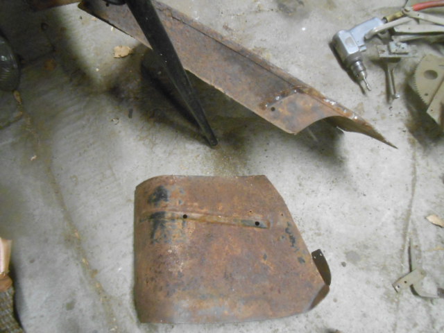

I had the original rear seat armrest panels that are specific to the convertible, but they were in poor condition. I had an extra that another '59 owner had given me for a pattern, its upper section was much better. I drilled the spot welds and removed the upper section.

I had a set of hardtop panels that were in relatively good condition, metal-wise, so I modified these sections to duplicate the lowers used on the convertible. Next, I cut out the weak or rusty areas, and butt-welded new metal in. These will be upholstered later.
Next, the upper sections were re-welded to the lowers, and surface rust has Ospho applied to remove it. After neutralizing and drying, a coat of protective paint was applied. These are now ready for the upholsterer.

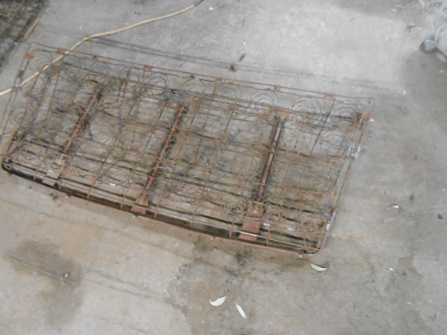

On to the rear seat cushions.

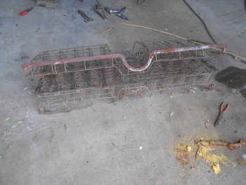

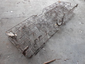

Even though the original seats were decimated by rust, they still worked for patterns. I had always been told that the rear seat cushions were convertible specific, but found it to be part true. I removed the hog rings on a coupe seat lower cushion, and placed it next to the remains of the convertible one. They were the same! This was encouraging, as I was not looking forward to making a new one up.
The upper seat back was a different story. It shared nothing with either a coupe or sedan seat.
I was able to salvage the rear backing by welding sections in from another seat cushion, and repairing any rust through. Next, I gathered up enough good springs from a selection of seat cushions, and secured them to the repaired backing. The front frame was pretty much gone, but I used one from a coupe, and modified it to match the rusted sample. Next, all the small springs and securing bands were added, and Voila! Now I have good seat cushions!
In rust we trust!

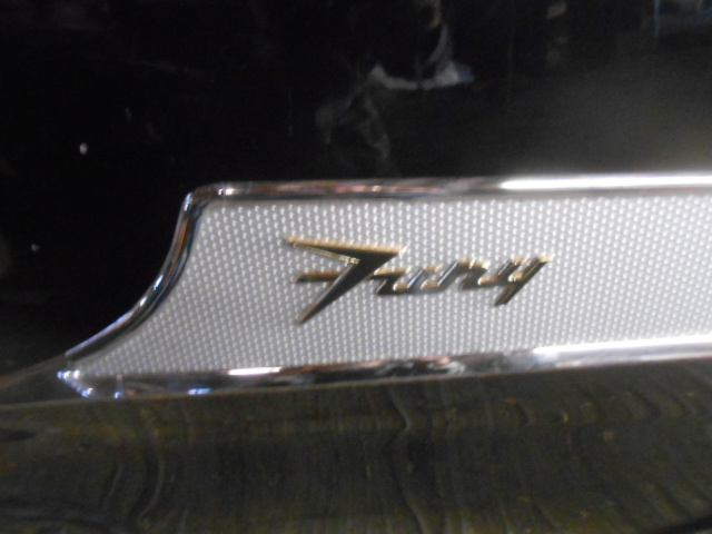

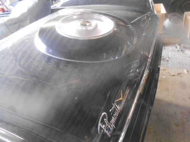

Doesn't look like I've accomplished much lately, but got the aluminum disc for the sport deck and trunk V from the anodizer, and was able to assemble and install the 'Toilet seat'. Also, installed the rear Plymouth script, as well as drilled holes for the gold V. Thanks to Austin for the V, somehow I had misplaced the one I had saved.

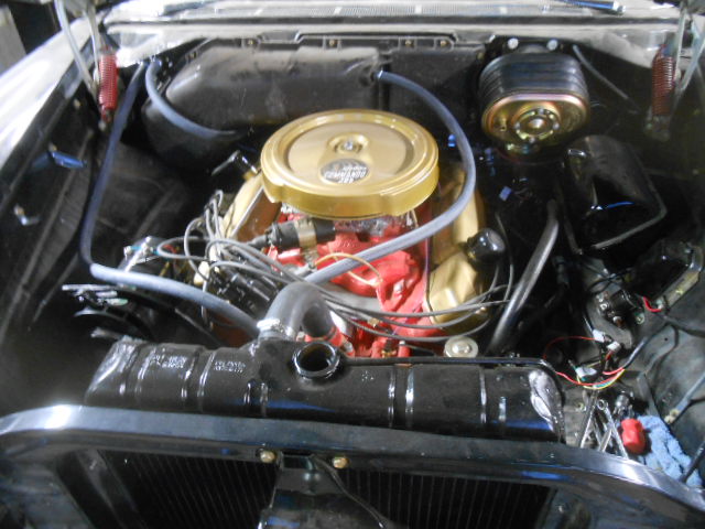

Engine bay closer to finished, recored radiator fitted with new transmission lines, higher output generator also installed. Had to make a custom adjuster bracket, as this generator was originally from a Chrysler poly engine.
