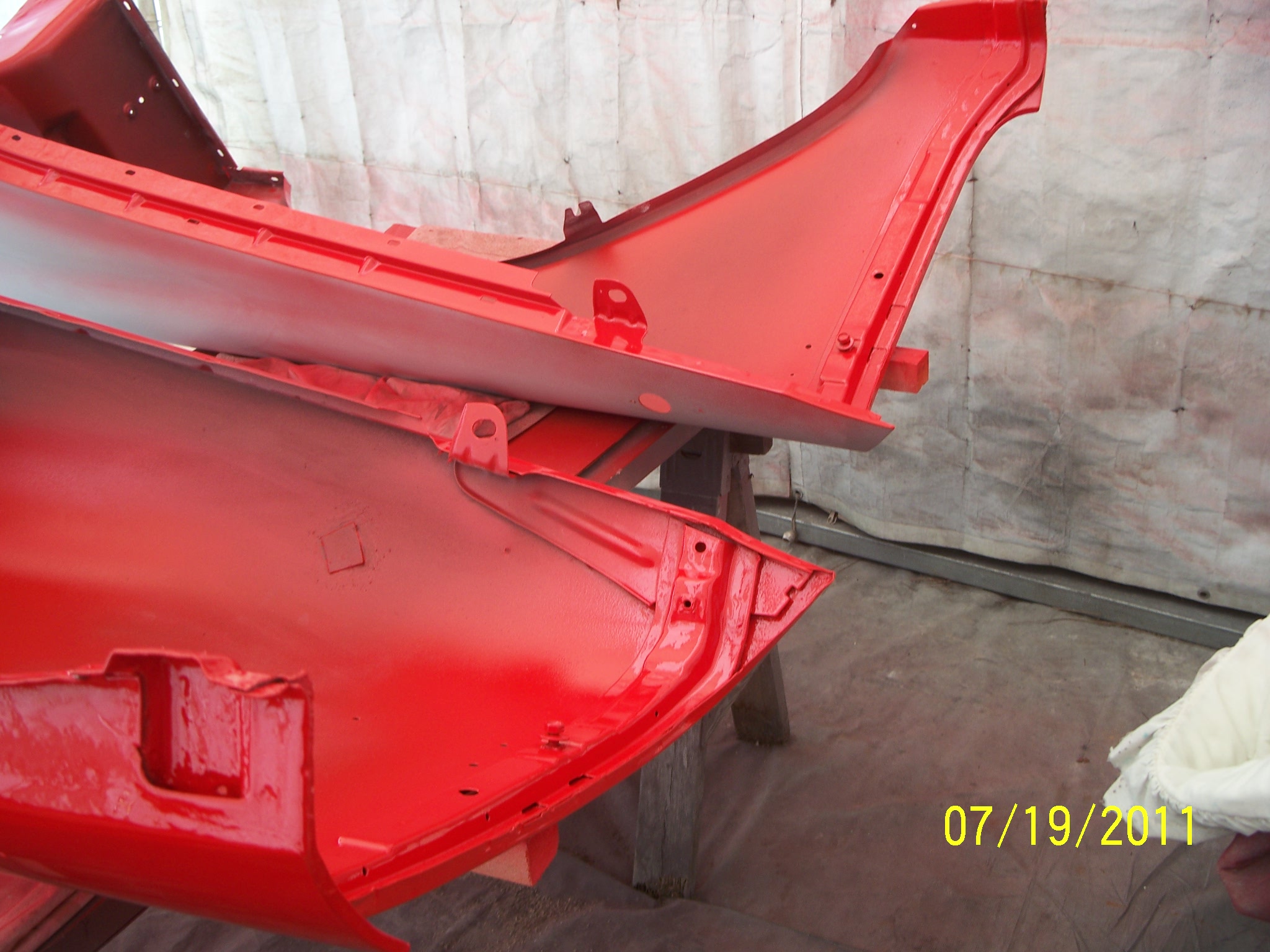

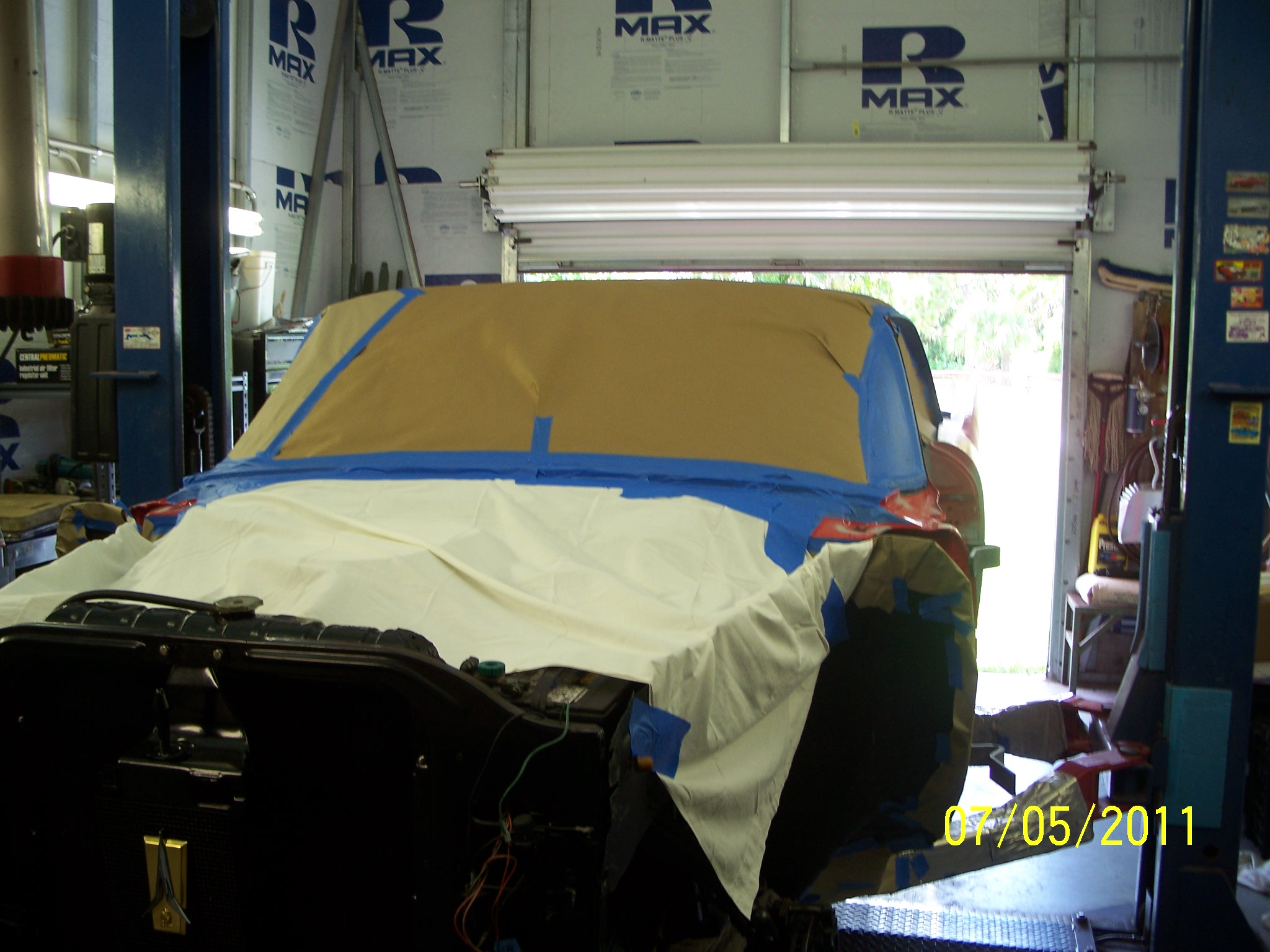

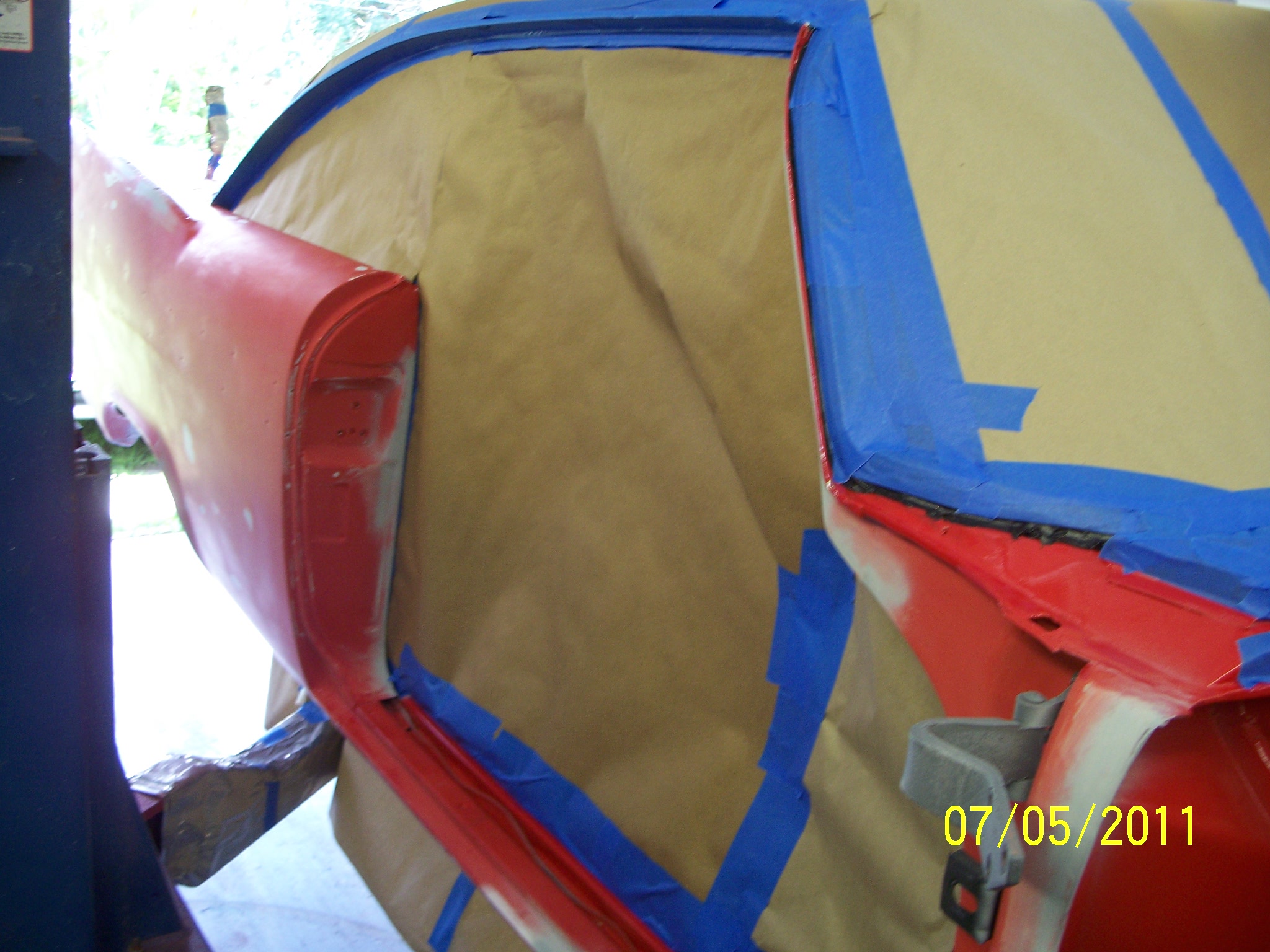

John - Glad to hear you are making some progress. I'm glad I hung the doors and fenders for location drilling because I had trouble with the front of the fender sliding in properly and in doing so I messed up my cowl also. To really do it with the least damage you need at least two helpers. I had to put a thick spacer under the fender mount in the corner of the cowl so I'm going to glue that sucker where it won't be sliding all over the place. I also learned to use a couple of layers of masking tape with a layer of duct taper over that on edges and areas in danger of getting scratched and messed up. I didn't want to use the duct tape directly on the paint because the adhesive is too strong. I had to use a thick spacer under the top hinge on the left side so I'm going to glue that on also. I have everthing ready for paint, I will start with a final sanding of the body, then mask it, then paint. I am going to paint the body on the lift so I decided to take the doors and fenders off because I would not be able to paint properly with them on. Wish me luck.

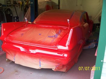

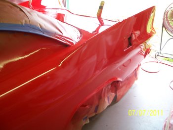

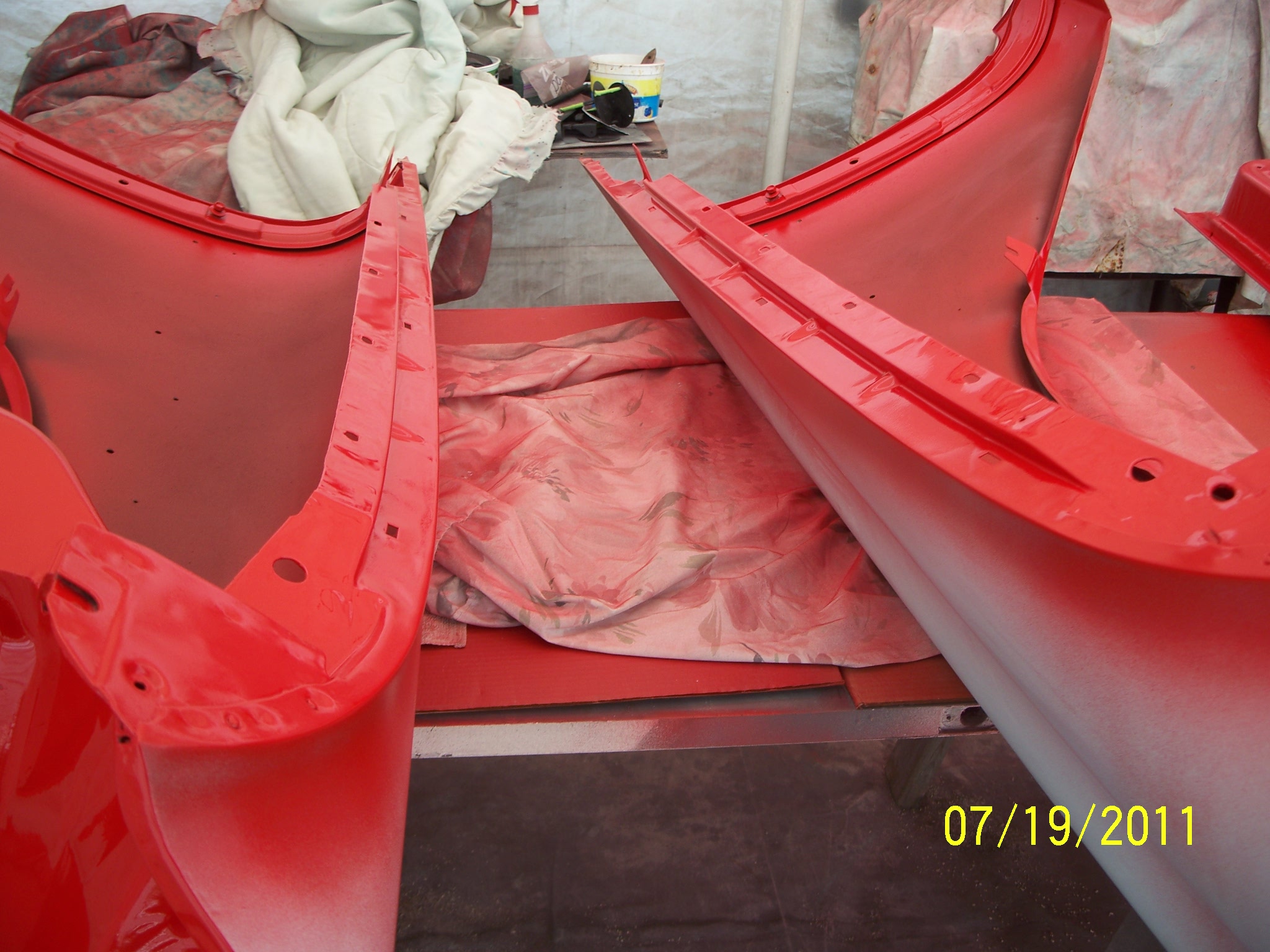

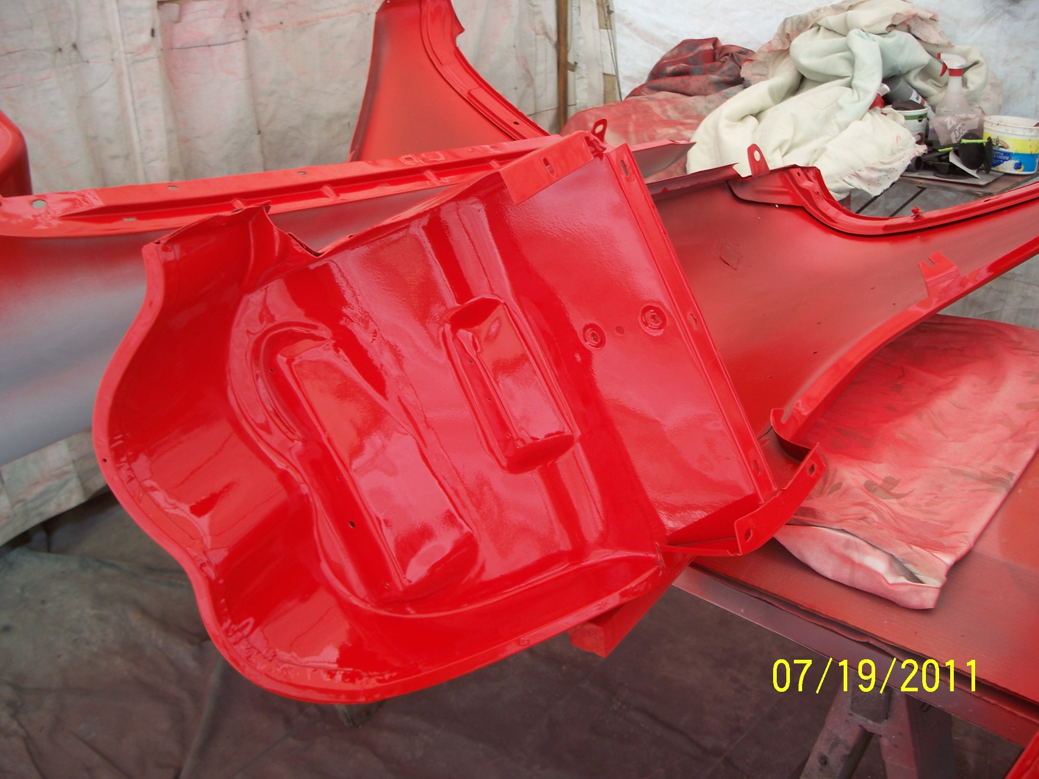

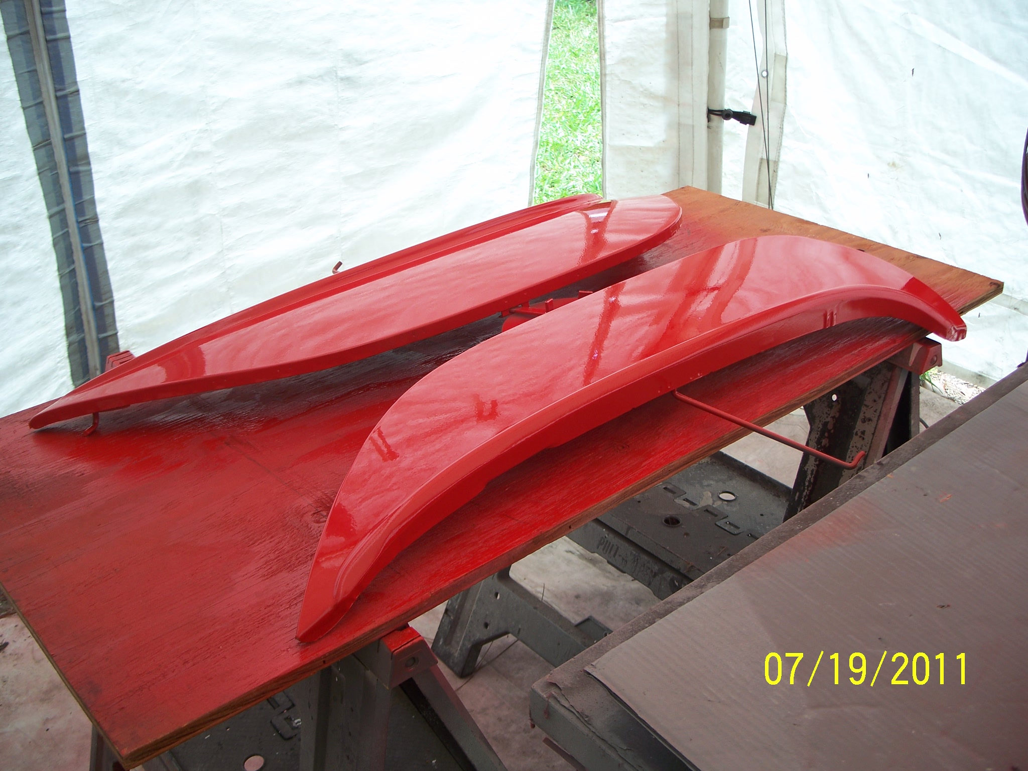

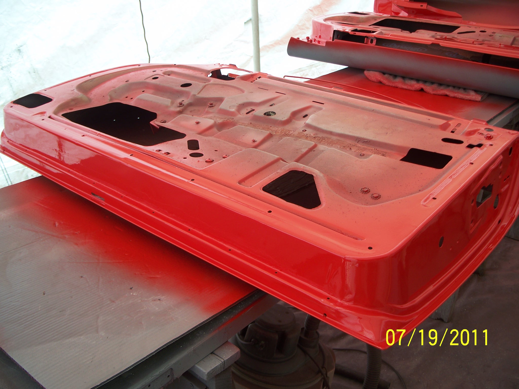

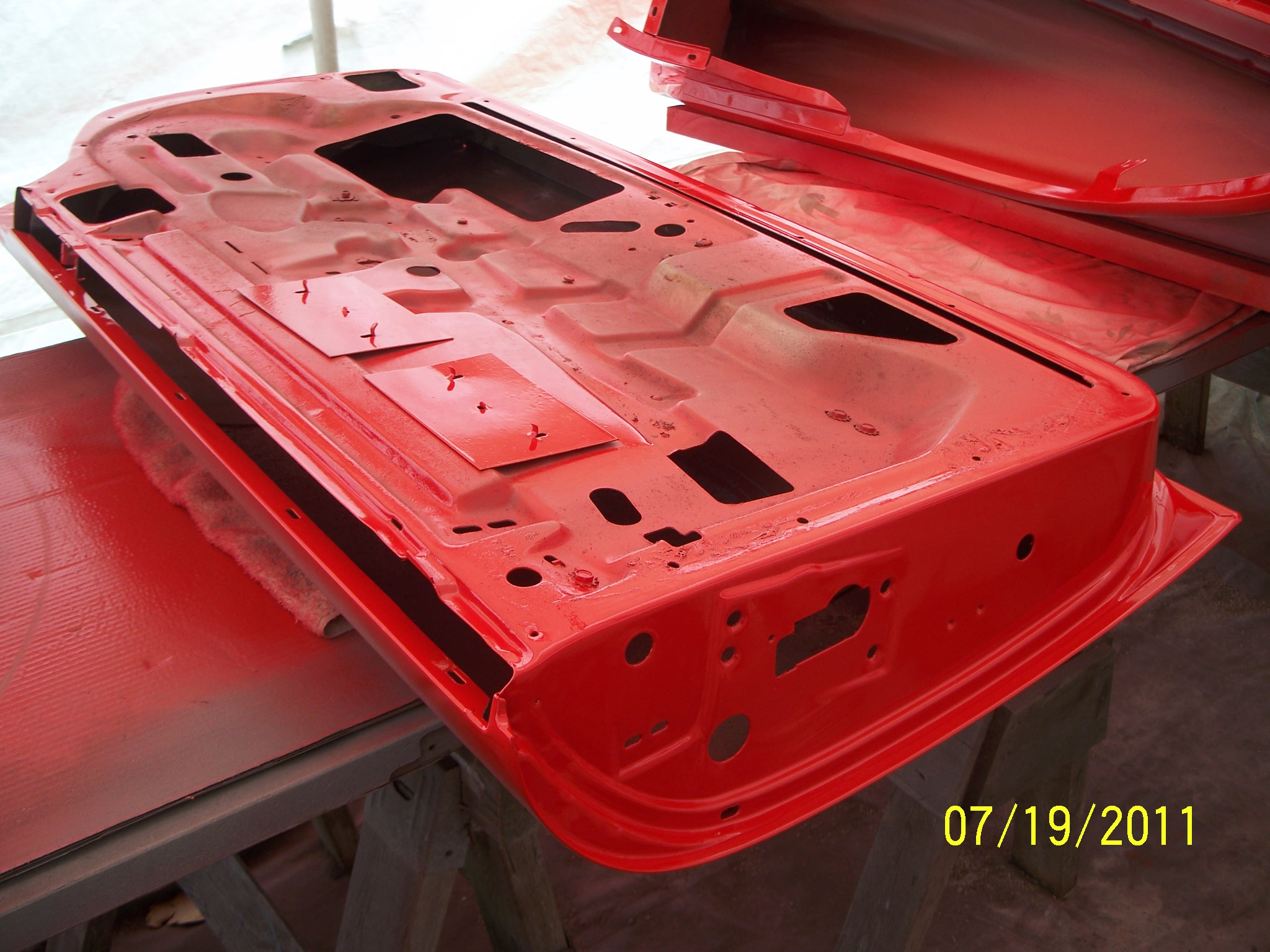

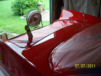

Da, da, da, dat, da, daaaaa. A banner day and a major turning point. Three coats, not 100% but a thousand times better than last attempt. Cloudy with a threat of rain all day. Humidity 88% but I decided to give it a go anyway. It was so hot I was soaking wet, I'm almost finished when a few drops of water appear, I thought it was coming from the gun but it was dripping off the bill of my cap. Didn't mess up anything, thank god. A few nibs and one run but should be no problem.

Pictures look great! I am @ Carlisle with Dan, Matthew and others in the pouring rain. Tomorrow weather will be sunny and hot. Great paint work CA t wait to see the whole car buttoned up!

Great Job.......Nice and Shiney!!

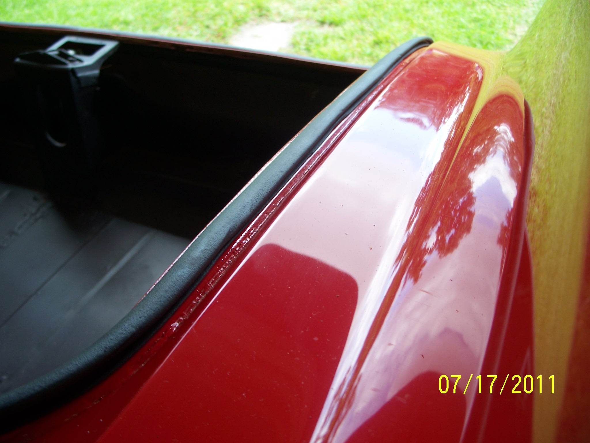

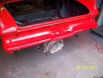

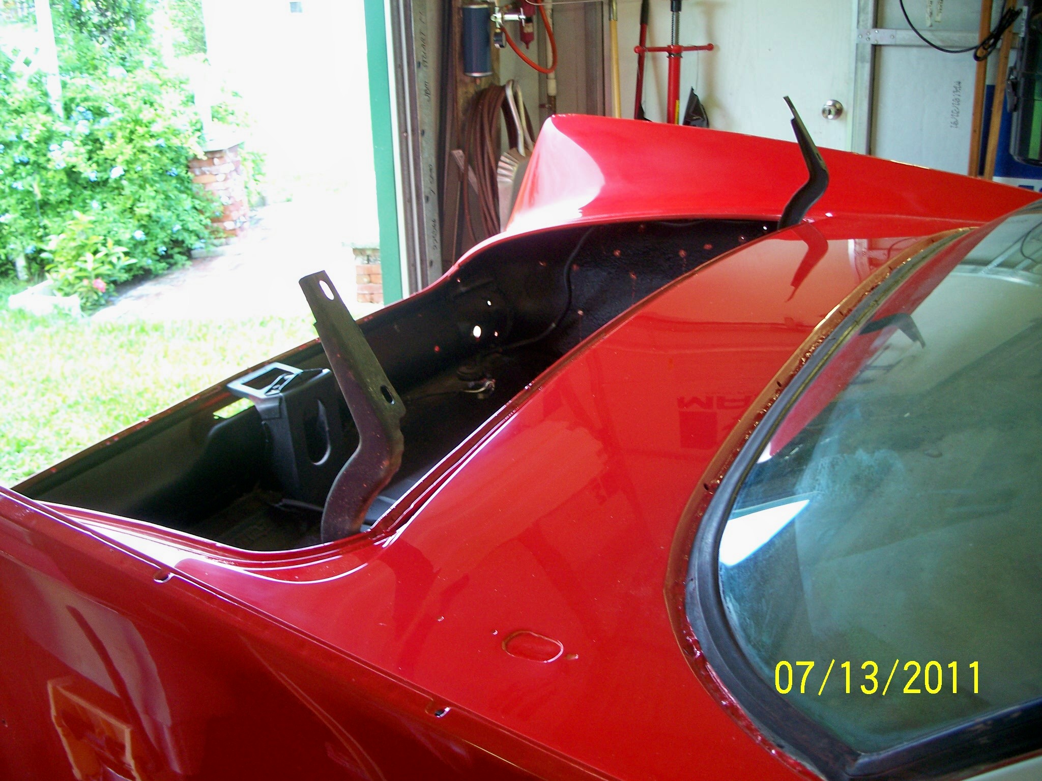

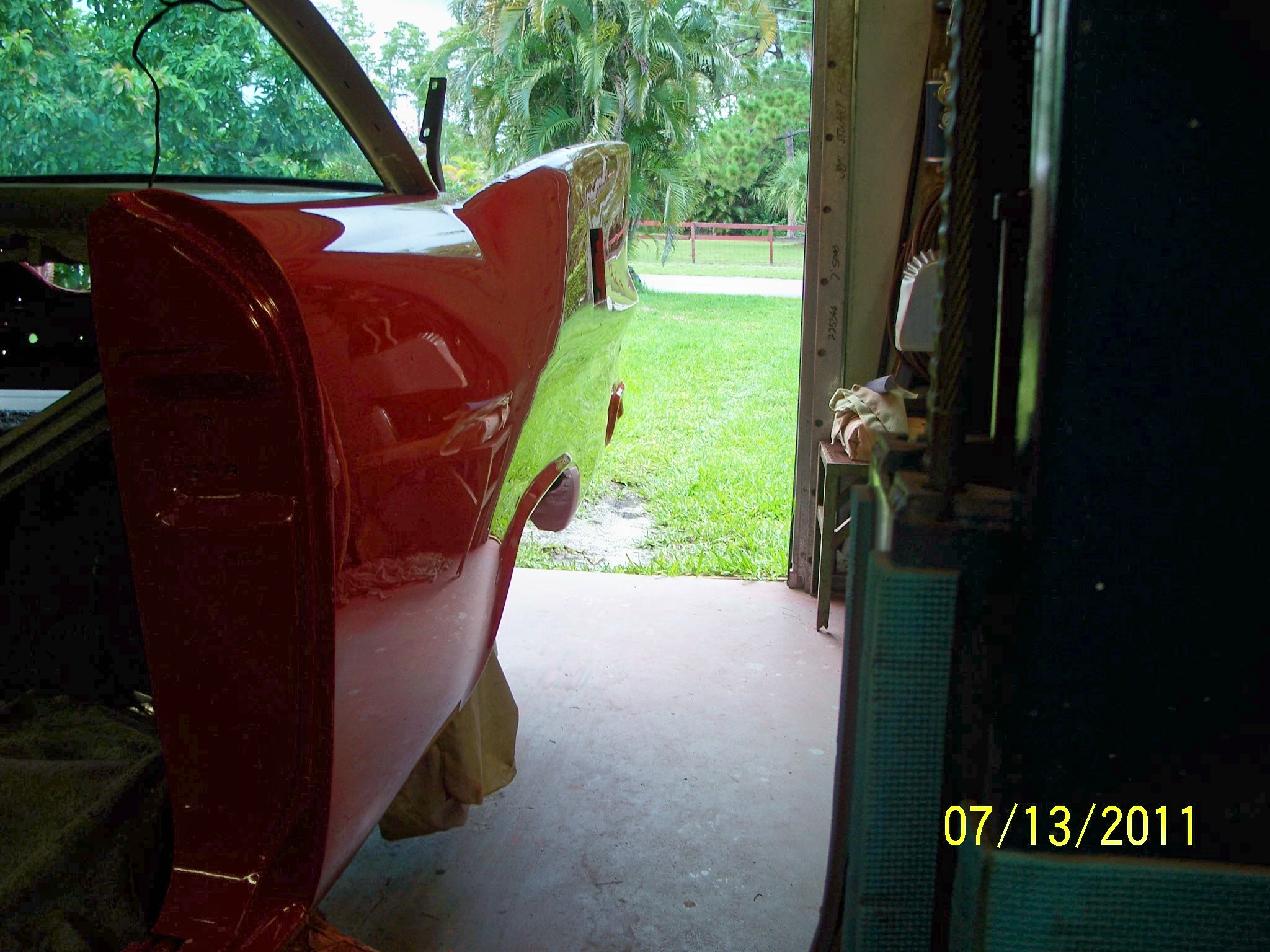

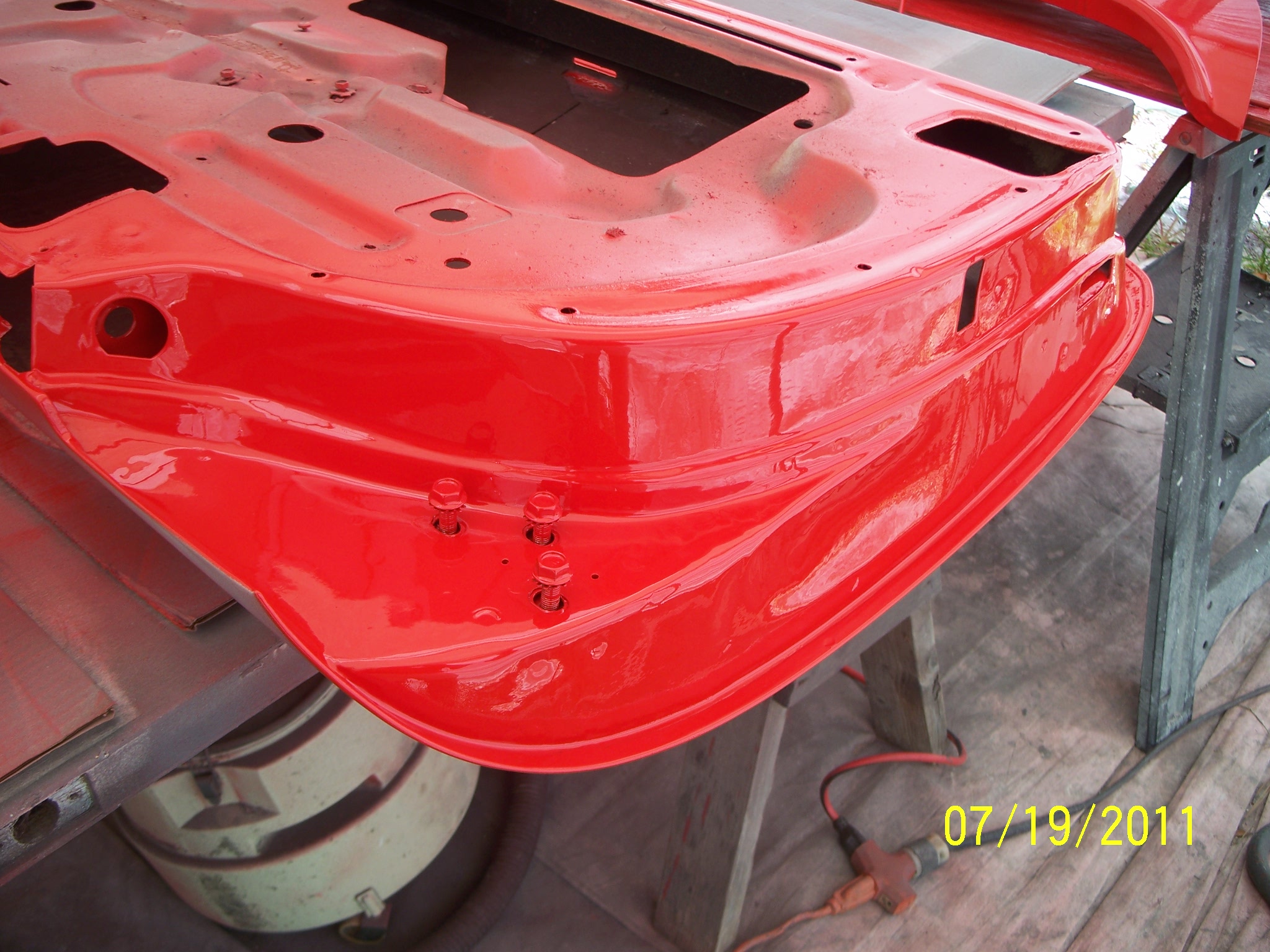

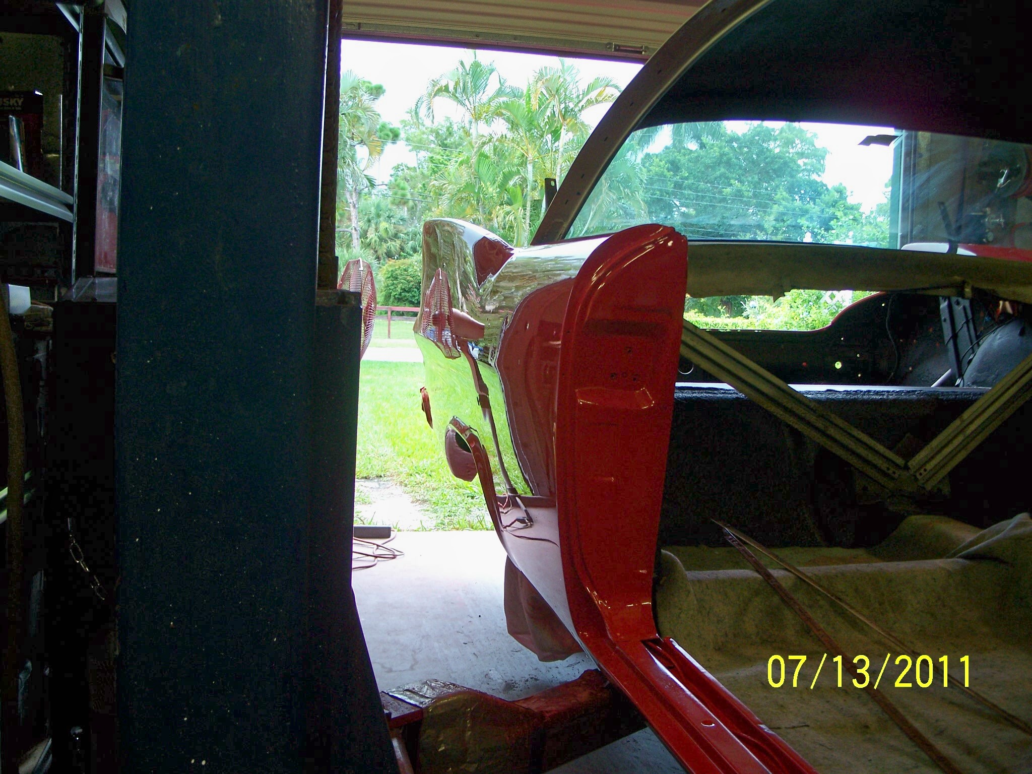

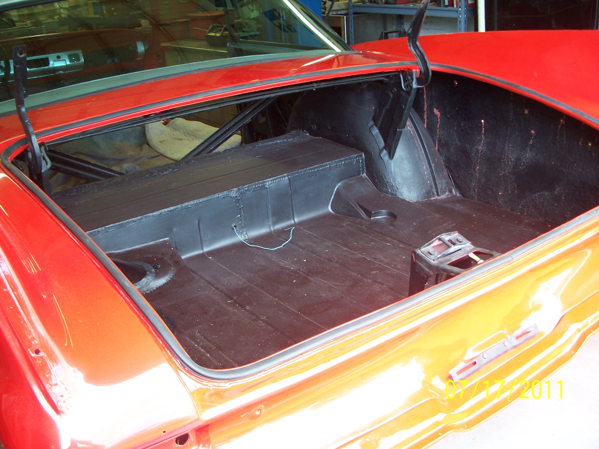

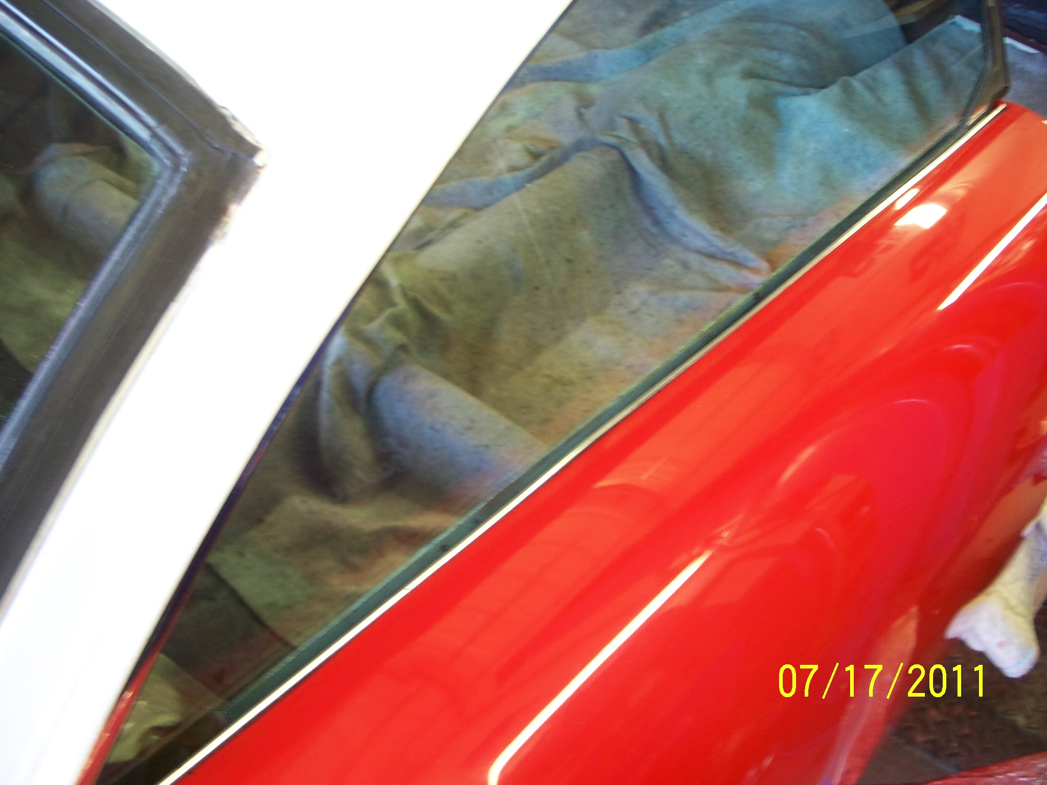

Mo pitchuhs, It's so nice being on the downside of this project. After painting I wet sanded and buffed, check out the reflections in those fenders, next I installed the outer fuzzies using the correct clips from Gary Goers, snapped right in. Next I cleaned the quarter window regulators as best I could and applied ample amounts of white grease to all the slide channels and regulator teeth. The windows go up and down so easy it' scary. The hardest part was replacing the window edge rubber because there is a screw on the underside of the window frame that holds the bottom of the rubber (it protrudes backward) in place. You have to lower the window and reach your arm up and blindly try to find the screw (I used a dentist mirror to find the screw in the first place) to loosen it and take it out. The hole for the screw was about 3/8" to far forward so I made a new hole with my leather hole punch and again blindly tried to find the screw to tighten it. The long part of the seal is easy to put in. Next I installed the inner and outer gas tank fill tubes and sealed them tight. I also installed the rear valance (splash guard) I got from John Fowlie (thanks John). It was originally spot welded to the car but this one got bolted on. I next installed the trunk rubber weatherstrip, it's grooves fit in the channel nicely so I'm wondering if it's necessary to glue it it. (your thoughts please). Yesterday I prepped the fenders, doors and skirts for painting on the edges and inside areas. Today I painted them. I will let cure for a couple of days then paint the outsides. I'm getting better at painting but some light orange peel is still showing up. Oh well, wet sanding cures all.
SEE THE FUZZIE.
HOW YOU LIKE DEM HOMEMADE CLIPS.
REDDIES SKIRTS MAKE HER A SHE.
