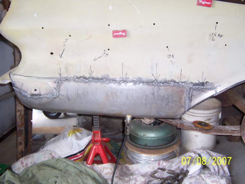

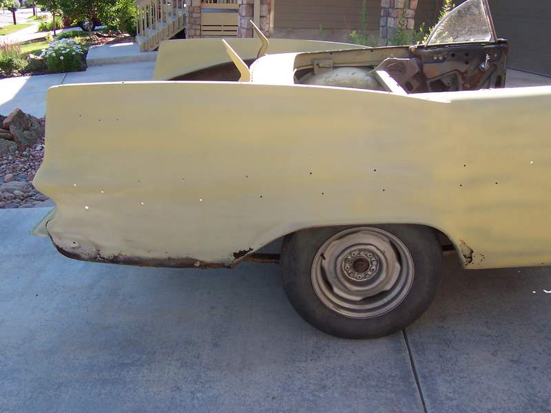

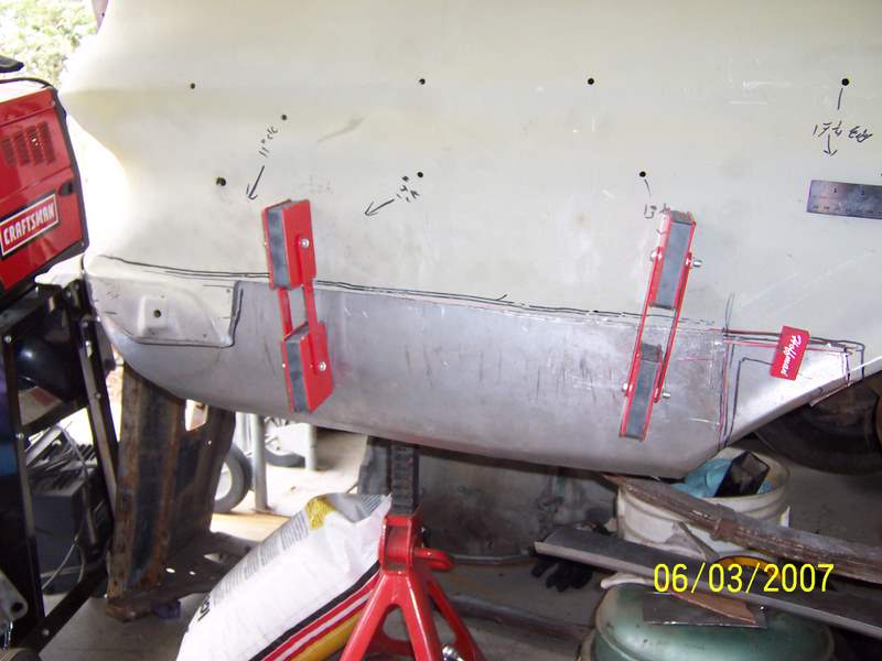

Since it is a slow Sunday morning, I thought I would post some pictures of the work I had done on the convert before it had been painted.
I am not a good welder but anyone can start with a wire-fed Mig welder, a good grinder to clean up bumpy welds and a litlle metal impregnated body fill like Metal-Fill, you can do a decent job.

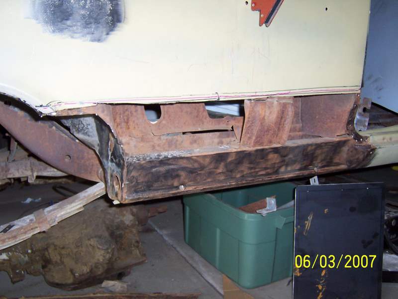

After media blasting, left rear quarter and in front of Wheel well needs replacing
Cutting the area in front off for patch panel reveals inner quarter window support.
out of sequence on the rear quarter area, picture 4 shows that two panels that had to be joined together to make the full width needed
before welding of the patch, wrote on quarter panel neeed distances of points that made sure panel was where it was suppose to be located.

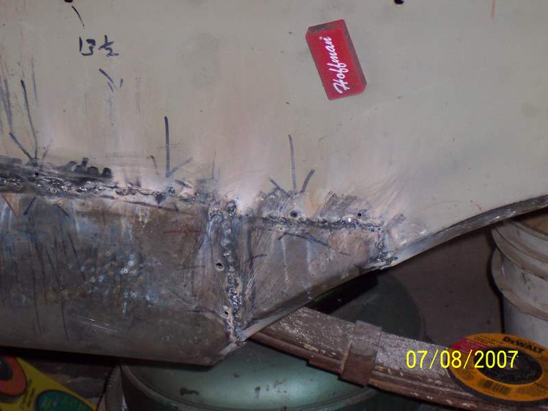

Post welding but not grinded smooth yet...

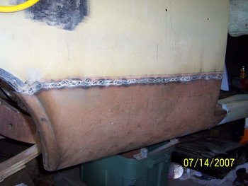

Did much better on the welding after learning on rear part repair. less grinding on this one.

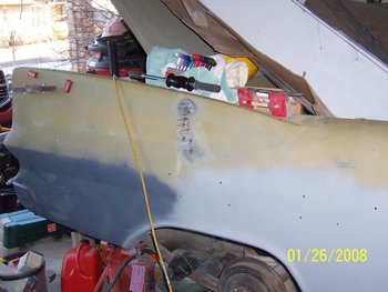

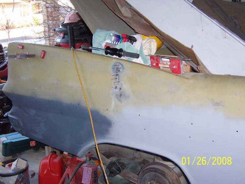

Finshed grinding, applied Metal Fill to smooth joint and applied some primer to see if I how it looked. Started work on high dent near top of quarter that needed a welding stud gun to pull out dents. This gun is not expensive and was around $80 at Harbor Freight. Pulled this dent out and used Metal fill to smooth contour.

Your welding looks very good and I couldn't have done it better myself! Keep posting pictures as your project is reaching the final stage, next year you can start cruising, top down and the wind in your hair 8) And I don't have to say that your drop top looks drop dead gorgeous 8)
