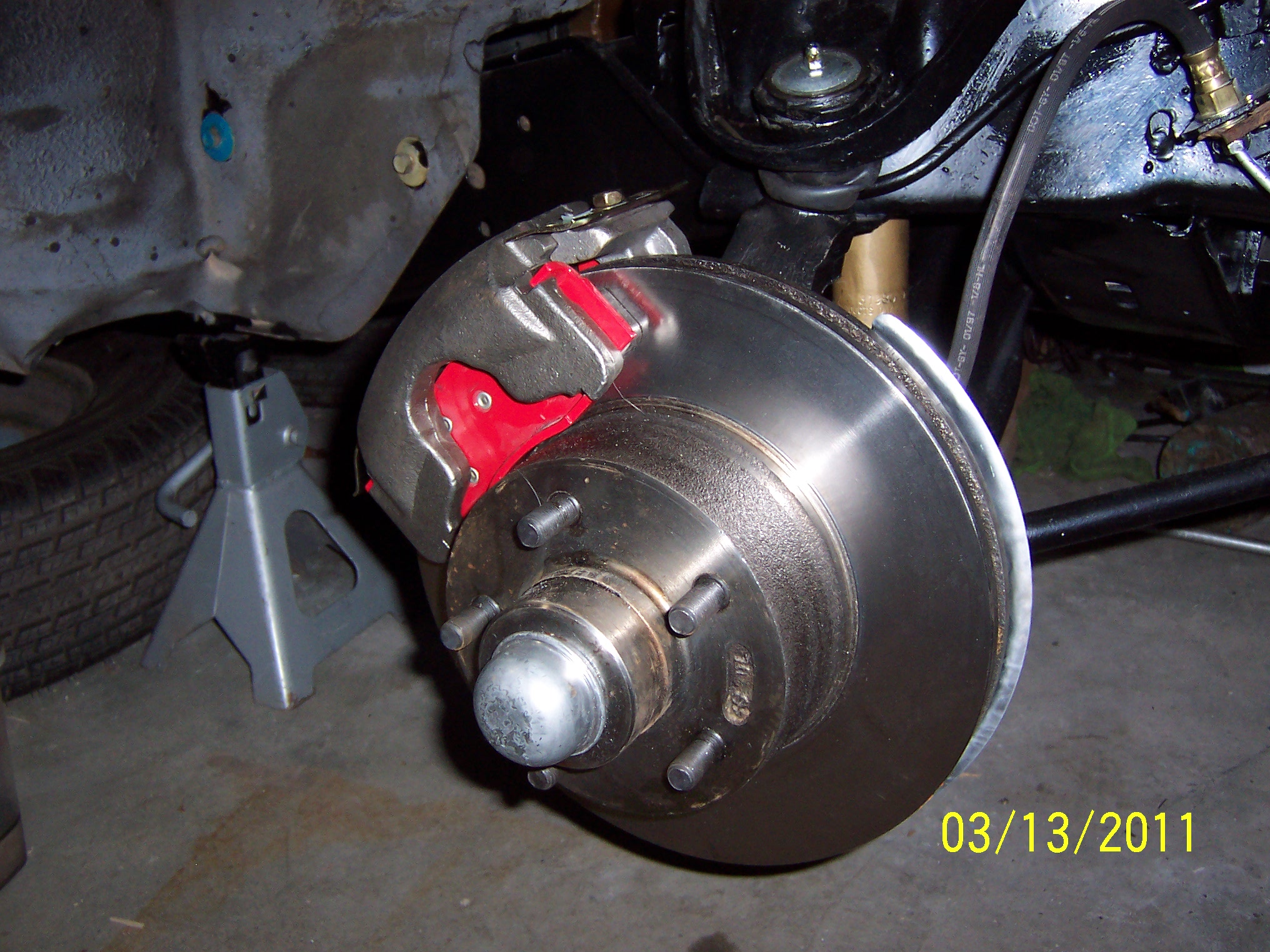

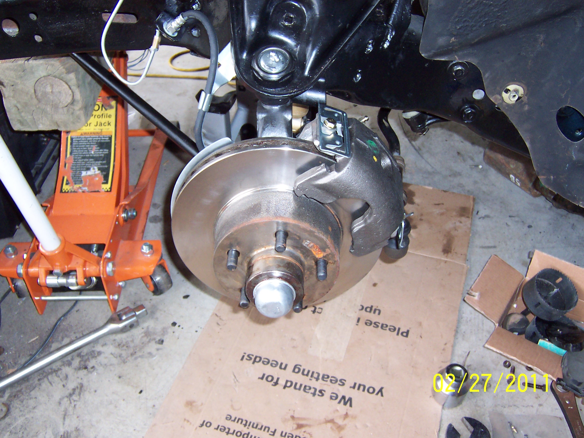

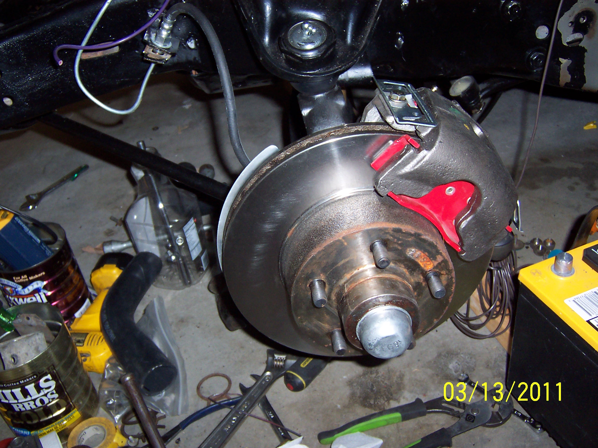

As some of you have seen in the Mini-Chat area (where I have been using it as a mini-Twitter reporting) I have been working on converting the front drum brakes over to 1978 F body (Aspen/Volare) spindles. Wanting to keep my Convertible as Mopar as possible I tried to use these F body spindles/Caliper brackets that a gentleman on the Forward Look Site (and Ebay (Tuckyman is his handle )says he used on a 57 & 58 Plymouth.
I have done a couple of these conversions on e bodies and B bodies with good results using 73 -75 Abody parts and late 80's M body parts. Nothing wrong with AAJ conversions but wanted to keep it Mopar-ish.
Here are some pic's of the work and the final configuration.

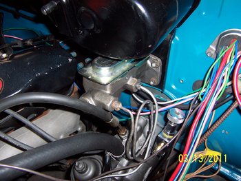

A body dual reservoir Master Cylinder, $65
One short section of brake line from MC to proportioning device, $15

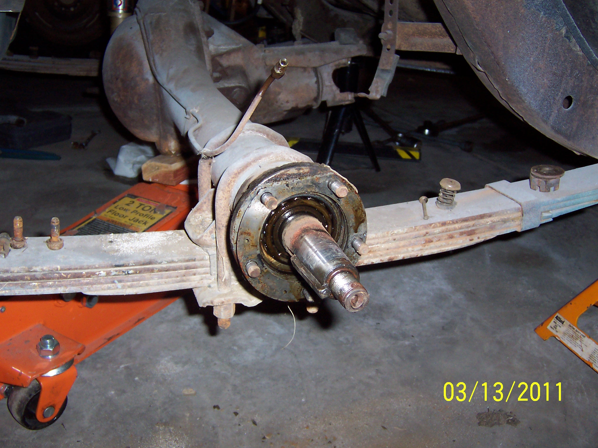

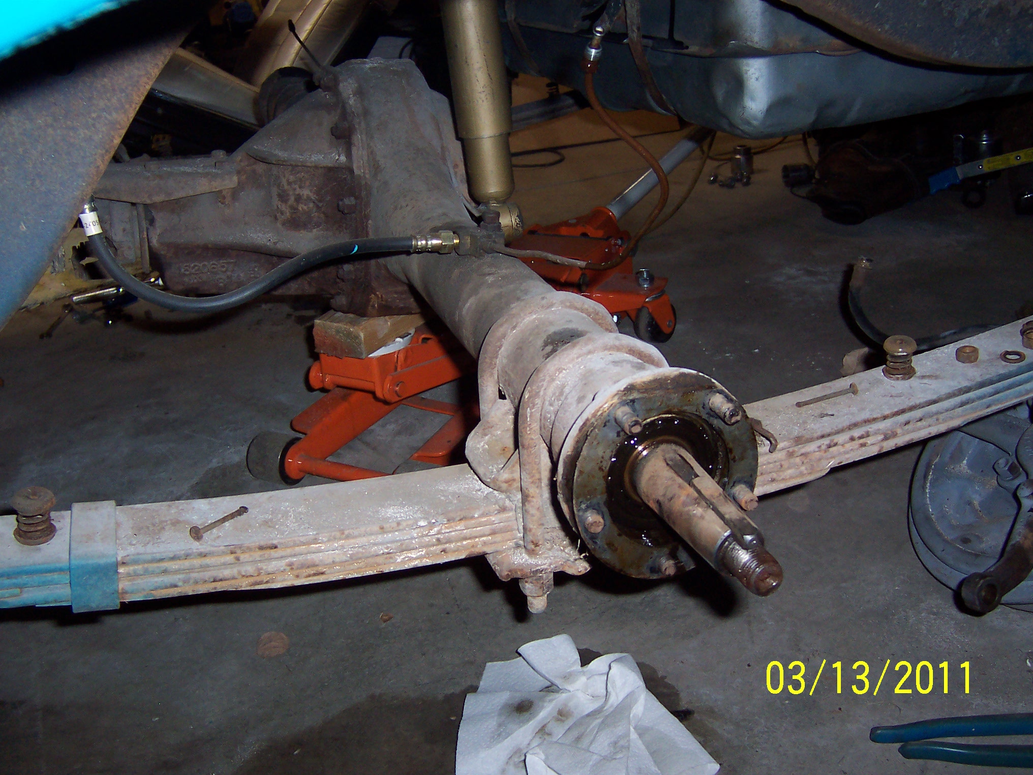

Continuing on this saga...I then tried to bleed the brake system yesterday and found that both rear brake wheel cylinders were corroded shut and could not get a drop of Brake fluid out of it thru the bleeder valve.
Put in a call to Mopar Rick (Rick Clapham) and he graciously loaned me his rear drum puller. Rick lives 15 mins from me and picked it up from his milkbox since he was heading out with his granddaughter to the Zoo.
Drums came off in 20 mins, With the right tools anything is possible! Cob webs galore and slightly crusty. Removed the corroded cylinders and brake shores etc from both assemblies, Ordered new cylinders from Autozone, be in on Tuesday.
Dropped off drums for turning at the local Car Quest Auto parts (they have the lathe) and was able to pick the turned drums up today.
Now, big problem, Napa, Car Quest and Autozone had no sources for the rear brake shoes. They are on E bay but will take a while to get here. Thought about a place in South Denver that deals in old auto store parts and today went there with my old corroded shoes and he says he has new re-lined NORS on the shelf, many pairs to be exact, So for $55.00 I have both sets of brand new relined brake shoes! Hot Damn!
Just need the wheel cylinders and I can re-assemble the rear brakes and go back to the bleeding procedure. Once done then I can put on the fenders and hood and terminate the headlight and park lights. Not saying it is fire up time, but with a couple detours...I am getting closer!
Here is a few pics of the rear axle area all disassembled. I turned up the axle brake lines to keep the fluid from leaking out to much, I only have so much kitty liter you know!
