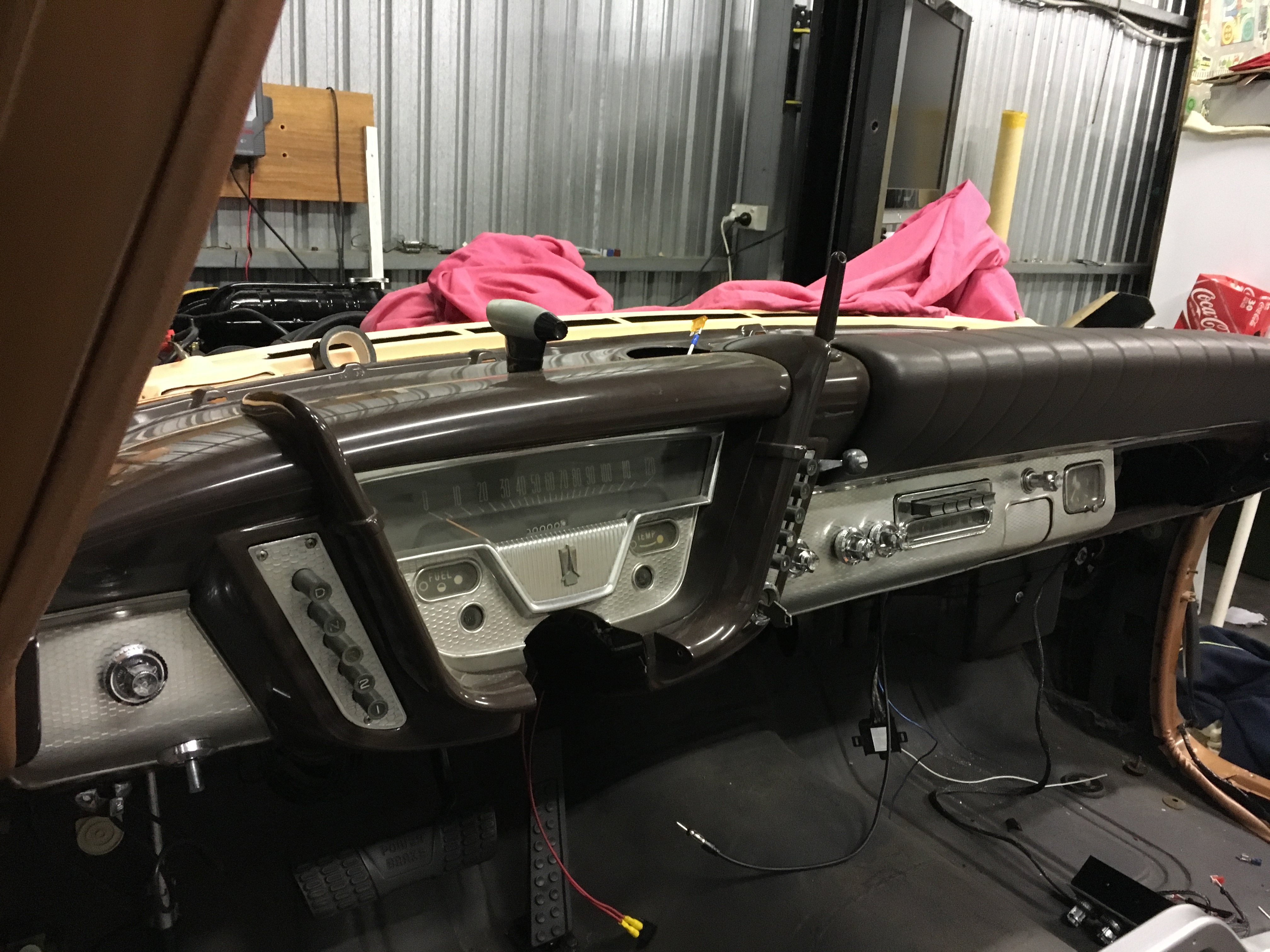

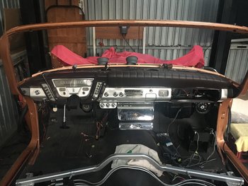

Some minor updates
Wiring pretty much complete and dash installed

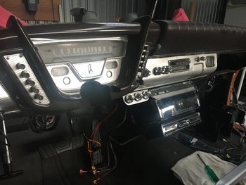

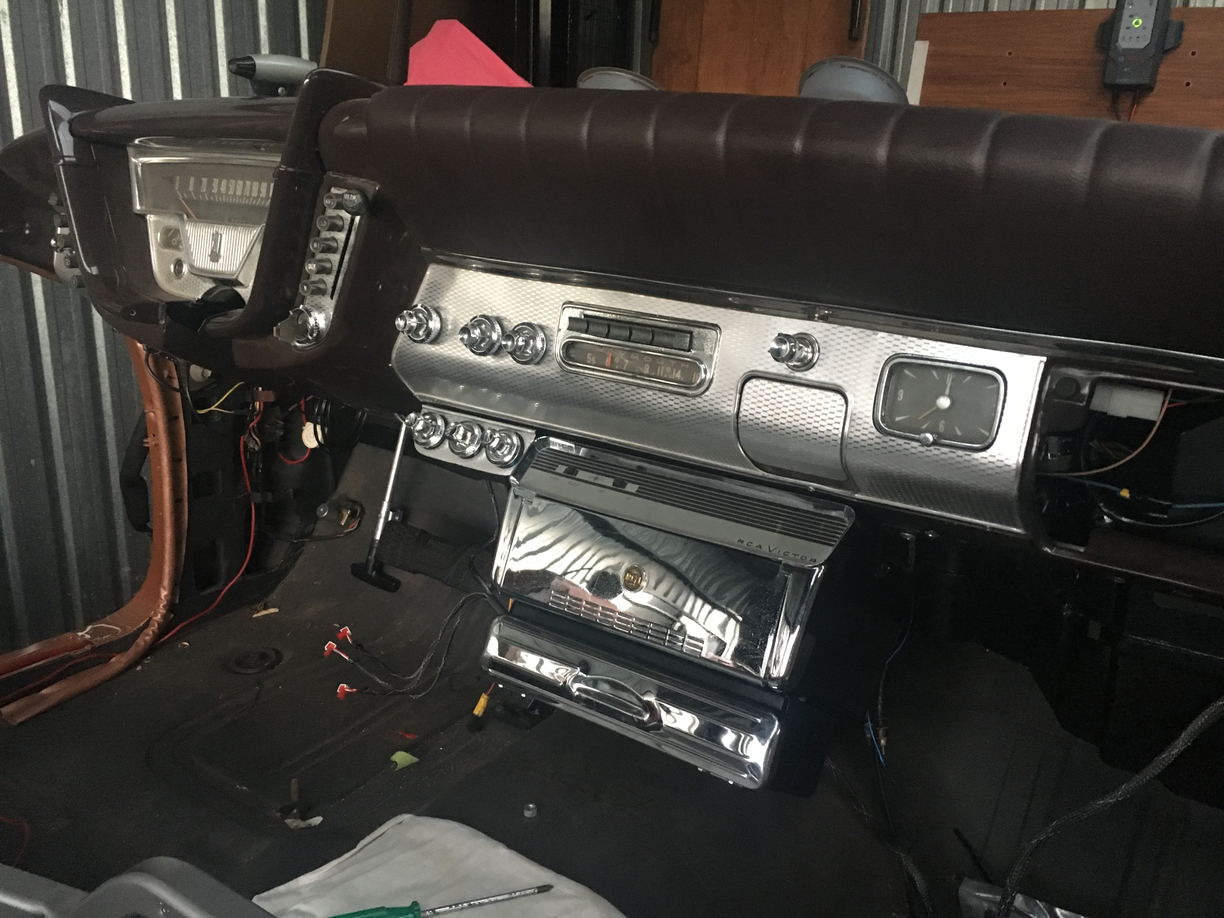

Hi again
An opinion if you please
Made up controls for the air freeze a/c unit to try and blend in with dash- thoughts ?
Record player - should I mount it level with floor or
Mount it at the same angle as the base of the dash
Any criticism truly welcomed- not sure if it's going over the top
Also I'm unsure how to wire up the windshield washer pump wiring to the windshield controls
The controls are variable speed and only leave two connections once you connect the motor
The foot controls have 4 connections
Any idea? Can't find the details in any of the manuals
I assume that if connected when you depress the foot pump it automatically controls the windshield wipers?
Record player level with floor
Record player inline with dash angle
Customized a/c controls
Matthew Keij
Posts: 1407
Re: little by little
Post by Matthew Keij »
I'd say level it with the floor. Looks better.
It looks like there is too much going on when you put it in the dash angle.

Got my mirror back and its working
Also installed the speaker grille and ac outlets that came out of a desoto
Pretty happy with the airflow from the Vintage air unit
Ac outlets pop up and swivel

vic barone
Posts: 164
Joined: Mon May 08, 2006 4:50 am
Location: Adelaide South Australia
Post by vic barone »
Hi Dick
As I didn't have a/c and my heater control was shot I opted to go after market
I ended up installing aVintageAir GenIV that has heating, cooling and demister
I have connected the 4 air outlets to the dash grilles that will be both air and heat
The unit has electric motors that regulates the air flow between air and heat
The draw back is that I've lost the glovebox as the a/c unit takes up all the space
