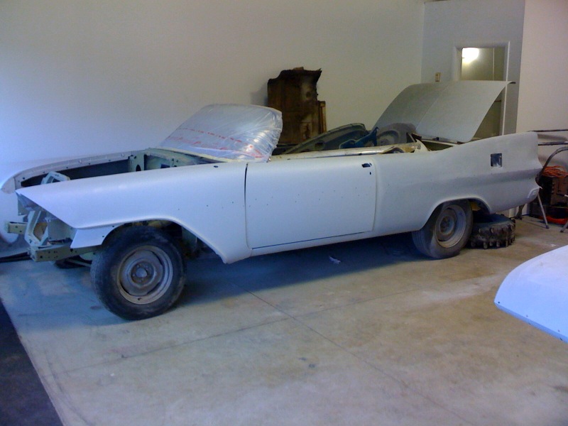

It'll be totally worth all our efforts. And even nowI don't know the total price yet I think that it will also be worth the amount of money i invest in it :)
The colour scheme will be exactly the same as it was. We have thought about painting it the origional iceberg white but I do like the red too much for that. It will get another option after my trip to Philly this summer, a pair of newly rechrromed bumper wings are waiting for me 8)

Oh yes, from the Texas a/c car. You will be very happy with them..they add a lot to the overalll appearance.
Are you set for trim? you had one damaged insert and something else?
Posts: 5044
Re: repaint!
Ohmigosh, Ron, it looks like it got snatched from the factory floor. I can't wait to see more pix! I swear I saw those bumper wings in the basement twitching...

Ron, Looks great! The panel replacement work was masterful! Truely craftsman at work! Teh car comes together well with a uniform Base coat of Primer on it! Looks like you will be in paint before my convert is done. We finished the 2nd block sanding on mine on Friday night and hopefully Saturday we put some turquoise on my 59.
I have the 413 RB done and am detailing it now, This 413 has AC on it so the brackets are all mixed up! Alternator on the Drivers side and AC on the passengers side. It was a 1960 413RB out of a New Yorker. I am keeping the AC to have an underdash delivery of Cool air.
Keep the pictures coming of yours! I need to hustle to get mine done before you get here in June! :D
