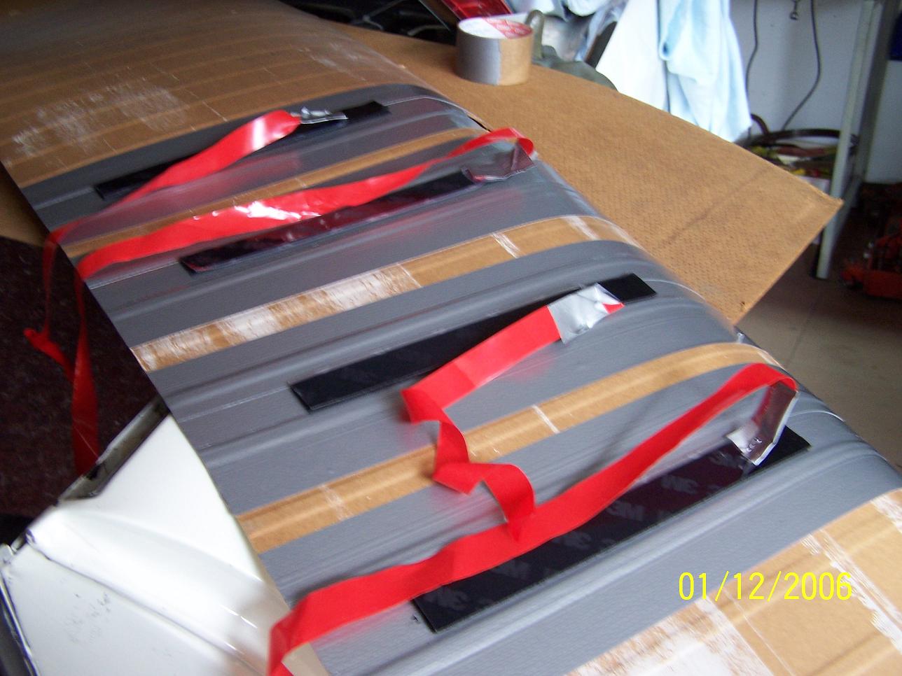

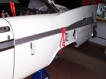

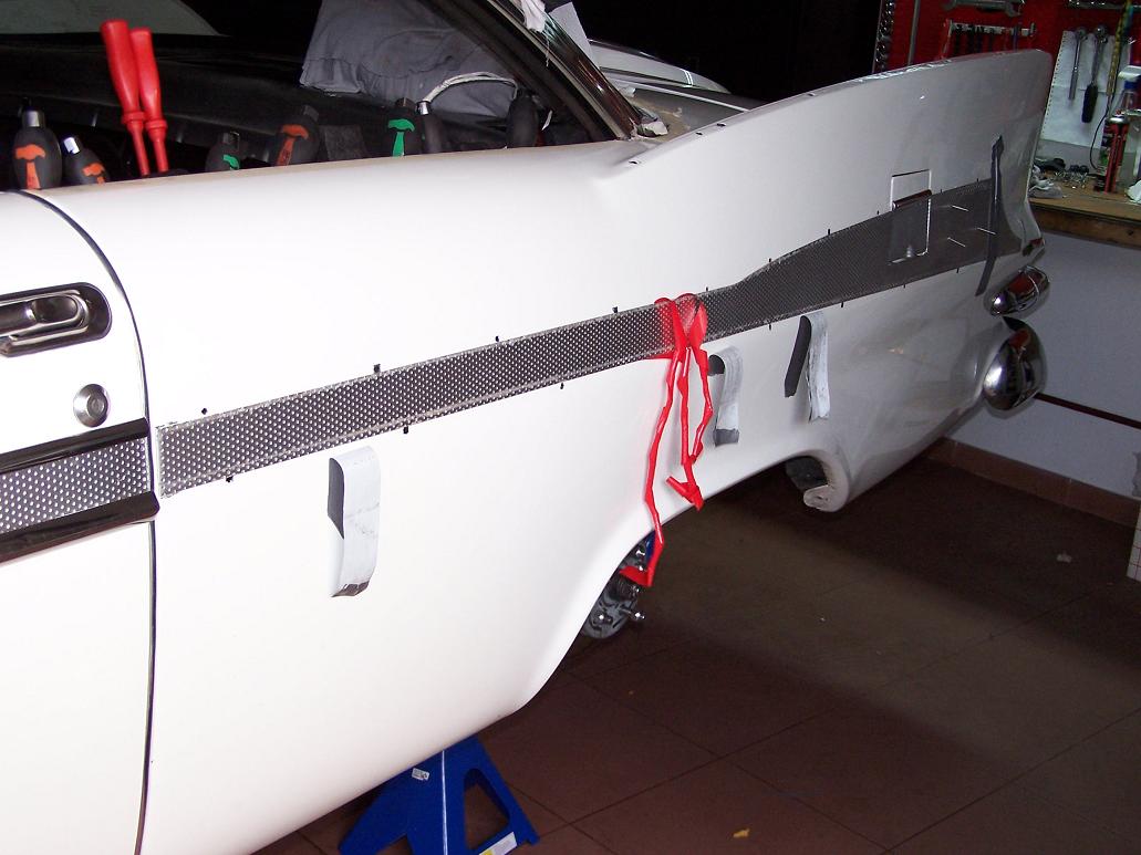

I haven’t been here for a long while. As you are doing a fundamental intervention allow me to make a suggestion: When you put the side trim on again the use a M3 double side adhesive in order to avoid that metal to metal contact. Even with good clips on the side trim it's moving a little when you drive on bad roads for example. Do that with all the side and roof trim and you will get a perfect result without clattering and paint scratching. If you want I can send you some pix. Second, I know it’s a question of personal taste, but I would close the holes of the rear antennas and place them more to the outside of the vehicle. When I see your car straight from the back, the rear antennas simply look too close together. The rest: More pictures please :) . Roger is right, it’s good to see somebody’s project!

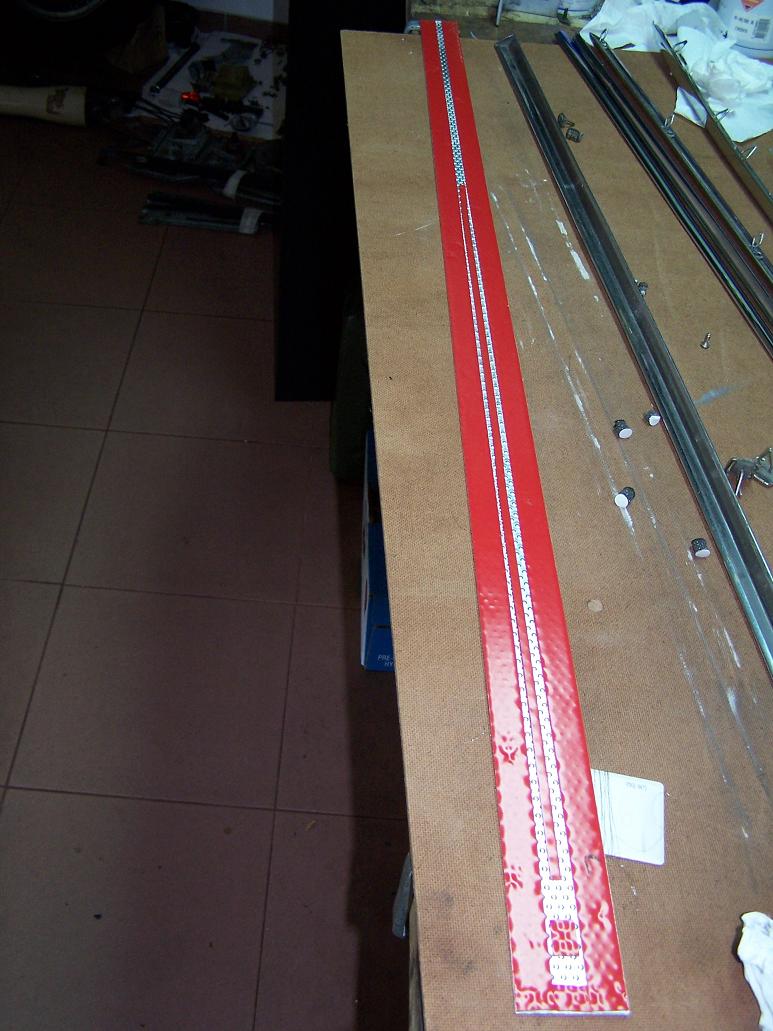

Here the pictures:
I used 3M double side adhesive band for automotive trims. Glued it to the back of the side trim, then I positioned the side trim on the car and then I removed the red protection cover of the adhesive band. At least I pressed the side trim against the car and that’s it. There is no place where metal touches metal, that eliminates the parasite noise and improves fun, really!

sportfury1959 wrote:Here the pictures:

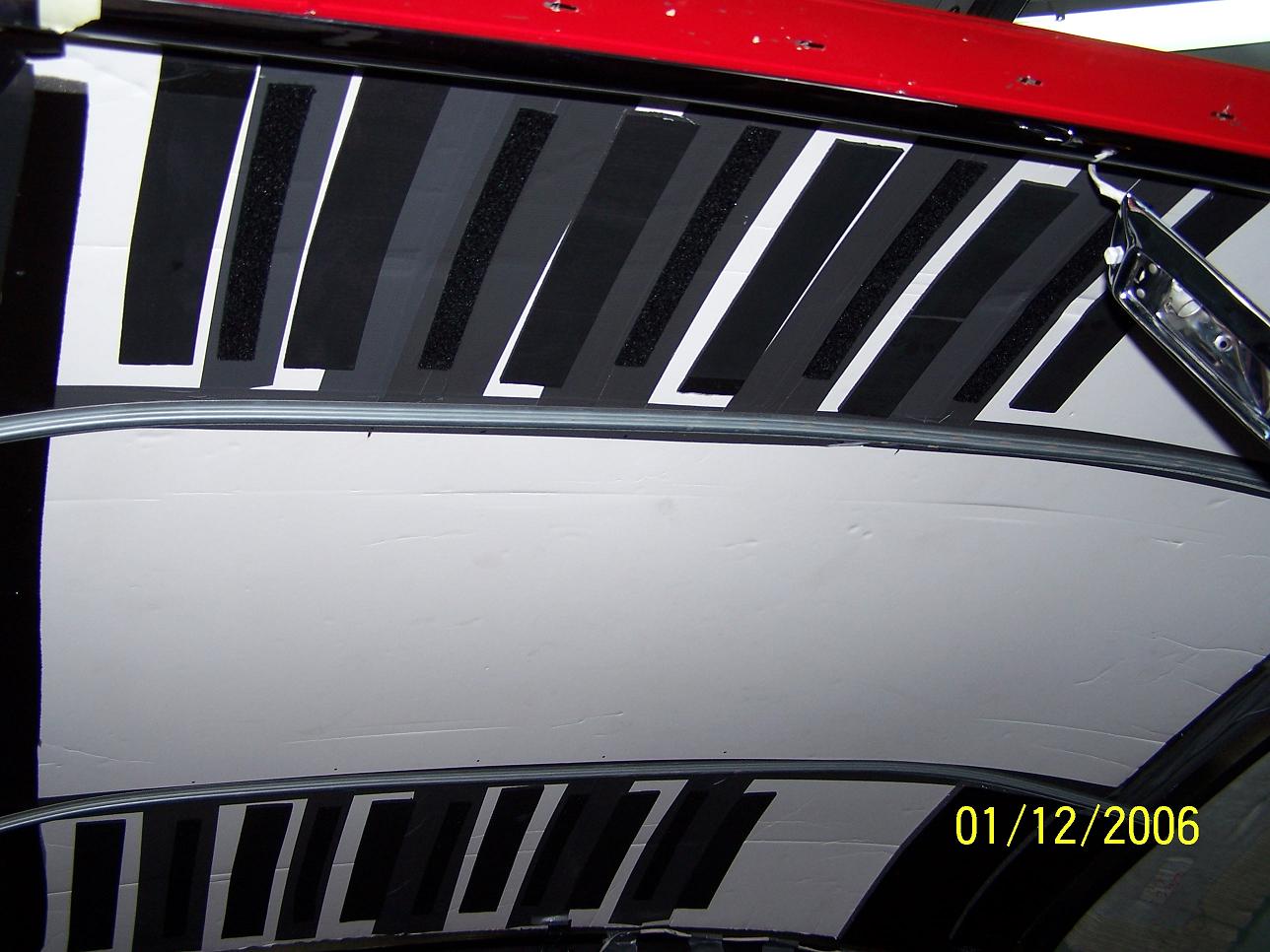

Good idea! I will check where I can buy the 3M adhesive band here. Did you also use some kind of insulation for the roof (inside) and the floor?

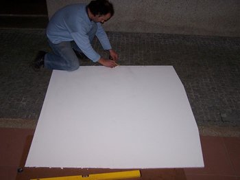

I have some tar pads on the floor. For the roof I ripped the old pads out and glued a new solid foam pad in. The glue withstands >100º. The saddler who did that job used the foam pad from a VW Golf and cut it in shape. It doesn’t really help against noise, but it isolates the heat from the roof and I can fix my headliner now with a Velcro band so it doesn’t fall on my head anymore!

Thanks for the info and the pictures! I think we'll use the foam pad from another German car, matthew works at the local Opel dealer and he probably can get the foam pad for a Opel Astra cheaper.
