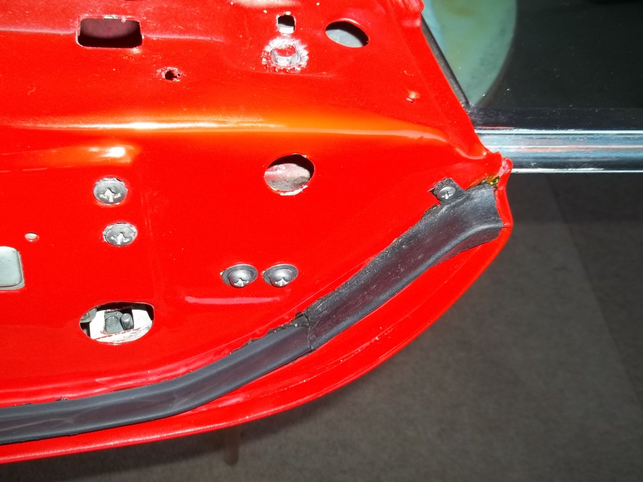

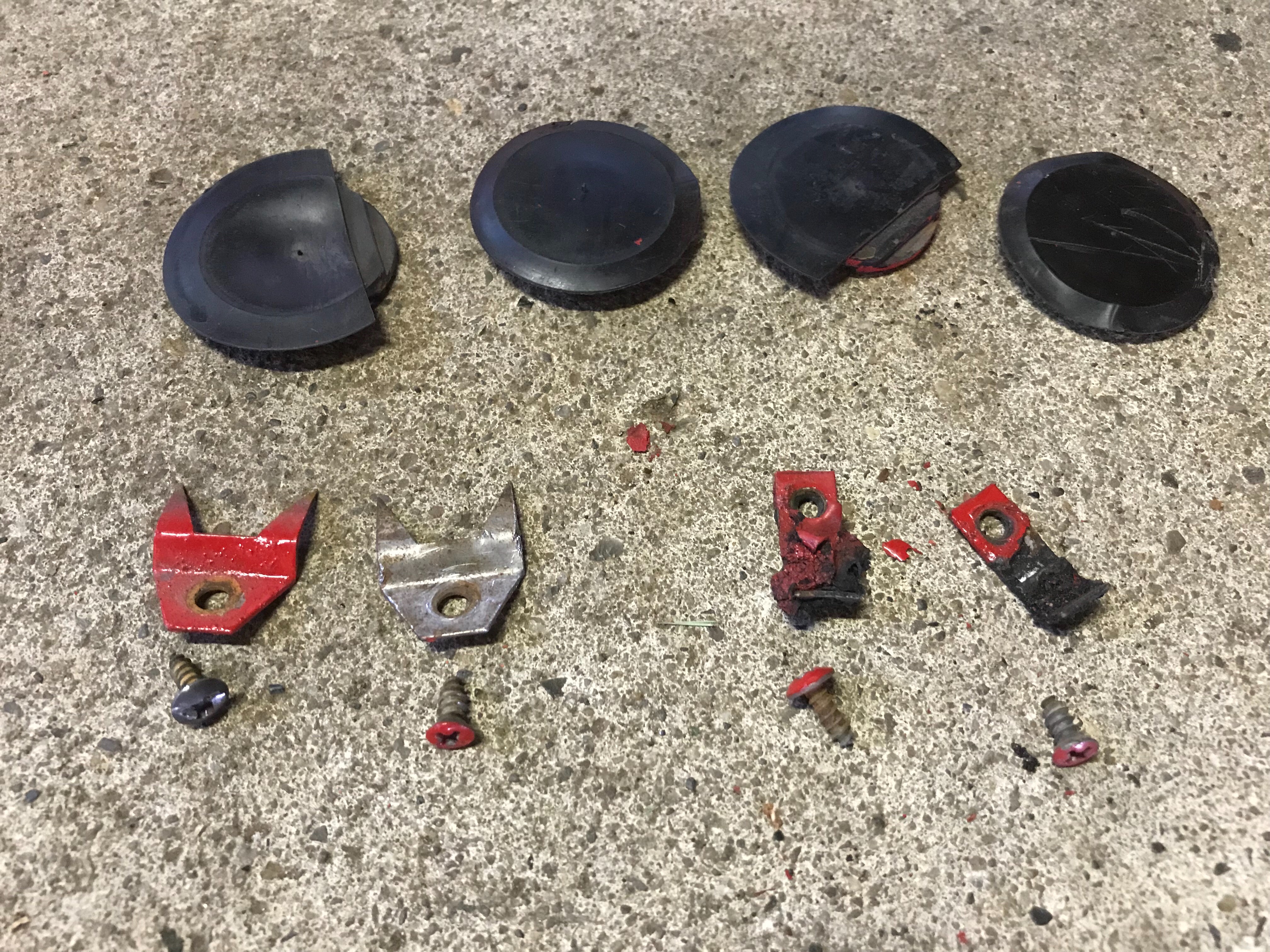

Oh Noes! I see a part I missed in ordering from Gary Goers - the weatherstrip ends that Dick put on Reddy:
I attribute it to poverty. I'm so poor, I can't pay attention :lol:
Oh well. I'll have to taper it, or something, at the edge and make do. Fortunately, I did order the right weatherstrip. It's been sitting in a box for 15 years :oops:

Well, what do you know! I remember the wide clips for the front of the door, but forgot the rear clips. I wish I could embed them somehow - maybe I’ll cut a slit and insert them.

Well, I gave up on trying to insert those end clips; I just ended up gluing it. It came out well enough, and the doors have that solid showroom door-slam sound.

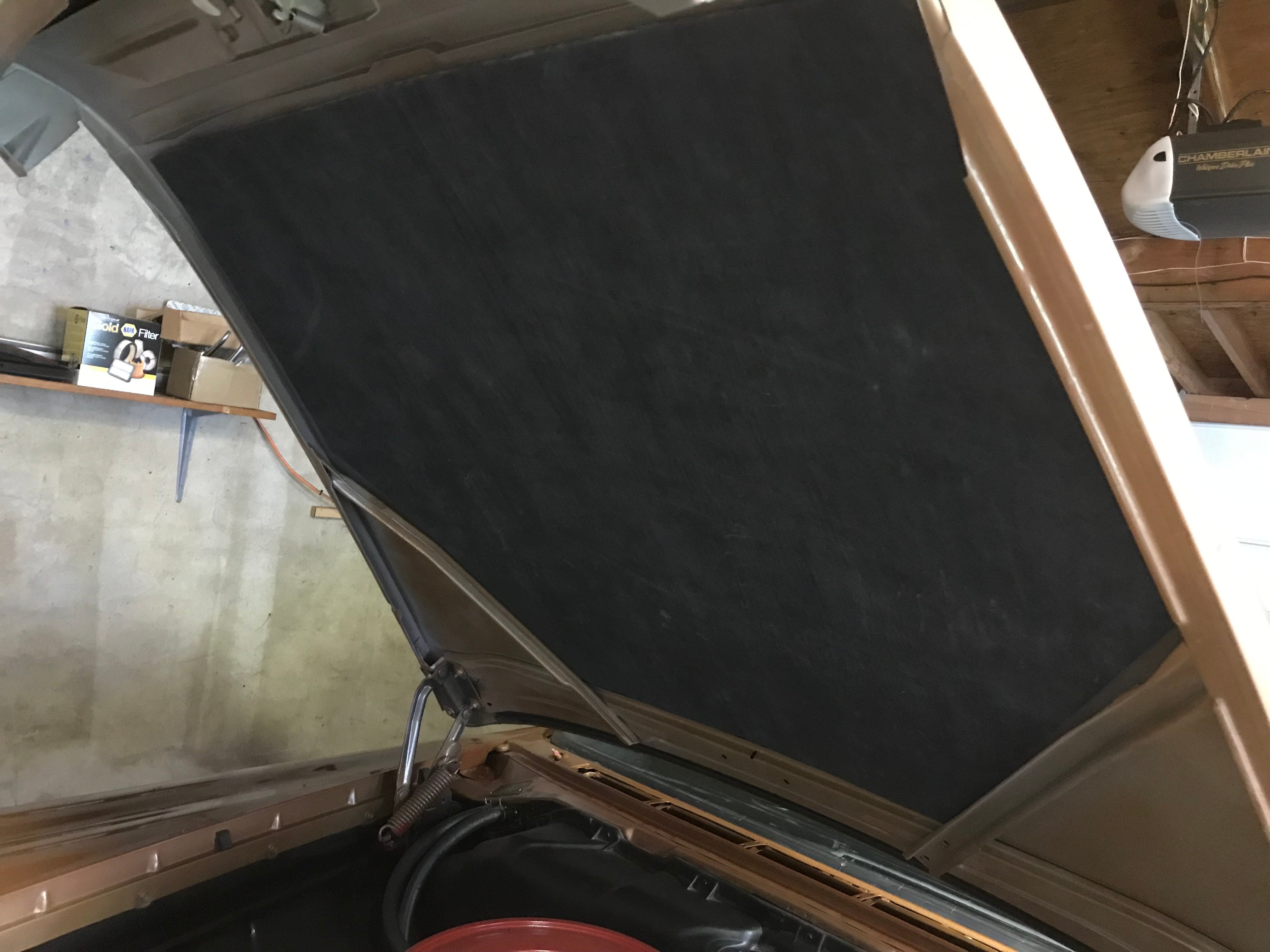

And, I got the hood pad installed - always tricky with that 3M spray glue, but somehow I got it right the first time.

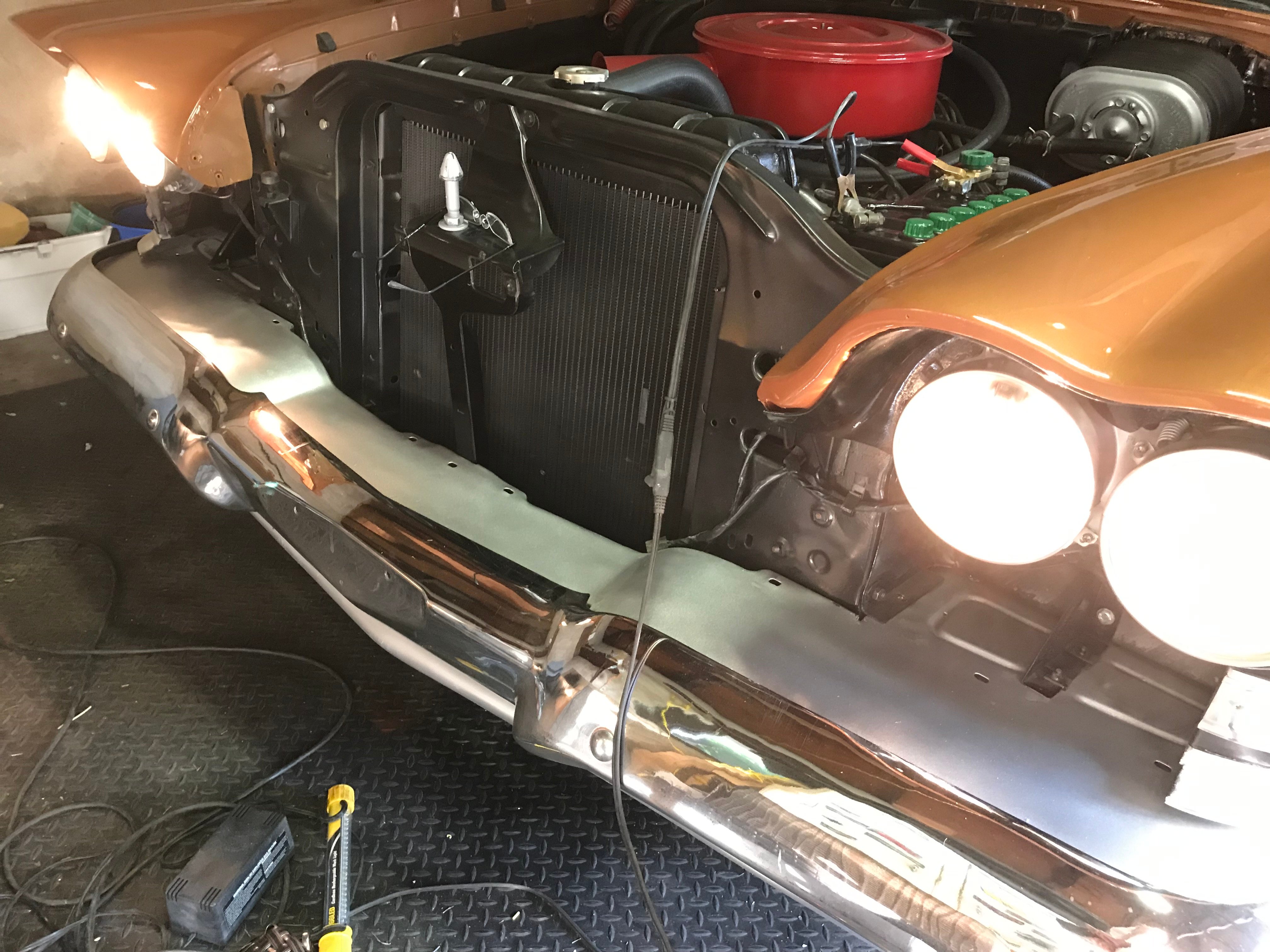

Tomorrow, Faulkner goes back to the mechanic to get the tailpipes right - they couldn't set them properly because the bumper wasn't on, even though I gave them a picture of Dick's car. I think it will probably take extenders to bring them out to the bumper, but I'm OK with that. And, while they're at it, I'll have them adjust the emergency brake. Shoes first, then the cable - and, I have a NOS emergency cable if needed. So tomorrow I'll finish touchup on the interior, and other miscellaneous tasks. With any luck, I'll get the car back in time to remove the tires, because Wednesday is whitewall day. I guess I better paint the wheels tomorrow night, then... Hmmm: What color?

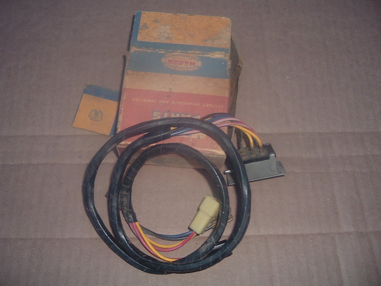

I dropped the car at the shop for the emergency brake/tailpipe fix, but now I'm scrambling to find a wiring diagram. The foot pump switch must jumper out the dash switch when the pedal is depressed - i.e., the foot switch is in parallel with the dash switch, not in series. But why does it have so many doggone wires?!? Anyone have a diagram, or know where I can find one? At this point, I just want to disable the thing. Perhaps if I remove the switch from the pedal, it will stop... I think I have to ground the switch, though. With it hanging underneath the dash, I had the problem I describe here.
Posts: 4049
Re: Faulkner gets a Redo
Post by Faulkner » Tue Jun 25, 2019 8:44 pm
I found this pic on this website:
That's the part - it looks like I ought to be able to disconnect it cleanly, but first I think I'll remove it from the pedal and ground it, in hopes that will render it inoperable.

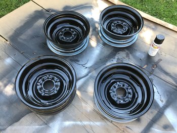

I spent the day cleaning, sanding and painting the wheels - tomorrow, I'll drop them off with the Cokers for mounting and balancing.
It got a tad warm in the Faulkner garage today
Painted the back of the wheels first
Oh Noes! I ran out of bronze paint. Oh well, I've got some argent, I guess I'll use that

A miracle!!
I took the switch out of the foot pump, and turned the ignition on. As before, the wipers ran continuously. Then I pushed in the plunger...
...and the wipers parked. Meaning, the switch goes in with the plunger on top, and with the activation lever on top! The plunger is normally depressed, and is released by depressing the foot pedal. It’s all working now!
Note to self: When partially reassembling something for a later date, and there’s two ways to do it - do it the way it came apart. Or take a picture! :x So mad at myself for the time I’ve wasted... at least, we can drive to Carlisle without the wipers on in bright sunshine :P

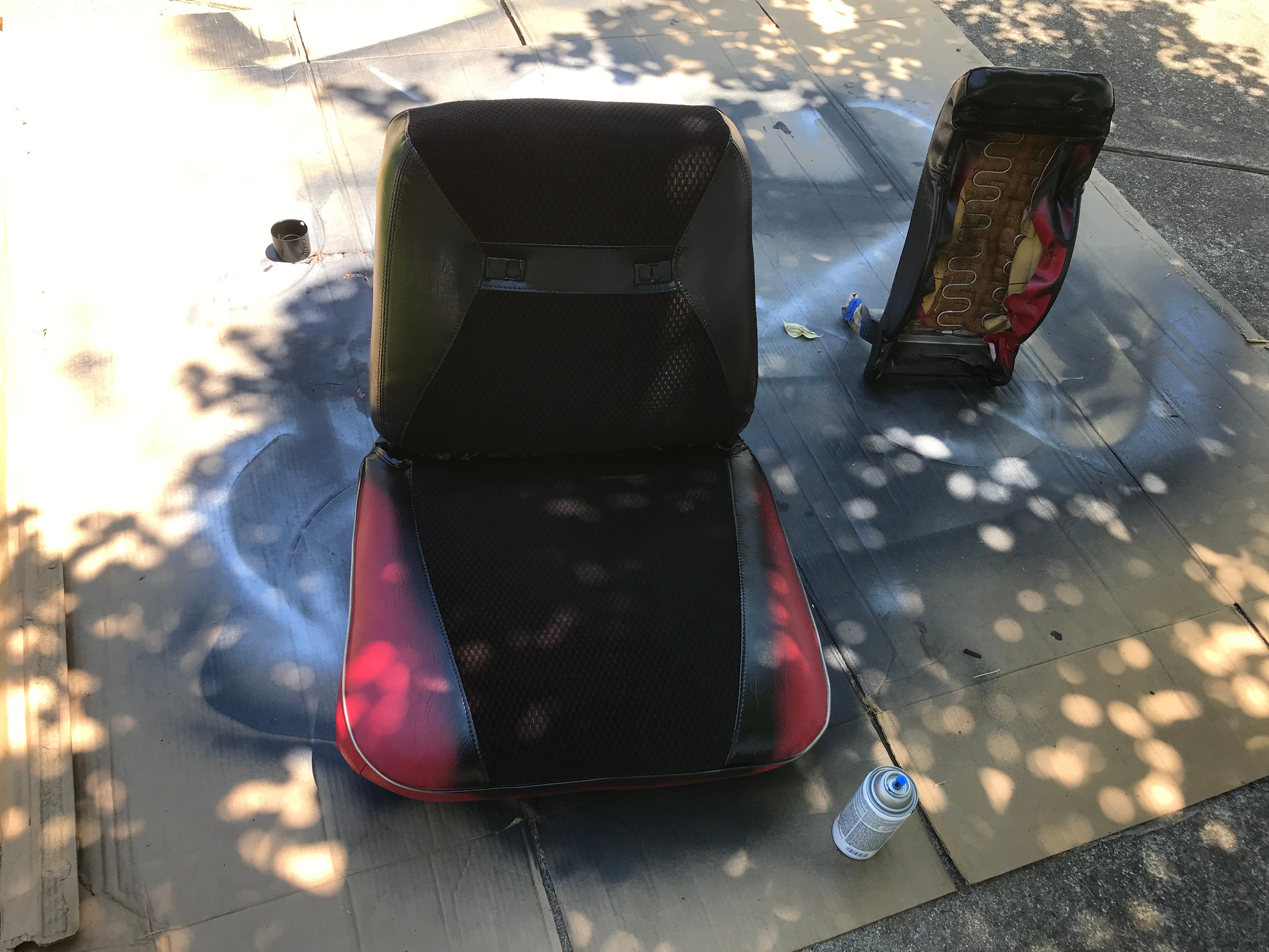

Now that Faulkner has no more shop visits before Carlisle, the front seat is out to finish painting. And, I found a nice clear lacquer spray for the vinyl I painted bronze - it dries quickly and has eliminated the tackiness. So I guess I'll finish with that.

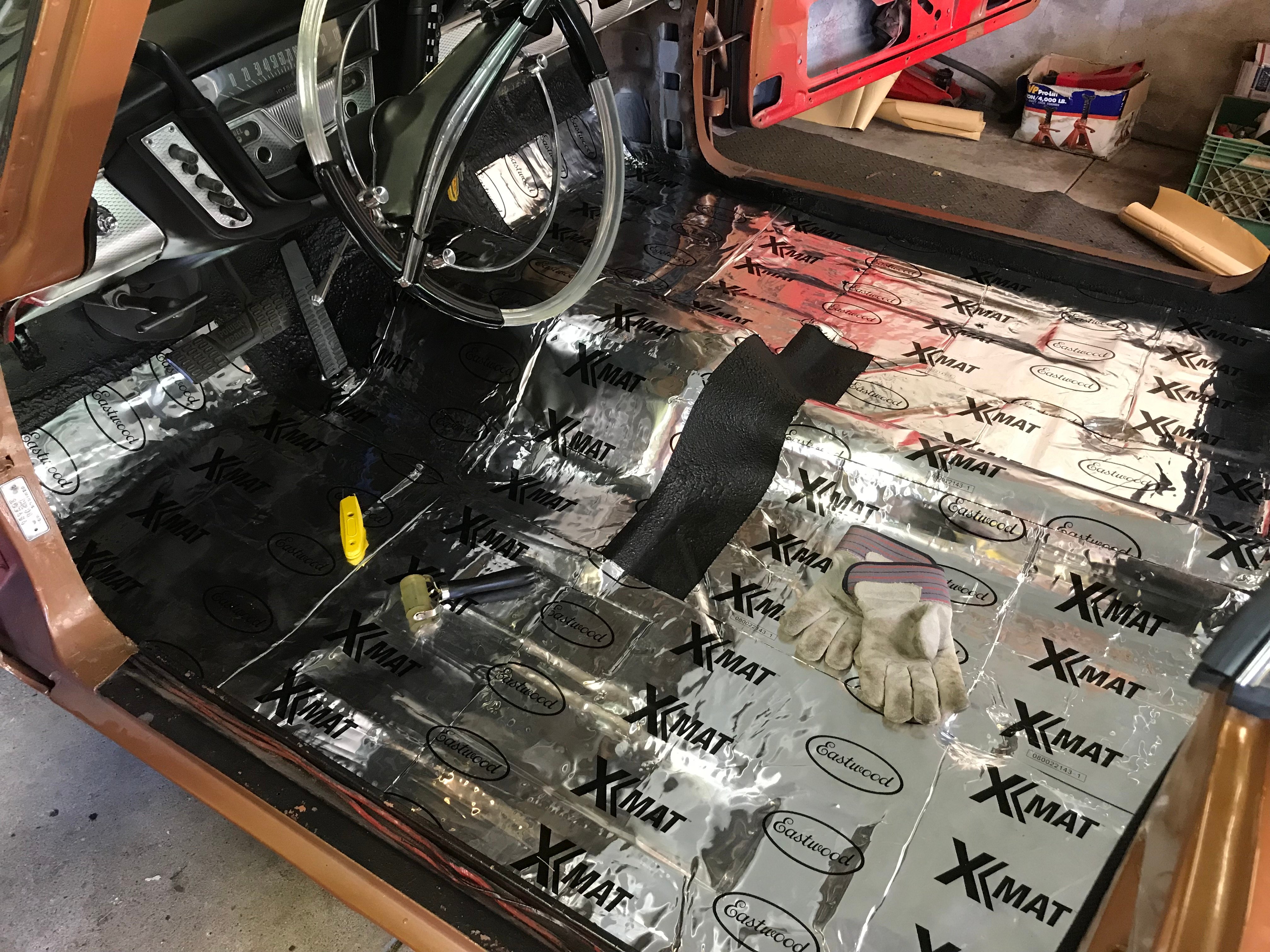

Post by Faulkner » Fri Jun 28, 2019 9:19 pm
Today was X-Mat day. I remembered what Mark said about the razor sharp foil, and how you have to be careful so you don't cut your fingers.
Unfortunately, I remembered after I cut my fingers :o :x That accounts for the gloves in the second picture.
It got so hot in the garage, it was all I could do after the X-Mat to simply lay the carpet in, before calling it a day

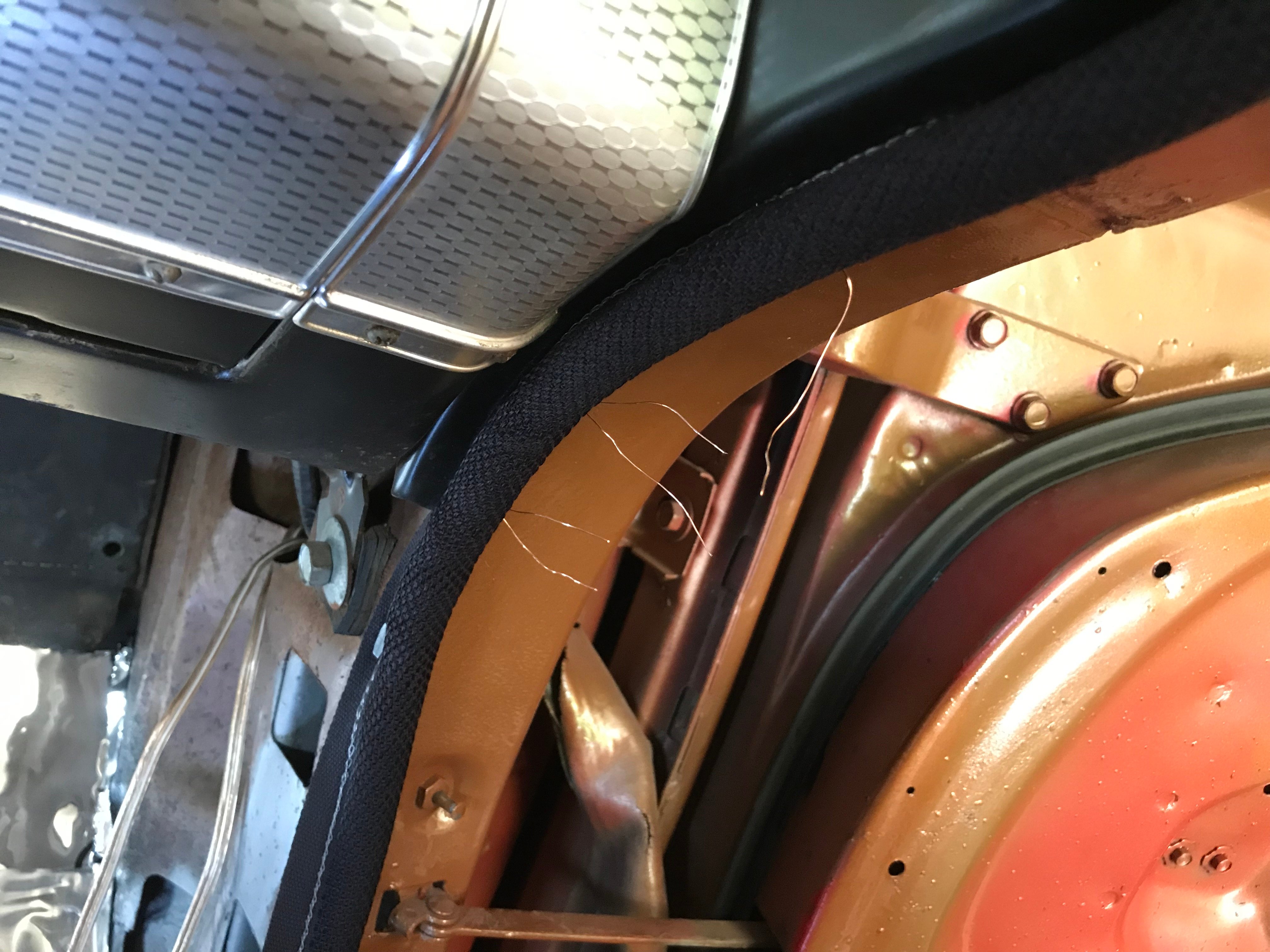

I finished the windlace today, using the patented Mark Merritt method around the dash. In my case, I used wire strands, fished them through the clip holes (after removing some old clips!), and pushed them through the windlace, then twisted the wires tight:
Doncha know it worked! Thanks for the tip, Mark.
