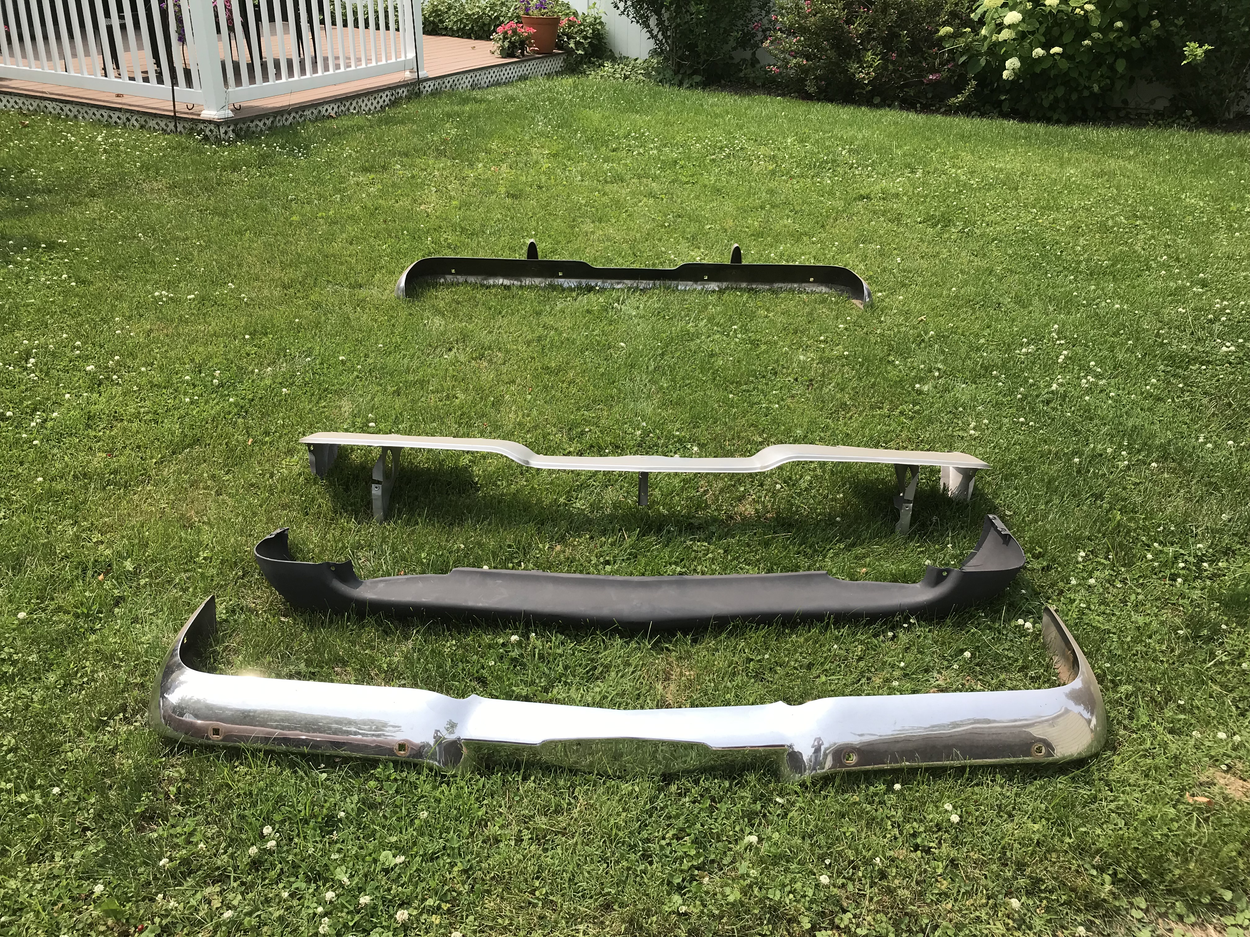

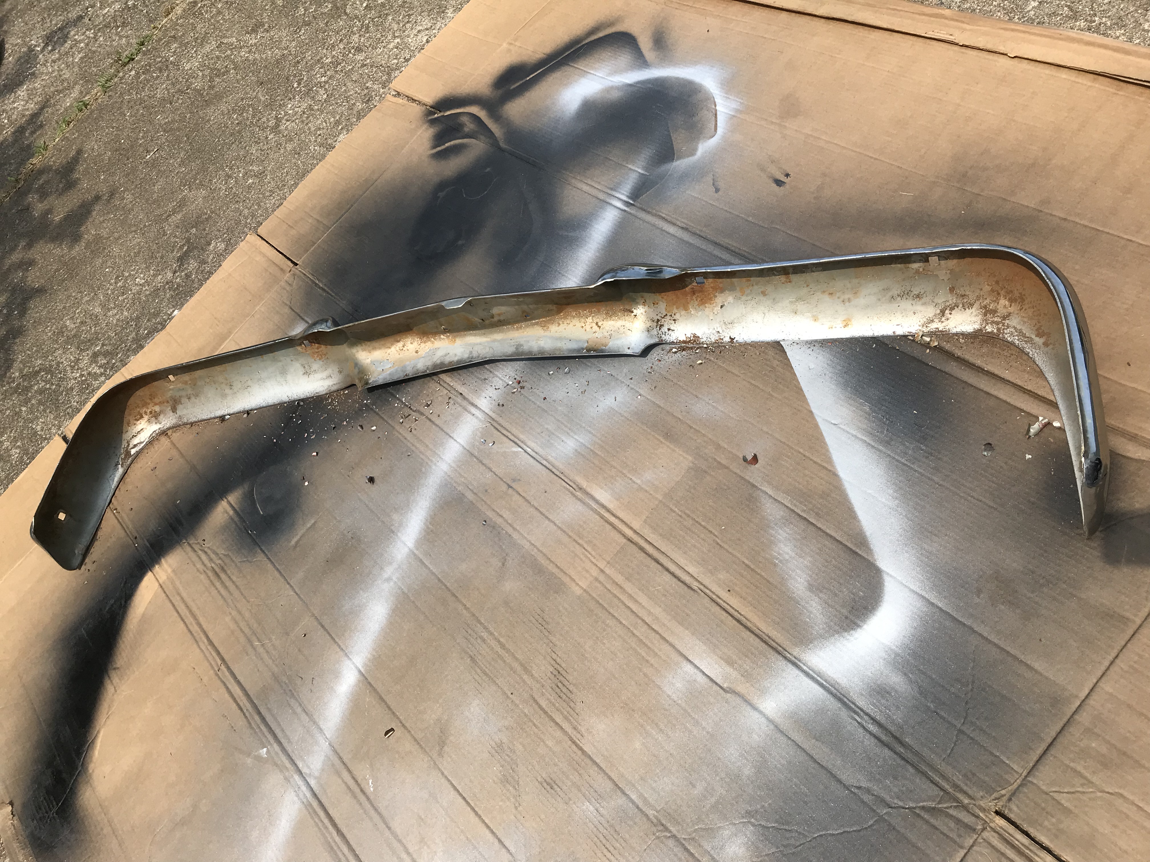

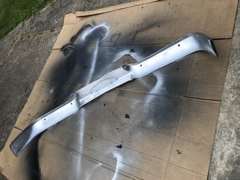

This allowed me to get the bumpers, valence and splash pan down from the upper garage shelf. Oh yeah! I have to treat and paint the inside of the front bumper where there's a little rust. And, I have to paint the valence. Do you recall the brand name of the paint you used on the splash pan, Dick? Not that a slightly different shade would be all that visible... I'll be needing a run to the hardware store, methinks, for some bolts. I bagged and labeled everything, but I did snap a couple.

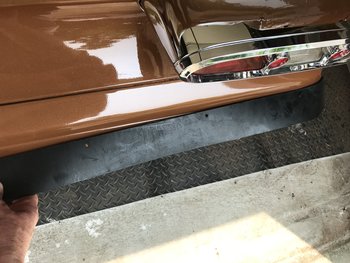

The hole alignment of this rear gravel shield from Gary Goers was perfect.
Came with push clips, too, although I resorted to using stainless hardware in the corners because the clips wouldn't stay, given the steep curve. (*sniff*...) I miss Gary!

You are welcome Dan, just dont forget my hamburger and frosty. I always use Eastwood silver argent on my valence, splashpan and wheels. I also recommend thier silver epoxy encapsulator for the inside of the bumpers but the black is good too.

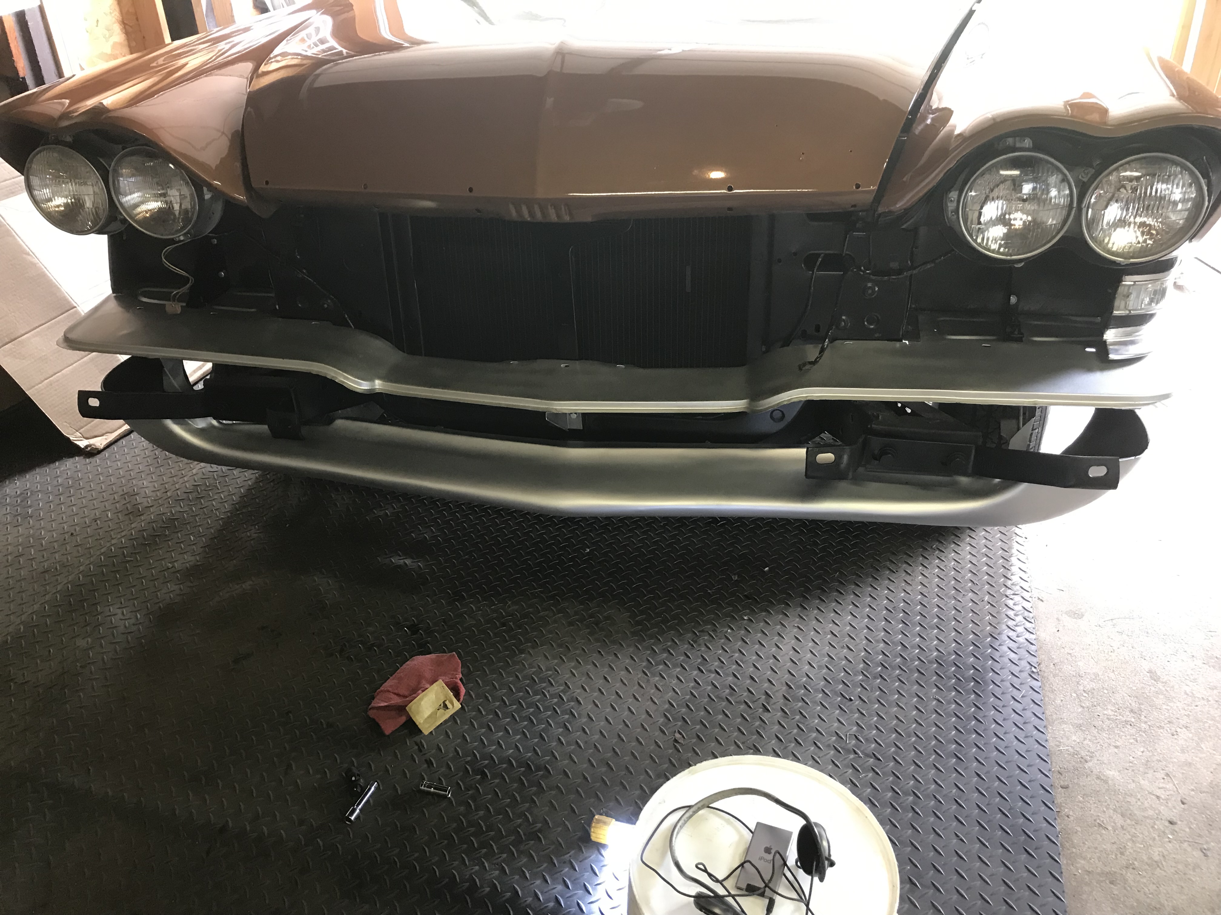

Some more nibbling away at the elephant...
The wheel argent I bought is pretty close to the paint Dick used on the splash pan, and I can't wait on an Eastwood order...
...so on it goes

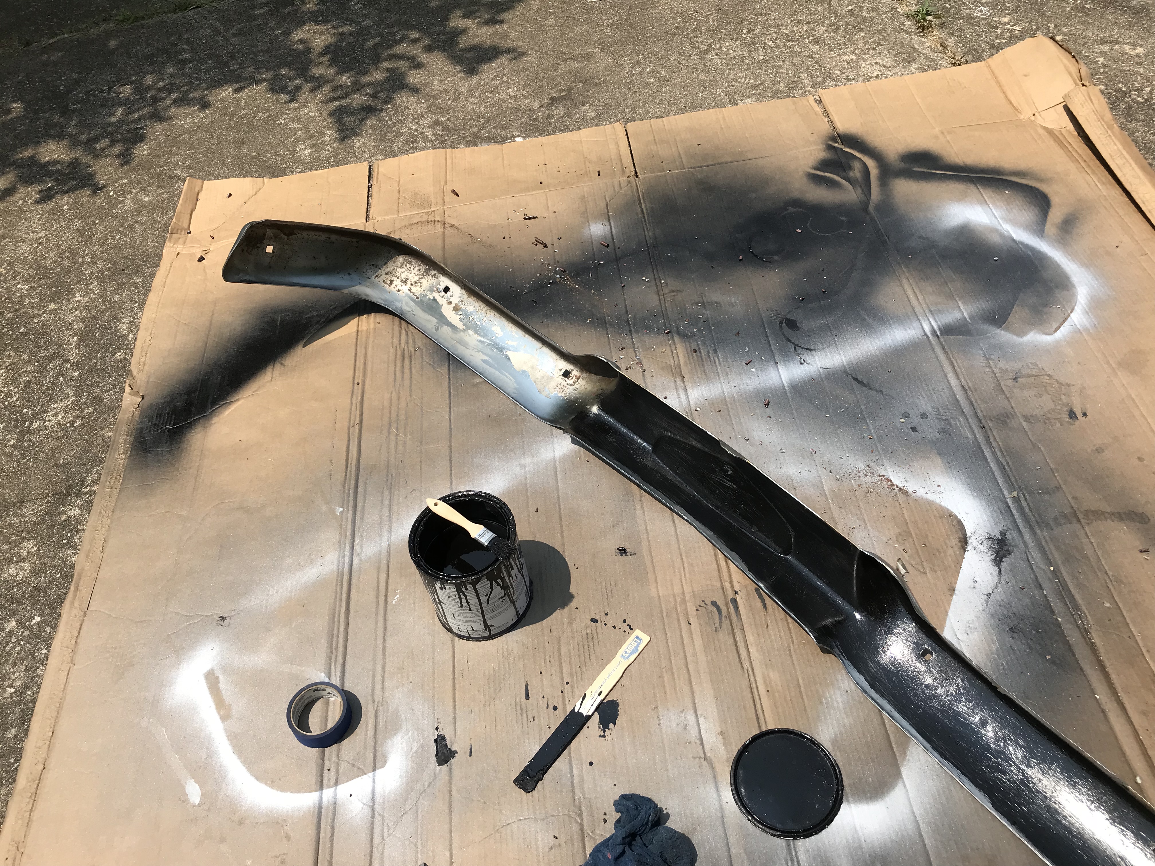

The front bumper, before I started. Because I always do everything Dick tells me to do, I brushed it...
...ospho'd it, and put rust encapsulator on it. I had to go with black, can't wait for Eastwood
...but a coat of hi-temp silver covered it nicely
The splash pan is on, and I've got two bolts in the valance - but I had to mow the lawn before the storm hits. And now, the old man is ready for his power nap

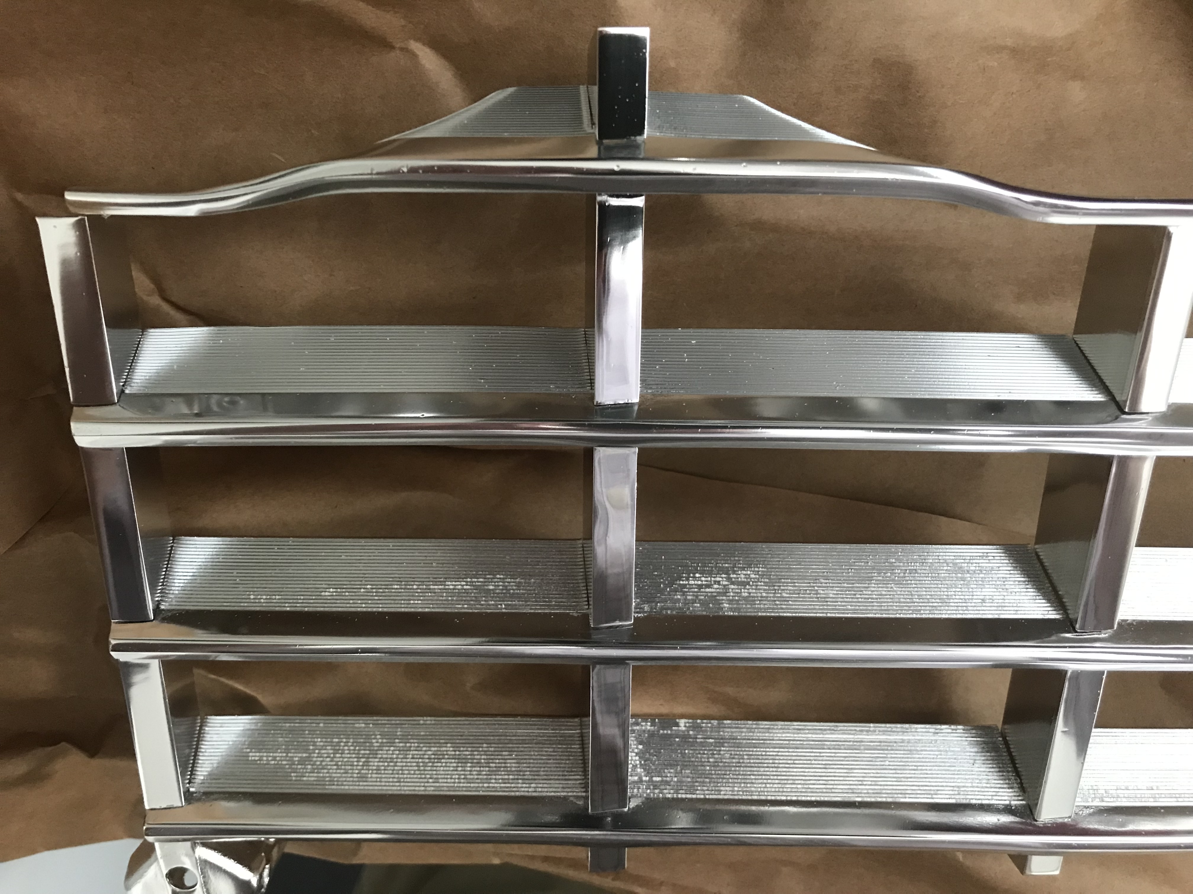

About reanodizing, I said:
Faulkner wrote:
Wed Apr 10, 2019 6:58 pm
Sometimes, you just gotta find a guy who knows what he's doing. Here's the same piece of headlight trim - after the company in Pottstown PA treated it, and McNichols in Michigan treated it. It's a miracle! I'll be sending the piece I got from Ed Ober next.
Well, the grille piece I got from Ed came back. It's not perfect; but then, neither is Faulkner :? So this will have to do.

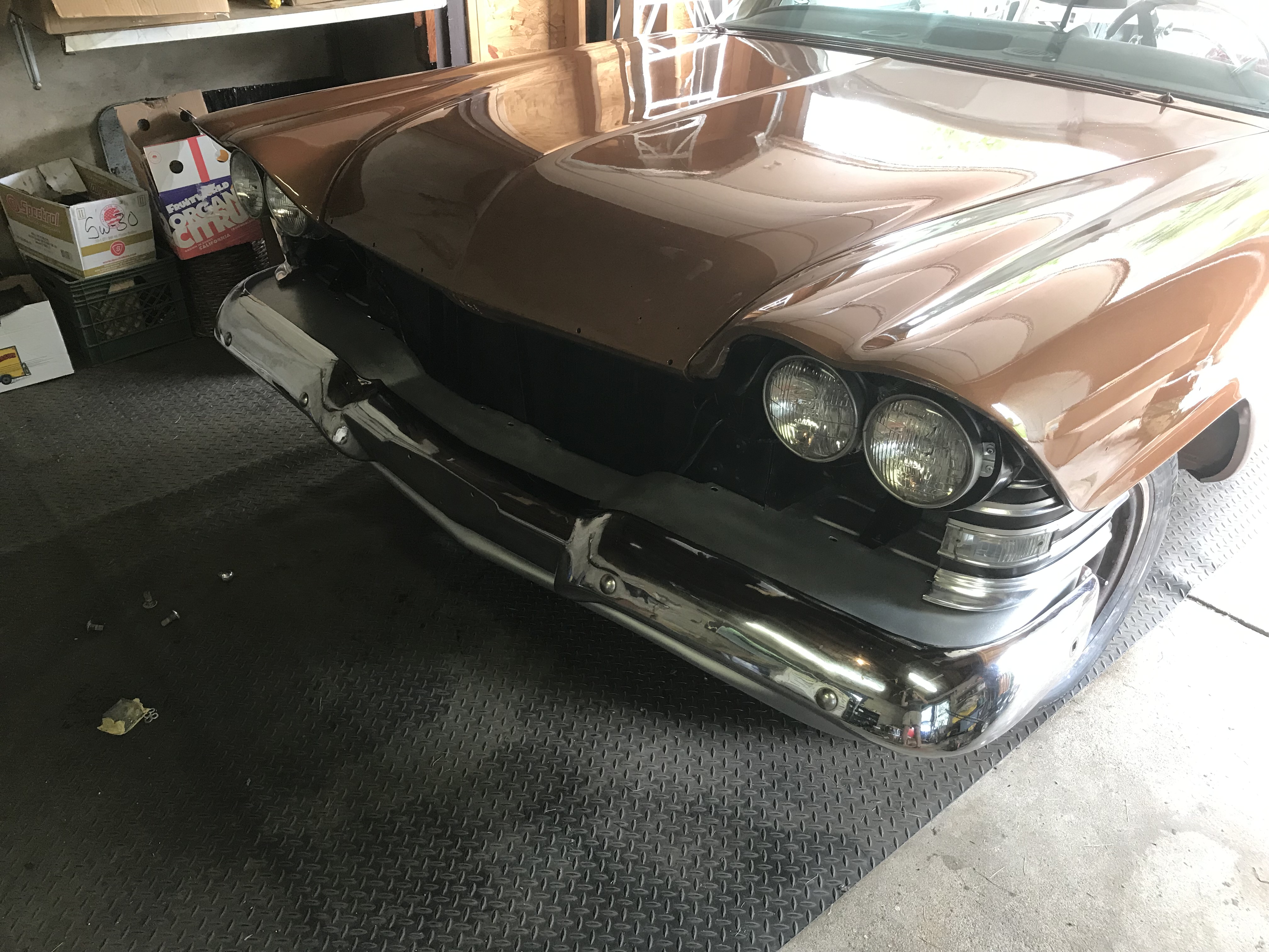

I took the day off, and got Faulkner roadworthy:
Nice work on the valance, Mr. Koch!
The front bumper, never replaced, is showing its age - but, still holding up. Notice the outer bolts are left off for the soon-to-be-mounted bumper wings
The headlights are still not working, but I wanted to get the car to the paint shop for some minor fixups today, so I can paint the interior tomorrow. I'll get the headlights sorted out on the flip side.

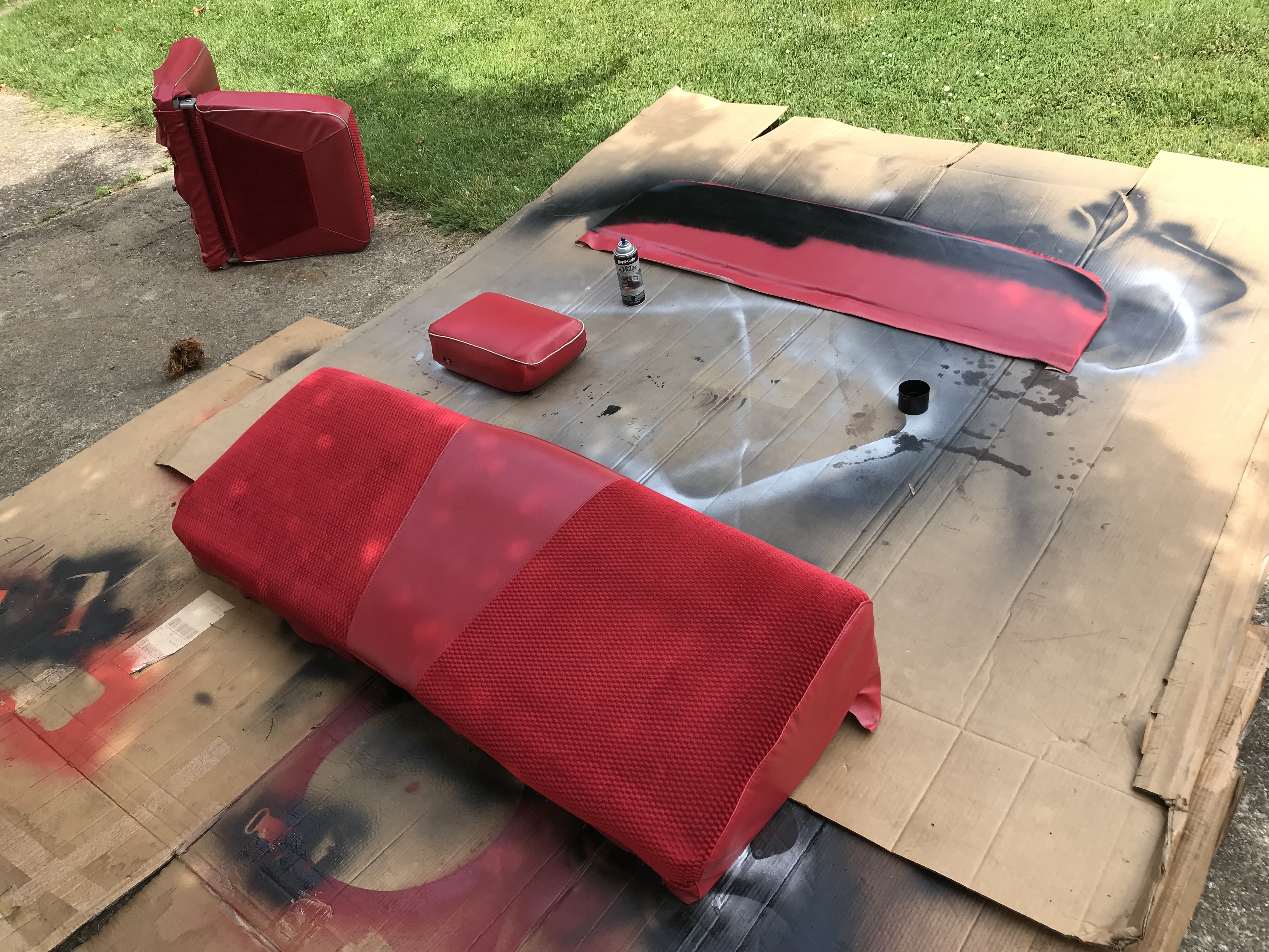

I love this vinyl/fabric spray paint from Dupli-Color. It dries super-fast and colors the vinyl perfectly; but wow, the tufted fabric really soaked it up. I went through 6 cans painting the package shelf, the console armrest, and the two pieces of the back seat. Time to order a bunch more cans.
Just getting started
This is the paint
lower rear seat came out nice - but still could use another coat
The upholsterer had saved the seat buckles when he redid Faulkner's upholstery, but never put a belt between them. I taped the buckles and turned them so I could paint underneath them
