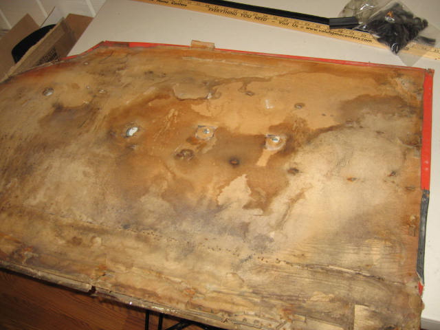

Dan - l used dynamat, supposedly the best in the doors of charleen. After six months or so it started to sag and fell off. Gummed up the works so l took it out.

Dick; The tools and garage dirt are there just not in the photo. It is nice out there, it is my pole barn. Tv, phone, heat, YUENGLING, etc.etc.etc. Dan, I am not going to do the door skins. They still have a lot of factory tar spray on them and is better probably left alone. That is also why I didn't do up over the hump/trunk area under the back seat. Man is that stuff thick and hard to get off.I cleaned the floor and gave it another coat of paint(waited A week or so to get plenty dry) to give it A good clean surface to stick to, I also took A razor knife and slit the foil on areas that are impressioned. I was getting air bubbles that are hard to get out when rolled with my small rubber roller. It fit the contours better. I will also do the trunk bottom surface as well. I'm going after more of sound deadness than insulate. It Should make the car feel tighter. Still got A ways to go but it will be A long winter as well. Thanks Mark

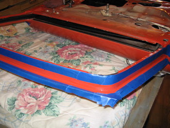

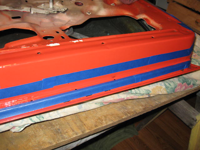

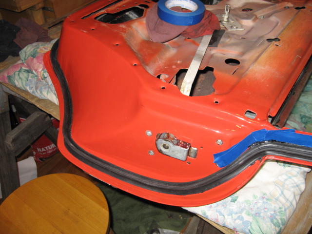

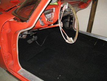

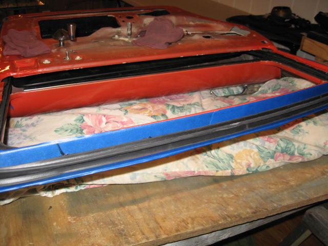

Well there's the whistle, breaks over !! Would be alot better retired but that is another 1 1/2 away and another story.Made A stab at weather strip and got the carpet and back seat in.Turned out well. I used tacky spray (chooch cab assembley) to bond the pad down, then made A few cut's and hole locations and that was it. Sms could have gave me A little more, would have been nice but looks good. I got some better sill plates from A part source coming, mine are very dinged. Many many many dings. I think some woman tapped her high heels everytime she got in to shed the Vegas sand or something.I put my plates on for now.The weather strip came out good as well, I masked it first and did the glueing about A foot or so at A time, putting glue on both surfaces and tried not to get glue on the tape. Then let it set till the next day and then peel off the tape, ( keep A razor blade handy) and re-mask the top edges. Then with my steel 6"scale ruler I pry the flap open and re-apply another small bead of glue keeping it moving with the glue tip (slightly flattened) right behind it.Just like decorating A cake. It looks right, and the one thing and first thing that I learned about doing cars (and I am sure you all became aware of this right off the bat) THEY DON'T COME WITH "HERE IS HOW TO DO IT INSTRUCTIONS". Speaking of how to do something, I am going right now, TO EAT TURKEY!!! To all. HAVE A HAPPY THANKSGIVING !!!!!!!!!!!!!!!!!!!!!!!!!!!! Mark P.S. Also shots of my old and new door panels. They took about A year. The back of the old one has May the 8th date I found on the inside, which confirms what I thought, I have A late 59 I think it was built in June.

Lookin' fine, Mark! What adhesive did you use for the weatherstripping?
