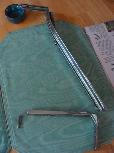

Man! There's a hundred parts to these windows! The rubber is in great shape, and I was able to take apart everything without any breakage. Except, for what's already broken:
So, here's the million dollar question: Should I try to get the chrome-plated pot metal soldered, or should I look for another piece? The chrome on this is in really good shape....
Does anyone know of a good solder shop that can do this kind of work?
Does anyone have a driver's side frame in good shape they would consider selling?

I too am looking Forward to any sensible replies to your post, Dan. I just had my cvt canvas installed, but due to window alignment problems and weatherstrip that was maybe too fat?, ...a few dozen closes of the drivers door has caused my drivers side vent window frame to break at the top. I will be researching ways to weld/braze/solder this frame. It is a convertible-only frame...very hard to find a replacement.
San, you should be able to find another hardtop frame...any sort of welding/brazing/etc will ruin your existing chrome plate.
