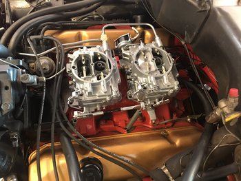

Recently I bought 2 original 58 Plymouth dual quad carbs on eBay and Frank knew somebody who could rebuild them. Decided to pick them up instead of shipping.

My carbs were waiting at Franks house and they look like new!

The correct dual quad afb carbs

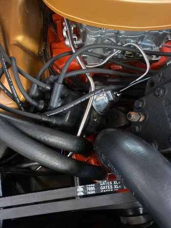

Found out my T fitting on the carb was leaking so I ordered a new one too. Hope to get a big package with new parts soon :mrgreen:

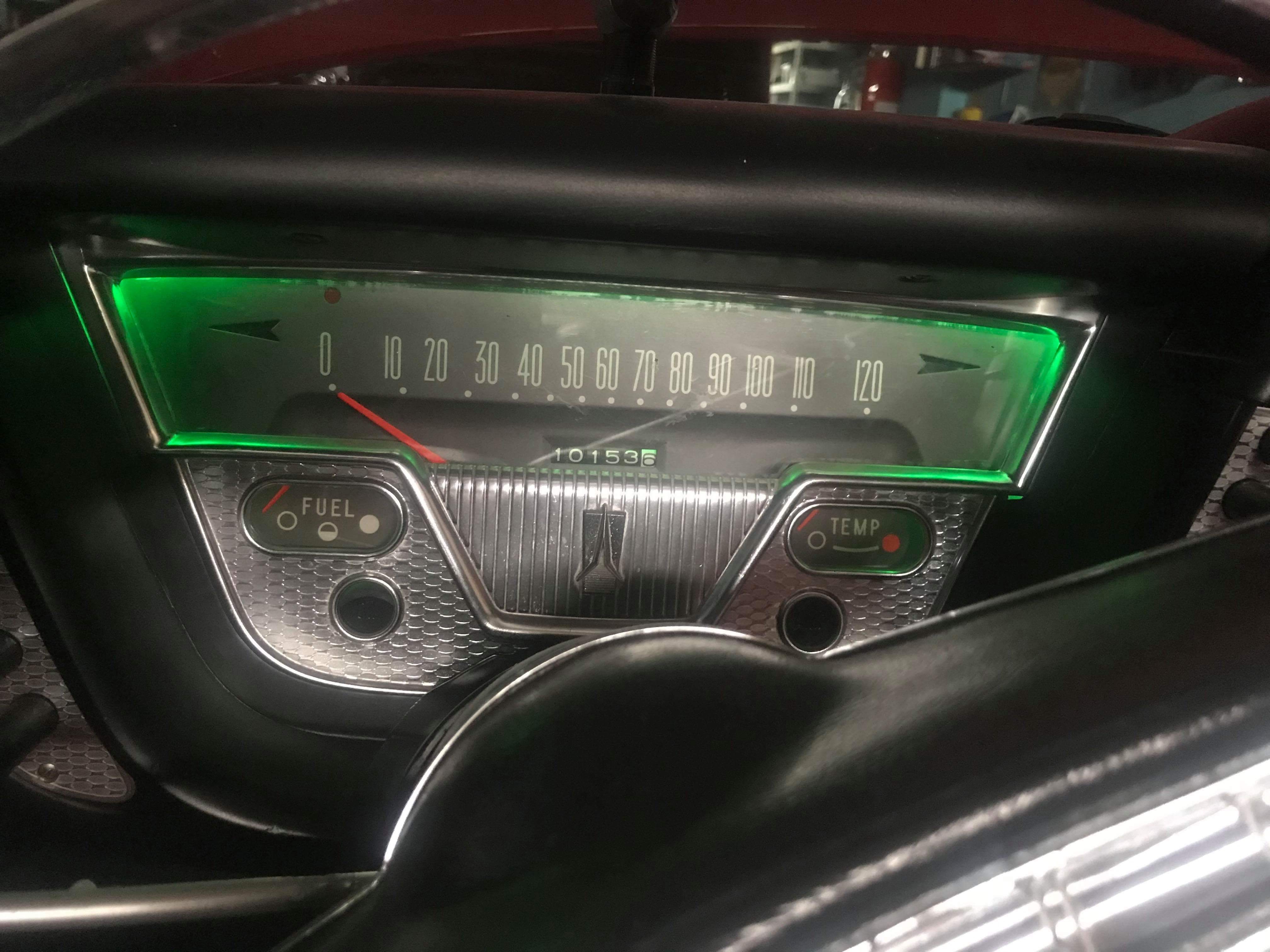

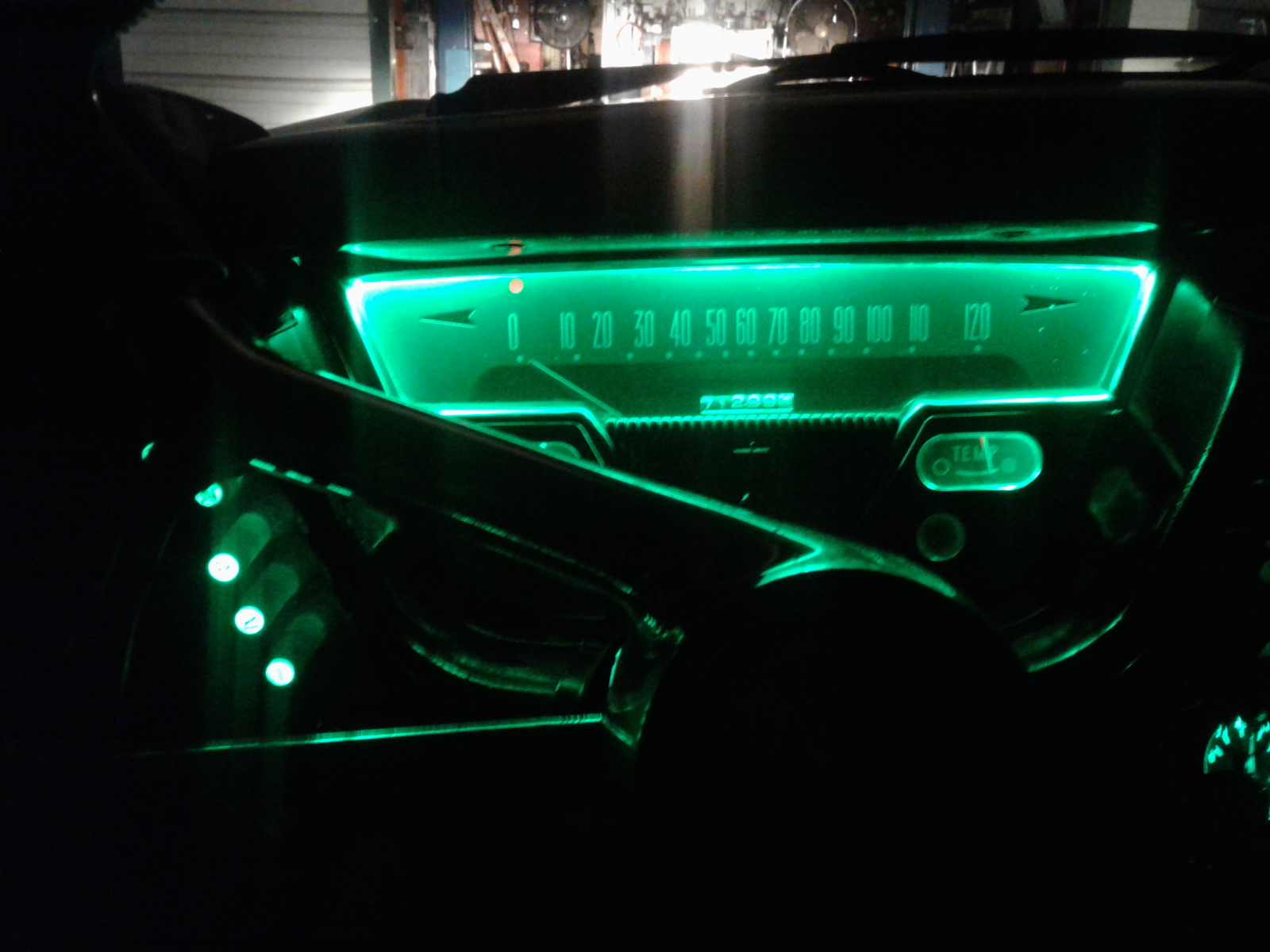

Just because it's quiet around here... A pic Matthew sent me, of his dash lit up with green LEDs. He's gonna give me some for Faulkner!

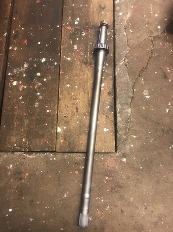

Well, I guess it’s time for some updates over here.
I had the axles shortened and they look great. Took some pics but they are on my old phone.

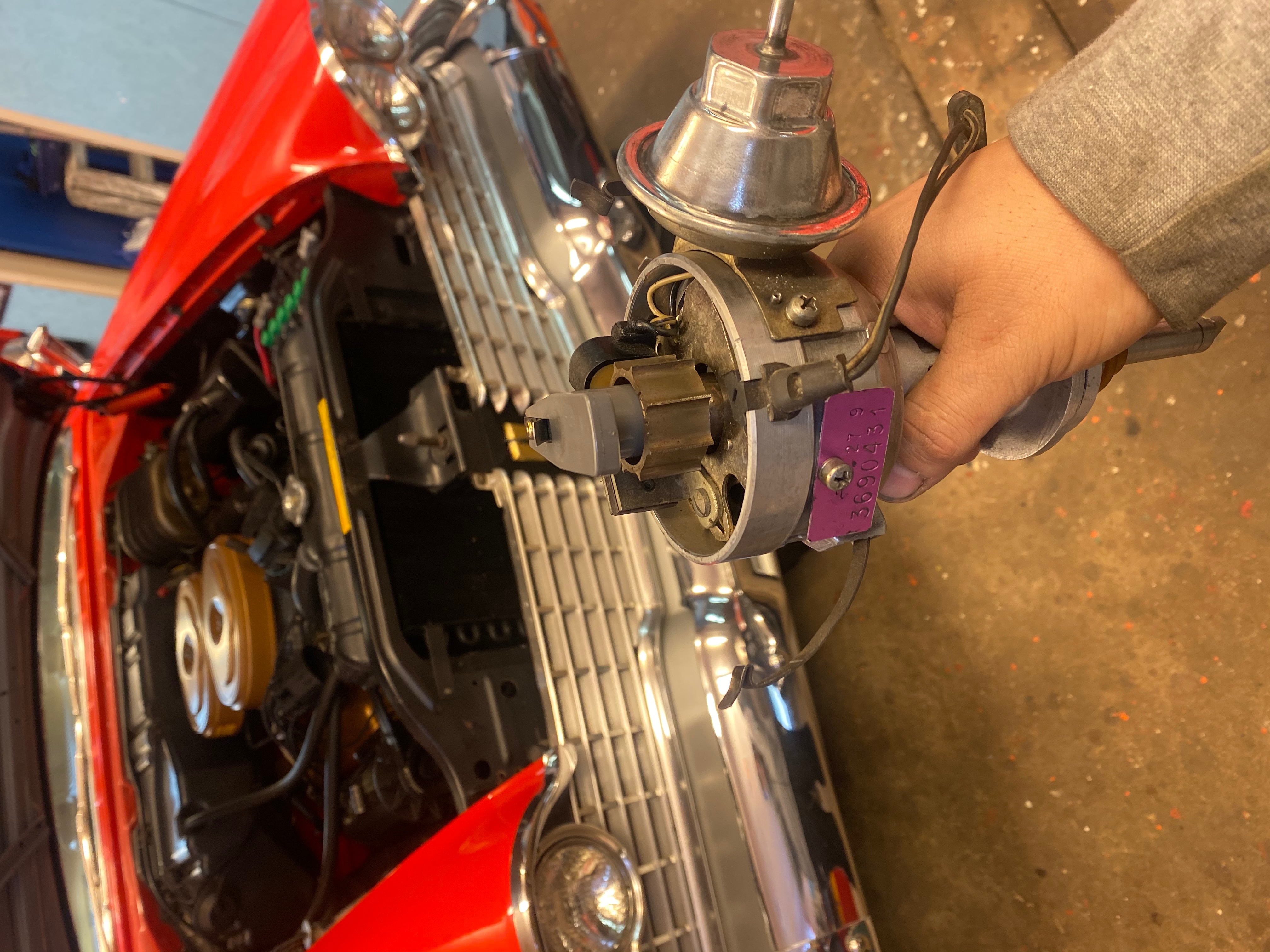

Still had some issues with the car and it wasn’t running right. Finally figured out that the distributor was the one to blame.

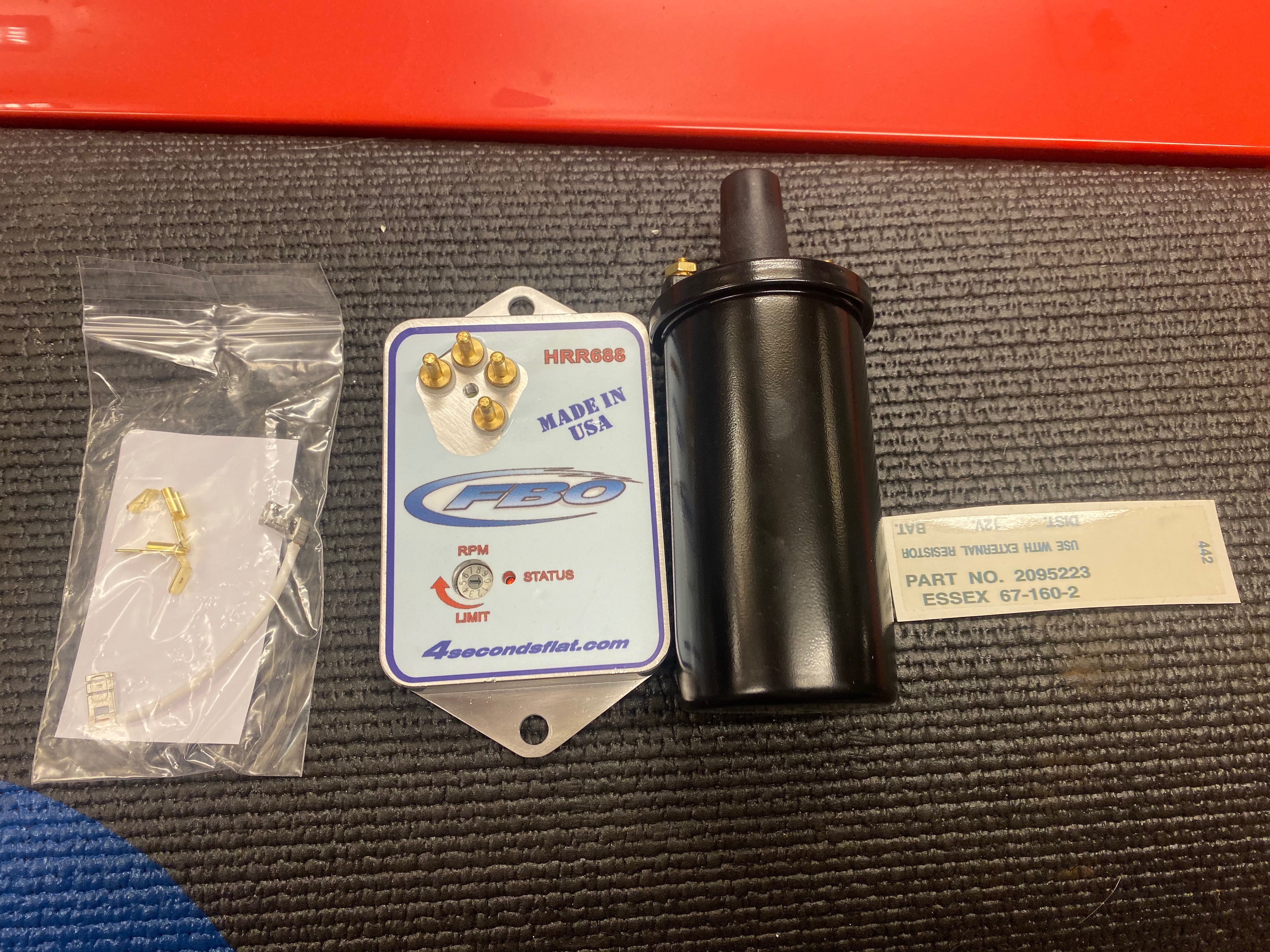

Got a new electronic ignition kit from FBO with the vacuum advance limiter plate. That’s installed and I just dropped the rebuild distributor back in.
New kit has an ECU, ballast resistor jumper, coil and the limiter plate.
When I took my old distributor apart for the springs I found out 1 wasn’t too good so I ordered new ones.
Finished the rebuild of the mopar performance distributor and hopefully it’ll fire up tomorrow after I finish some small stuff.

Posts: 4049
Re: The Convertible
Post by Faulkner » Sat Oct 19, 2019 9:56 pm
Ignition stuff looks sweet, Matthew. Hey! Isn't that the turn signal lens I need?!? :roll: 8)
